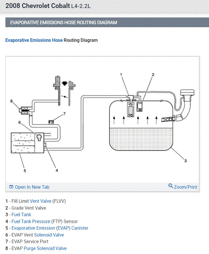

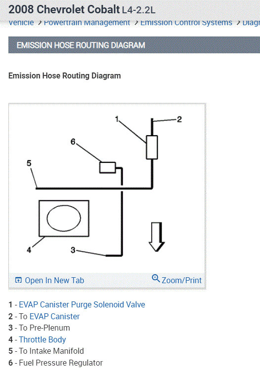

Got the car started and drove it a bit. Noticed the idle was high and went to AutoZone said to check the vacuum lines. Do you have a diagram of the vacuum lines on the 2.2 LS Coupe Cobalt Manual transmission?

The pics below are what I have as far as vacuum schematics. By chance, do you have a live data scan tool? If you do, let me know what the short-term fuel trims are. I should be able to tell if there is a vacuum leak.
Also, here is a link you may find helpful. It explains how to check for a vacuum leak.
Here is a link that explains how to repair a high idle:
https://www.2carpros.com/articles/engine-idles-too-high
Let me know if that helps or if you have other questions.
