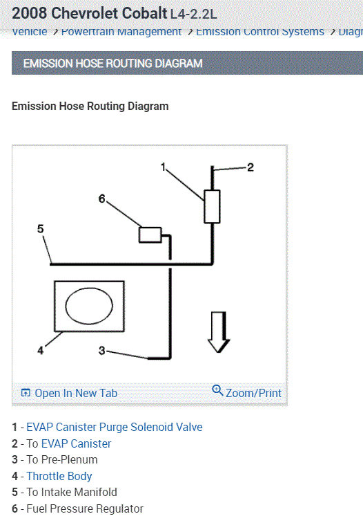

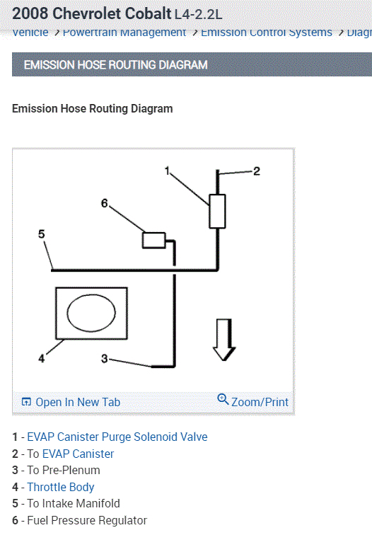

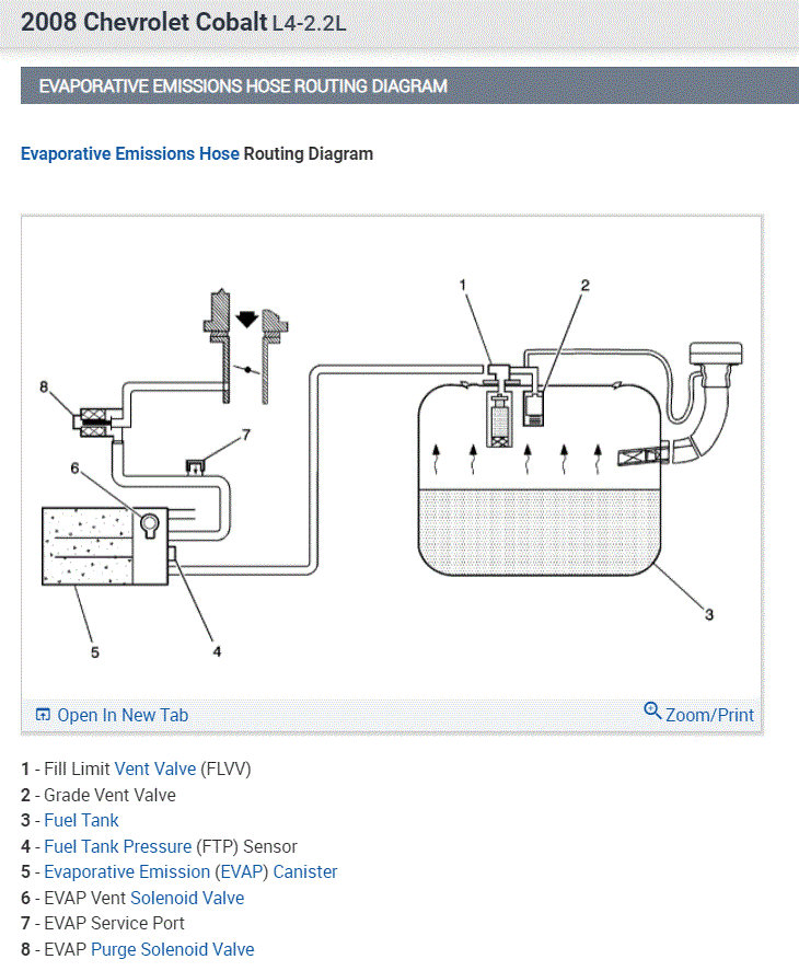

Got the car started and drove it a bit. Noticed the idle was high and went to AutoZone said to check the vacuum lines. Do you have a diagram of the vacuum lines on the 2.2 LS Coupe Cobalt Manual transmission?
Nov 24, 2021 at 1:11 AM
  • 110,241 POSTS
The pics below are what I have as far as vacuum schematics. By chance, do you have a live data scan tool? If you do, let me know what the short-term fuel trims are. I should be able to tell if there is a vacuum leak.
