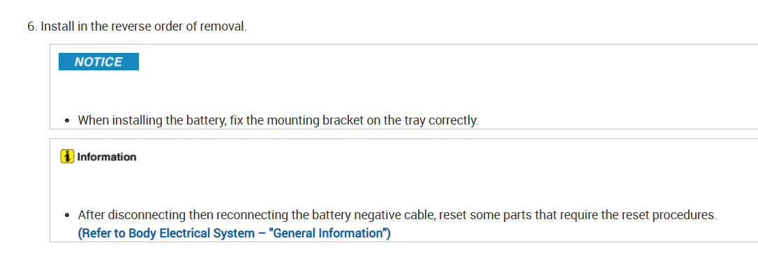

Never leave electronics on in car everything off but tested battery next day after car sat overnight and was half charged at 12v ran it a few seconds then it was 14v while car running then 12.6 right after shut engine off. Is the normal.
Feb 2, 2025 at 12:12 AM
  • 55,423 POSTS

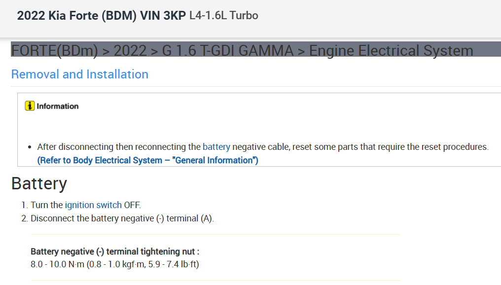

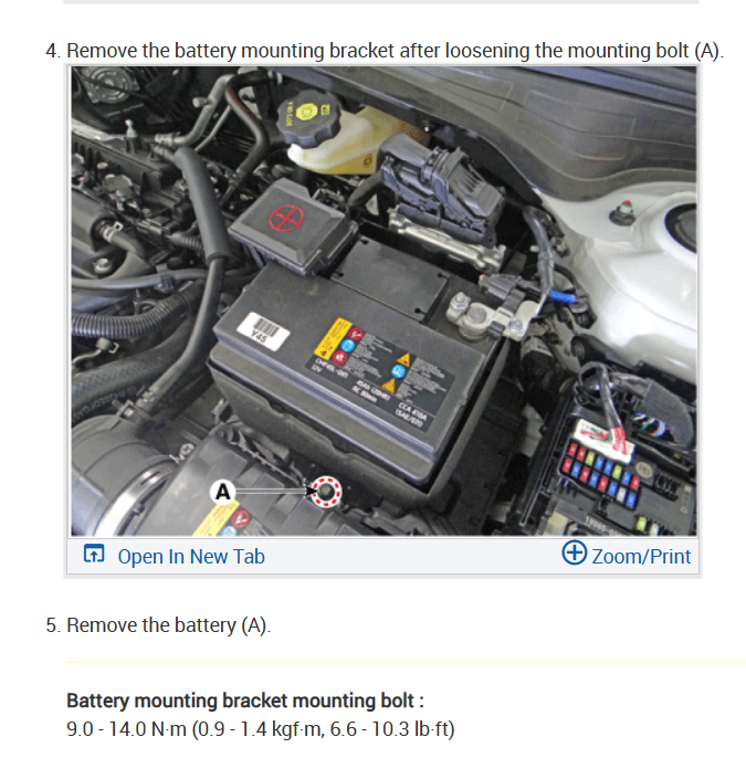

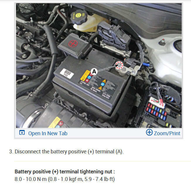

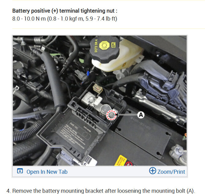

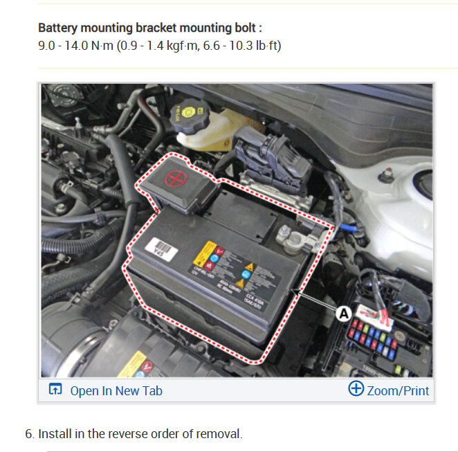

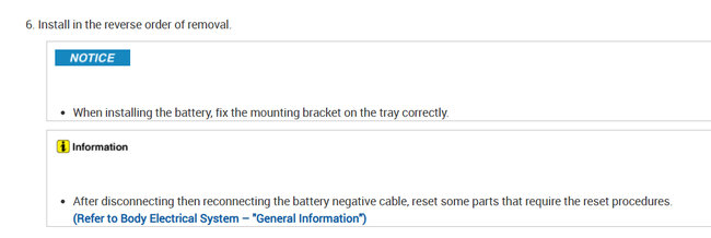

It sounds like the battery is bad, I would remove it and get a new one to install, this guide will help walk you through the steps with instructions in the images below to show you how on your car.
https://www.2carpros.com/articles/how-to-replace-a-car-battery
Since this is a newer car, you may need to do a battery monitor reset, this video will show you how:
https://www.youtube.com/watch?v=ETNv2S_idIU
