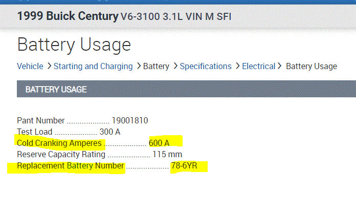

What size battery does my car need?
180,000 MILES
BILL23232323
what size do i buy?
Dec 28, 2020 at 1:27 PM
  • 110,248 POSTS
If you look at the attached pic, it shows the specifications for the battery the vehicle came with. It is a group size 78. It will have side terminals as well.
If you contact a parts store with the year make and model of the vehicle, they will be able to set you up. Actually, many of them will install it for you free of charge.
Note: The specs below show cold-cranking amps equal to 600. That is a minimum. It's like money in the bank. The more the better. LOL
