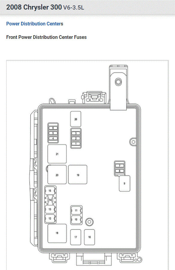

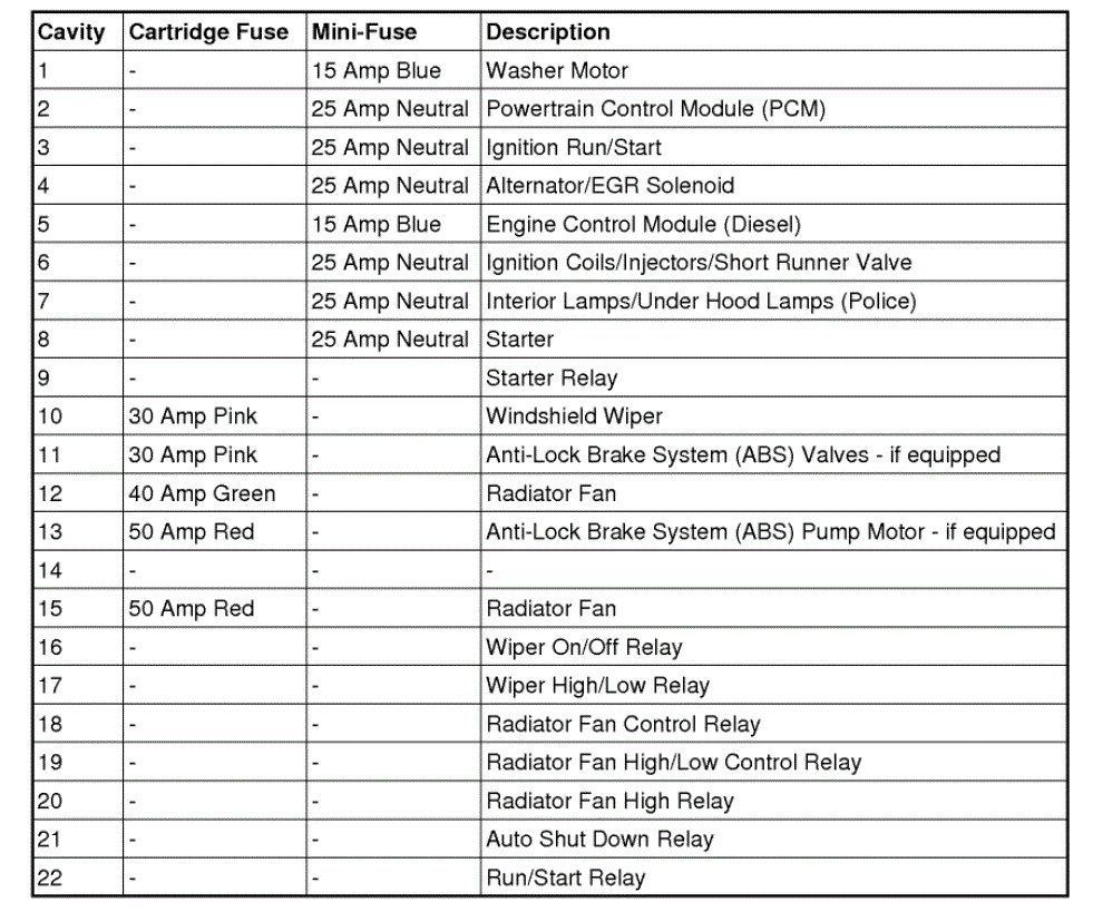

something is causing my headlights not to work where are the fuses?
2008 CHRYSLER 300
117,000 MILES • 6 CYL • 2WD • AUTOMATIC
ERRICK LASHON RICHARDSON
When my car sits for a day or so something is causing my headlights not to work where are the fuses?
Jul 13, 2019 at 10:04 AM
  • 110,194 POSTS

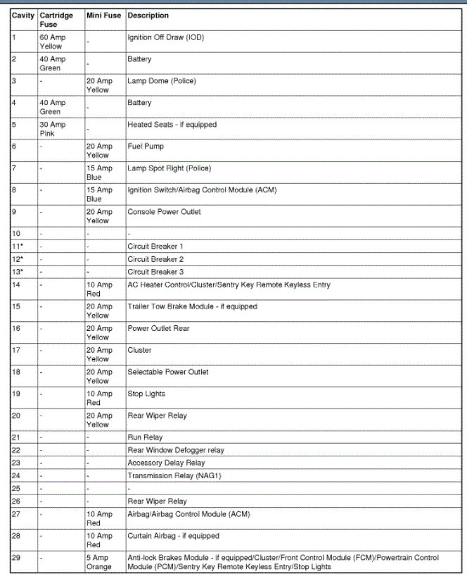

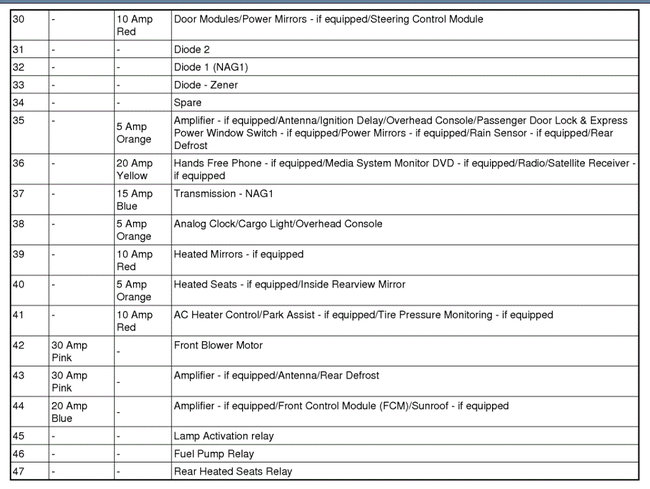

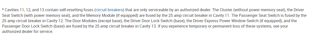

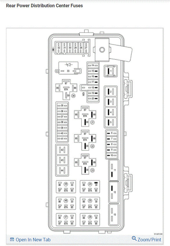

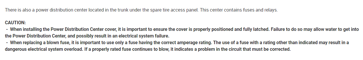

If you look at the pics below, I attached all the fuse panels, the fuse requirements, and what each fuse is used for.
When you check a fuse, in addition to checking the fuse itself, make sure there is power both to it and from it. Here is a link you may find helpful:
Let me know if this helps. Also, if possible, let me know a bit more information about the headlamps not working, what happens, for how long, and is there anything that causes them to start working again.
