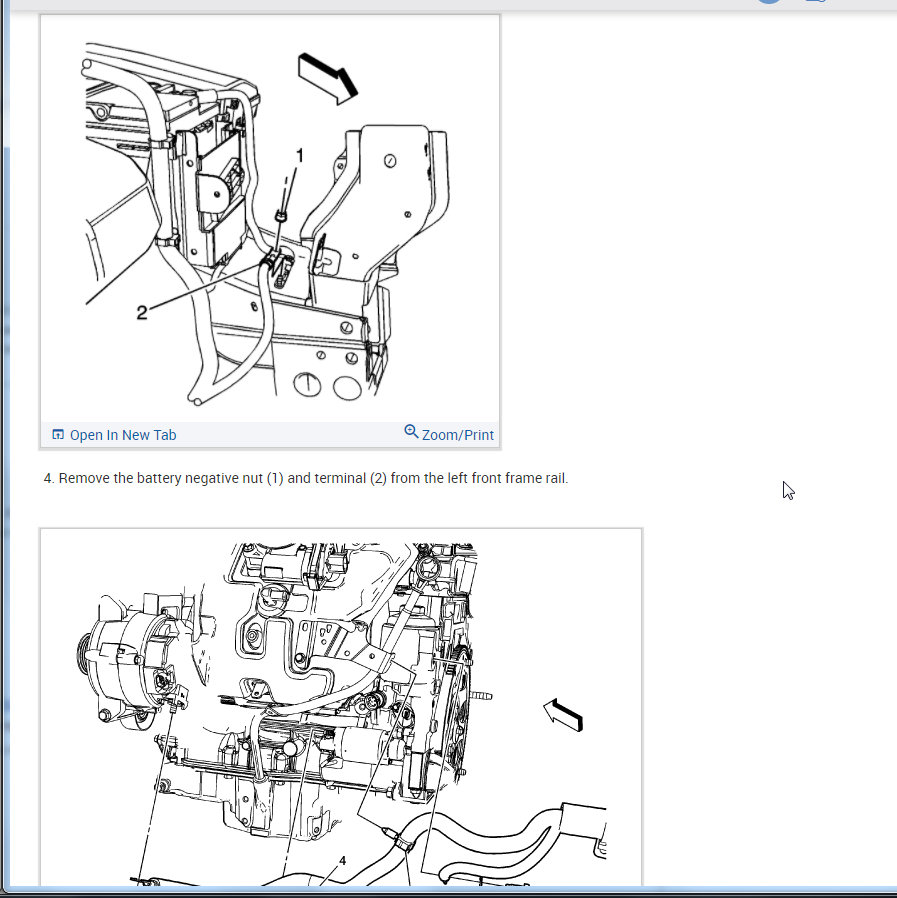

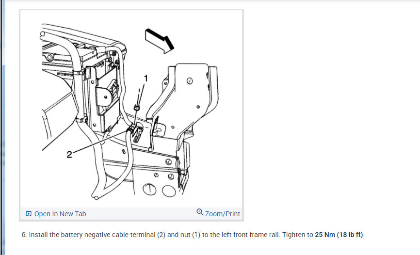

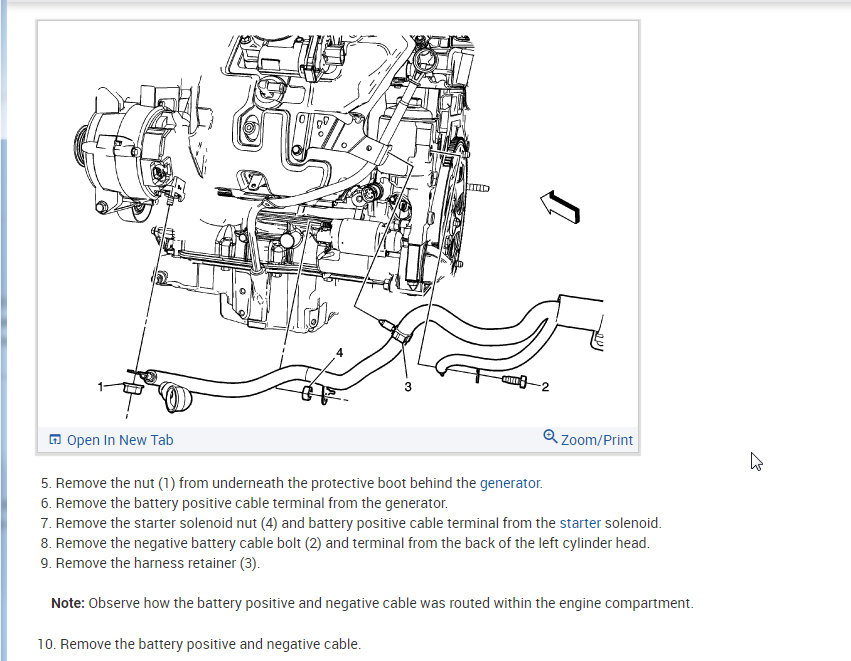

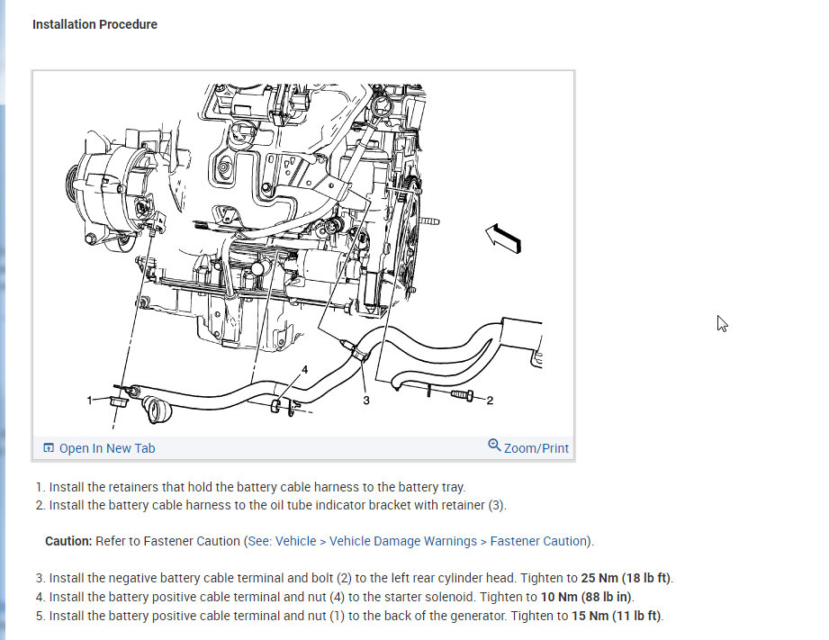

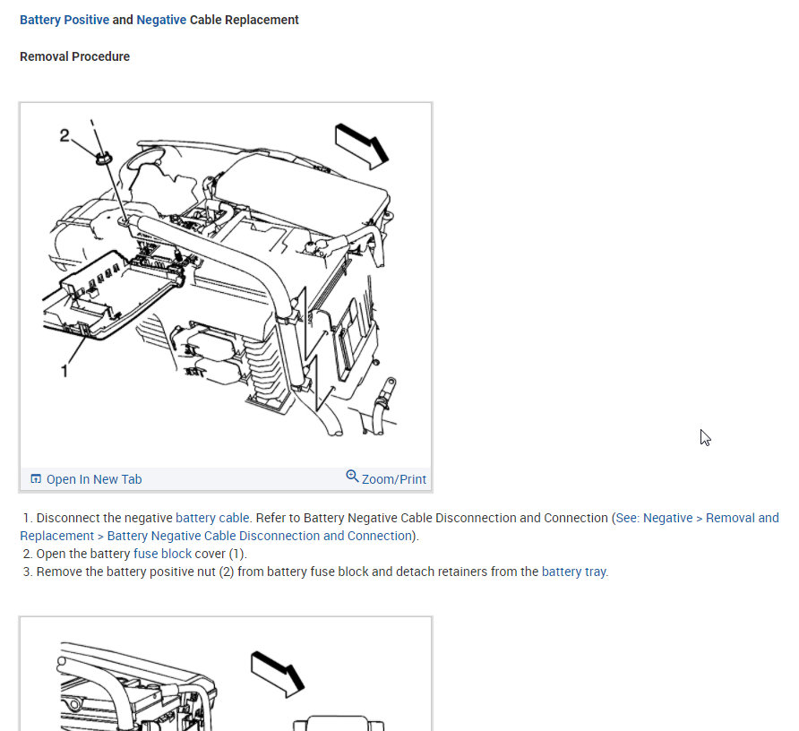

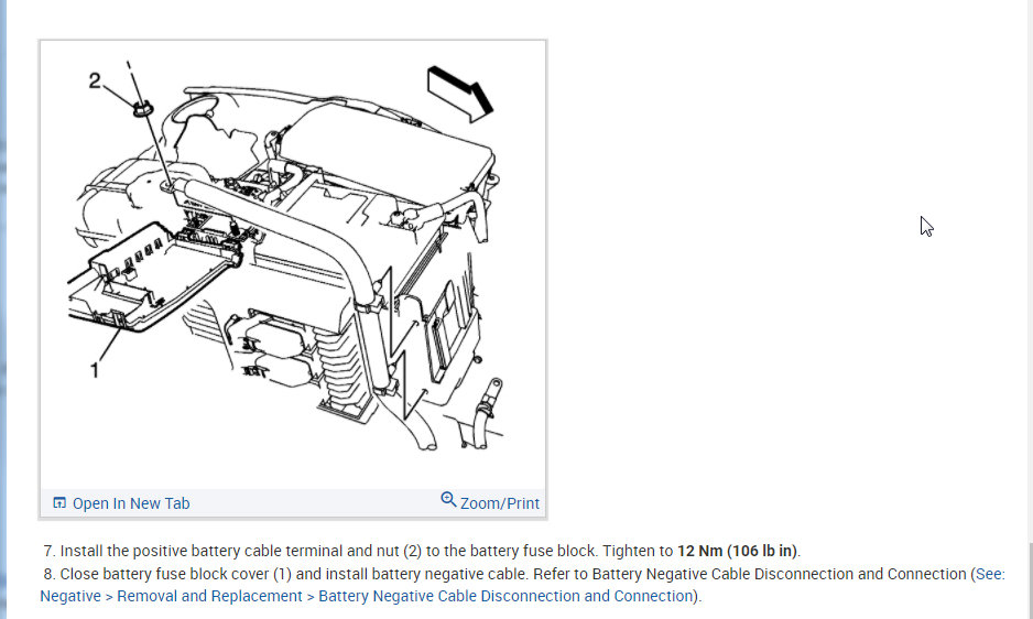

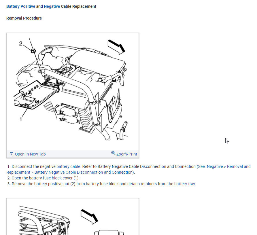

I do not remember which two hookups to put the red wires on one of the cables. I do not remember which positive or negative. One of them has two red wires on it and there is five places to hook them.
Thursday, May 24th, 2018 AT 3:03 PM

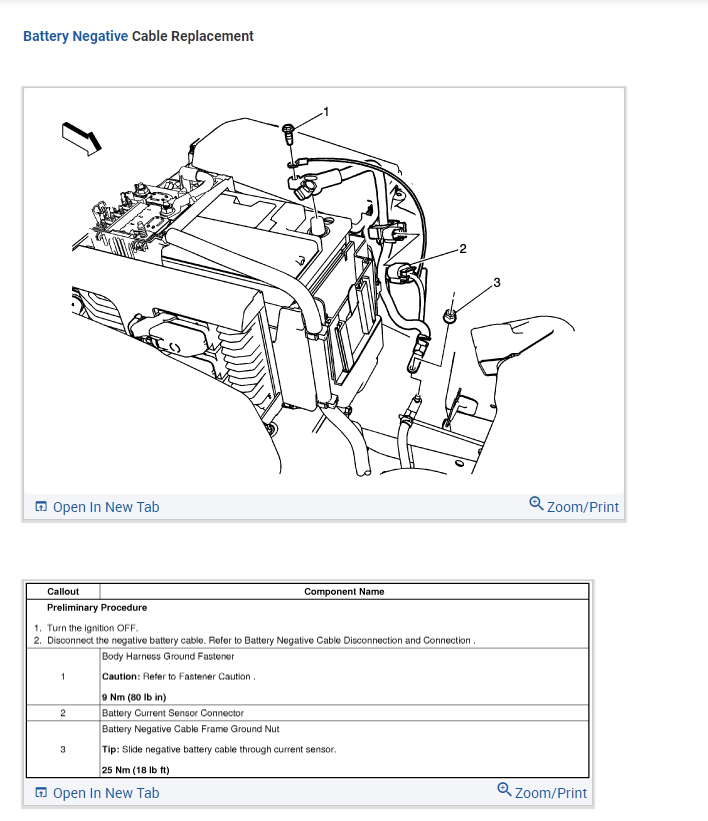

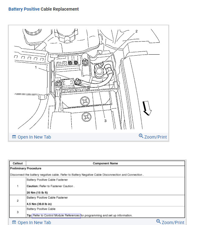

Normally the red cables go to positive but I am attaching the process from the manual that will explain how to replace the cables. Please see below for these attachments.
Here is just a general guide on how to replace a battery in case that helps you or others that visit this page:
