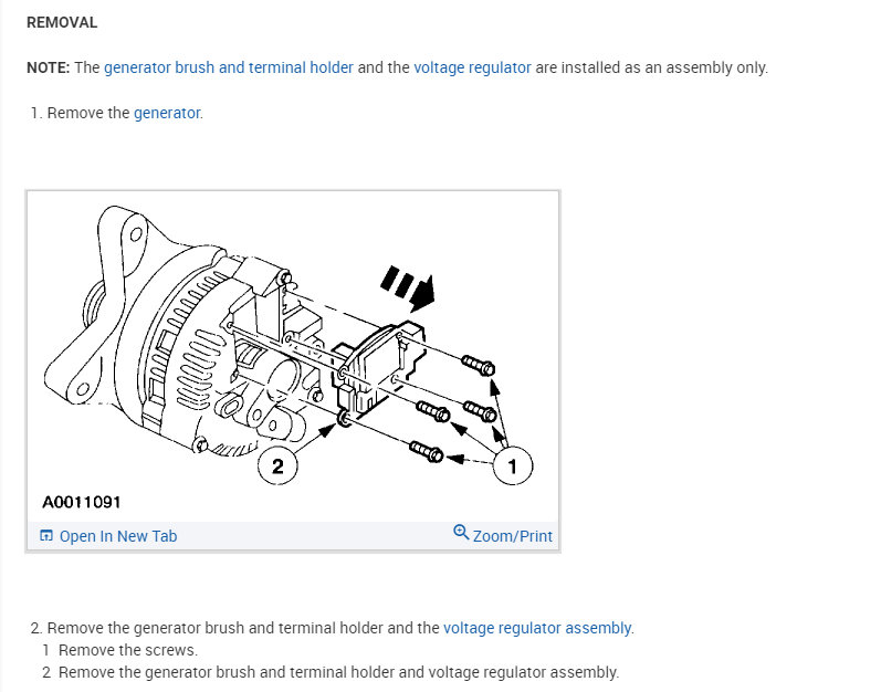

When you changed the alternator, did it come with a new regulator or did you have to swap it over? They are removable so if you have to swap it over then we need to replace that to start.
