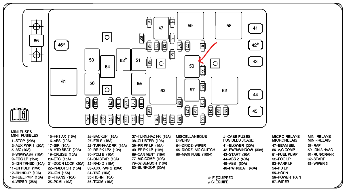

I hit a deer on passenger side i fixed all of that now something keeps draining the battery.
Oct 23, 2023 at 8:48 AM
✓Experienced Mechanic
55,399 POSTS
It is common for the A/C clutch relay to stick on and drain the battery, I would remove the relay to see if the drain stops. Please check out this guide as well:
