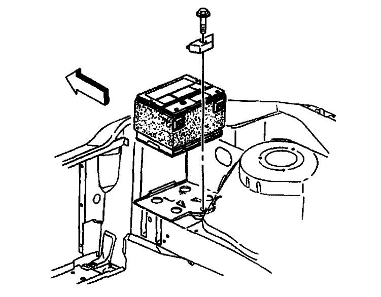

What battery goes in the vehicle listed above CXL model?
Jul 9, 2020 at 5:16 AM
Good afternoon,
The van takes a group 78 with 800 CCA. Any parts store will carry this battery.

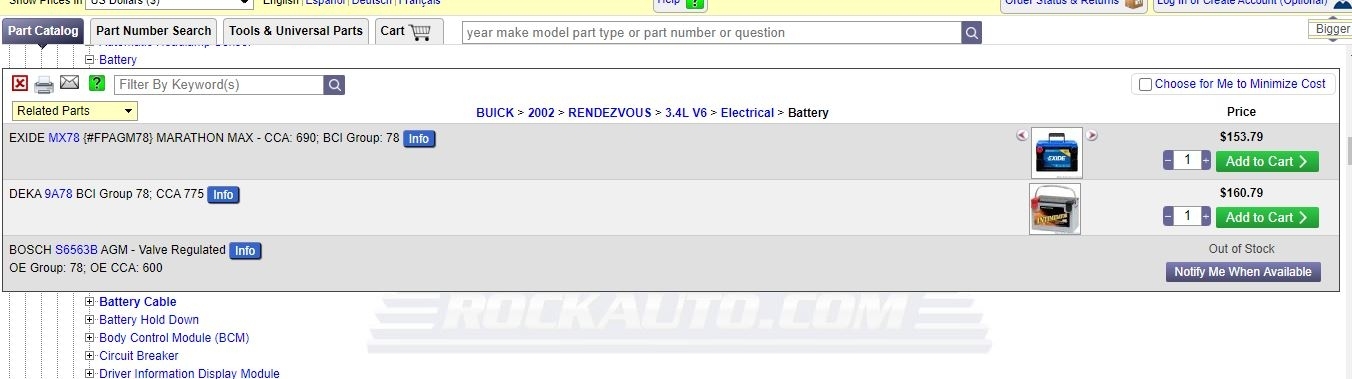

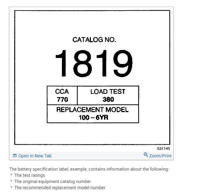

Looks like this is a group 78 battery and the factory rating is 770 cold cranking amps. You can go larger with the CCA but I would try to go smaller unless you live a warm climate year round.
I attached a parts website but any parts store would carry these batteries.
https://www.rockauto.com/en/catalog/buick,2002,rendezvous,3.4l+v6,1377109,electrical,battery,2476
Let me know if you have questions. Thanks
