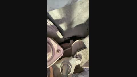

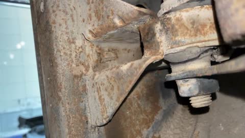

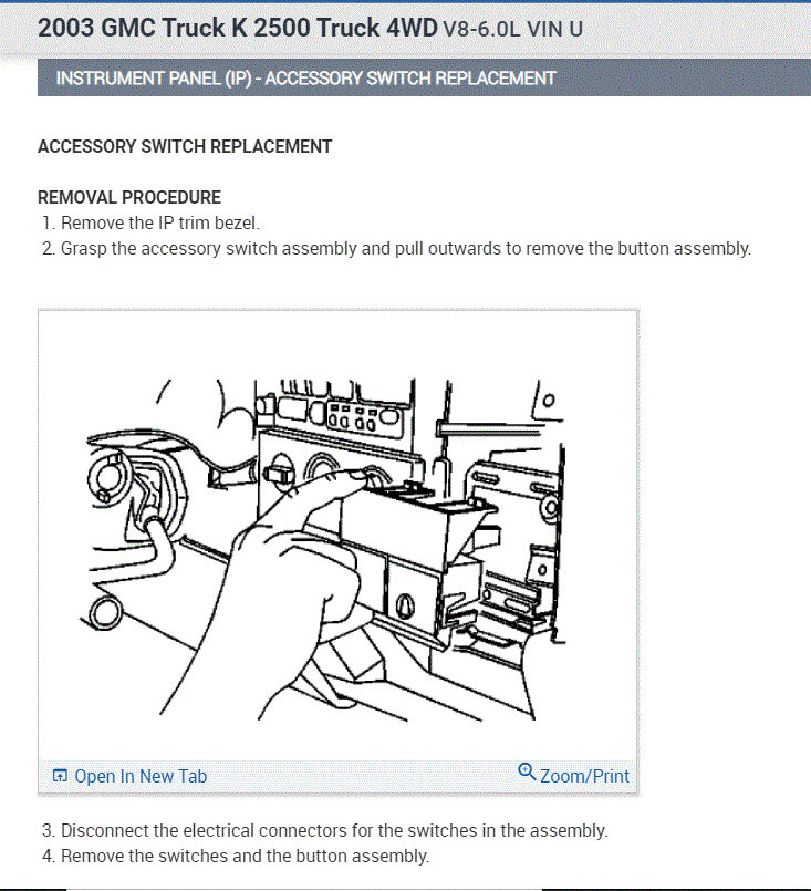

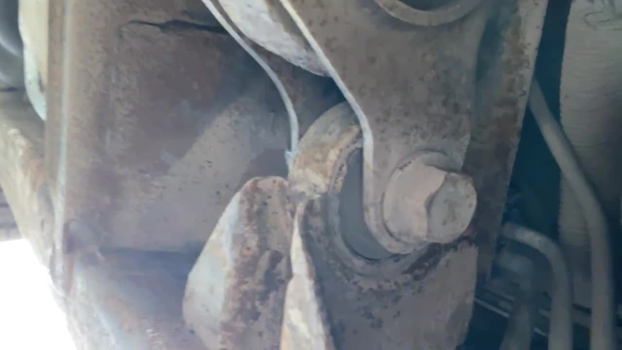

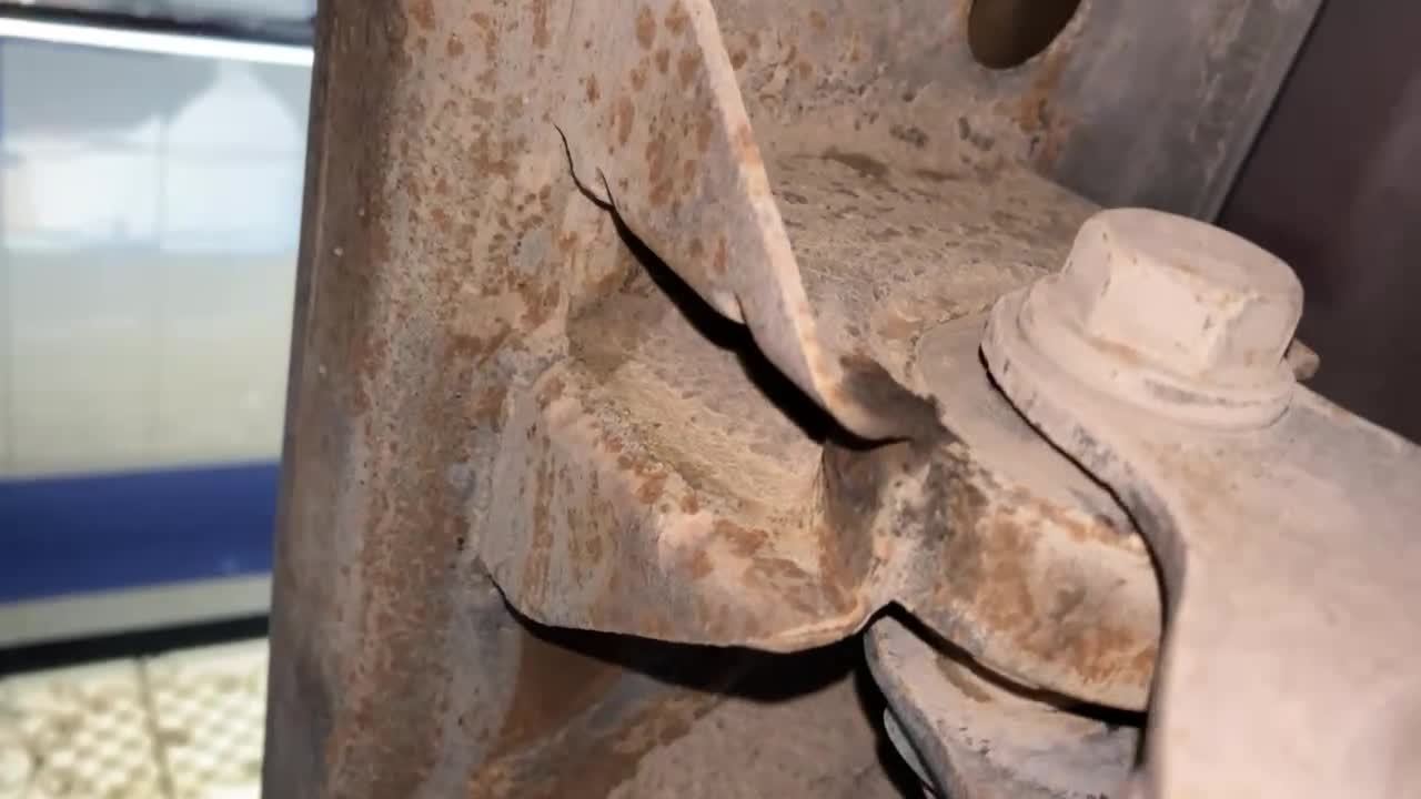

The leather of the base that holds two screws with which to raise the car and lower it is ruined. I want to replace it and I do not know how to change it?
Feb 4, 2022 at 4:52 PM
  • 110,194 POSTS

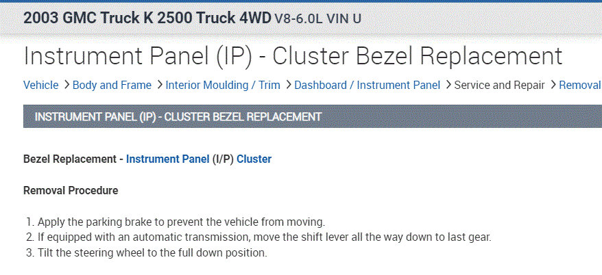

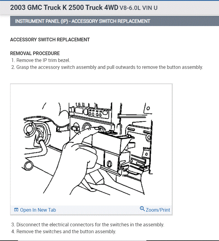

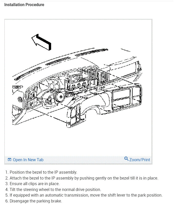

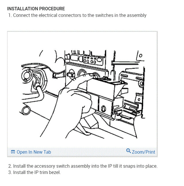

Are you referring to the bezel or the height switch itself? I attached directions below for the removal and replacement of the trim panel. It is clipped into place.
If I have the wrong part, let me know. If you can take a picture of what you are referring to, it will help.
Also, the last two pics are the directions for the removal of the accessory switch bezel.

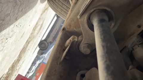

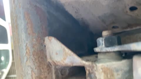

KALED8A8

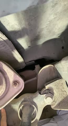

These videos are for the problem I am experiencing. I want the part number so I can buy it because I asked the spare parts stores and they did not know it, and also I do not know how to extract it and replace it with the new one.

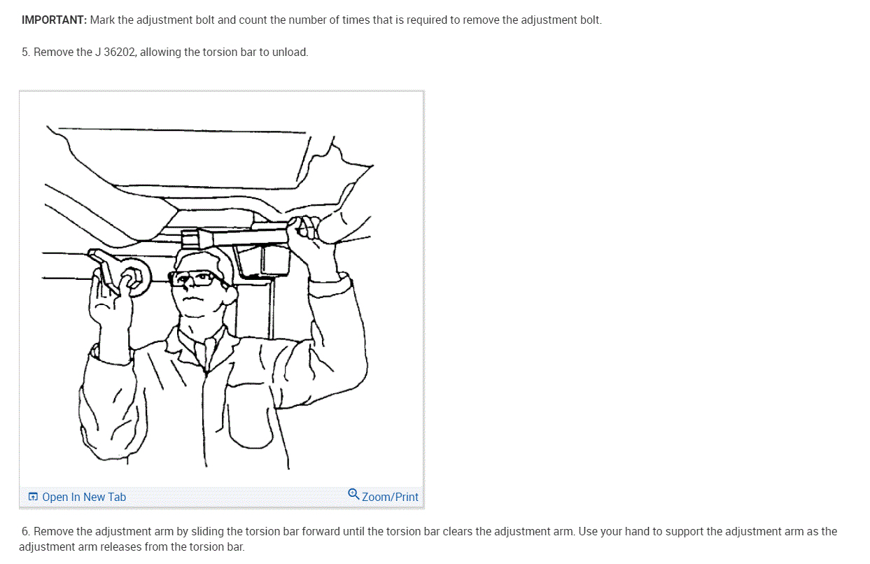

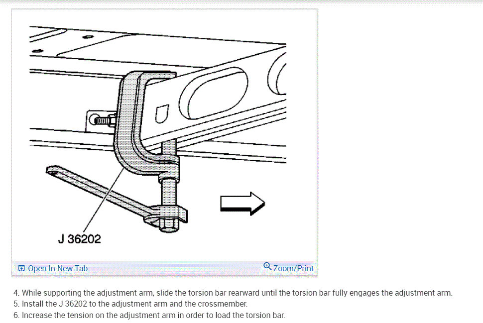

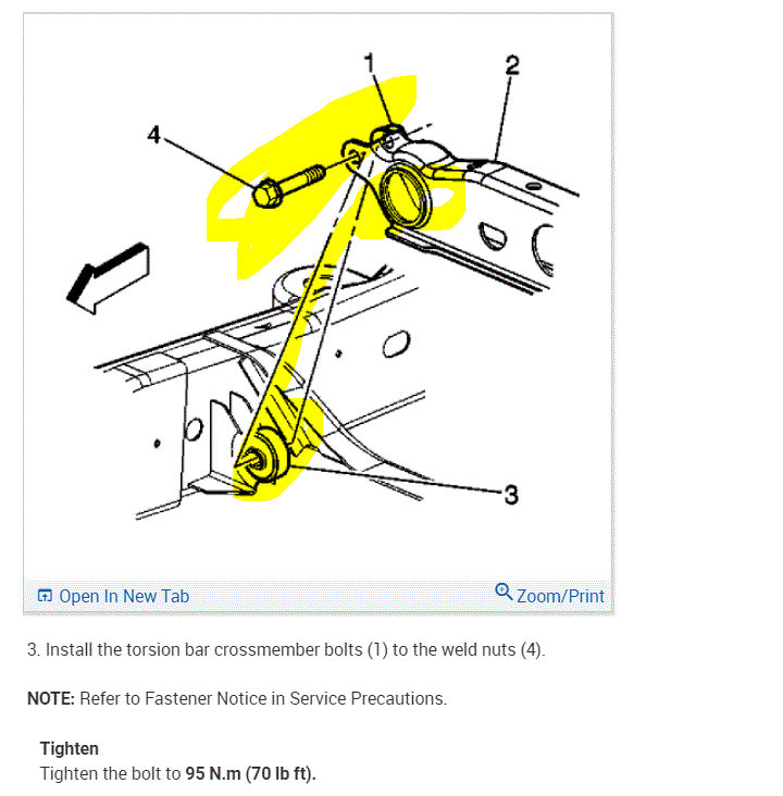

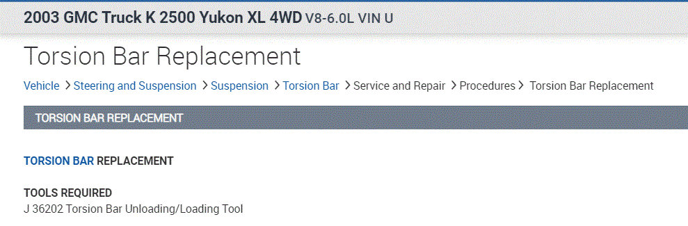

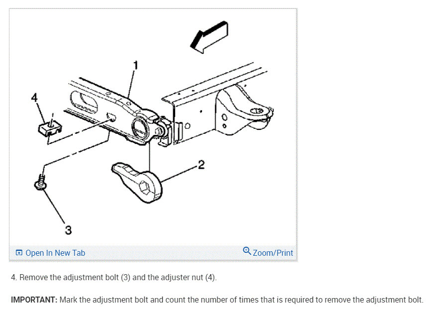

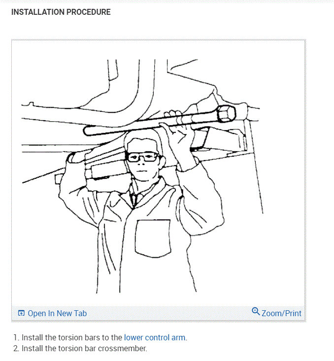

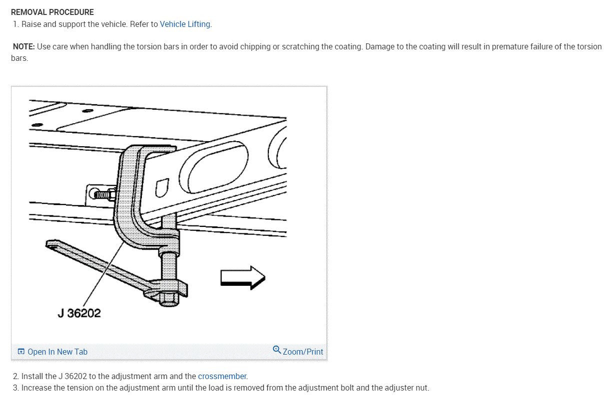

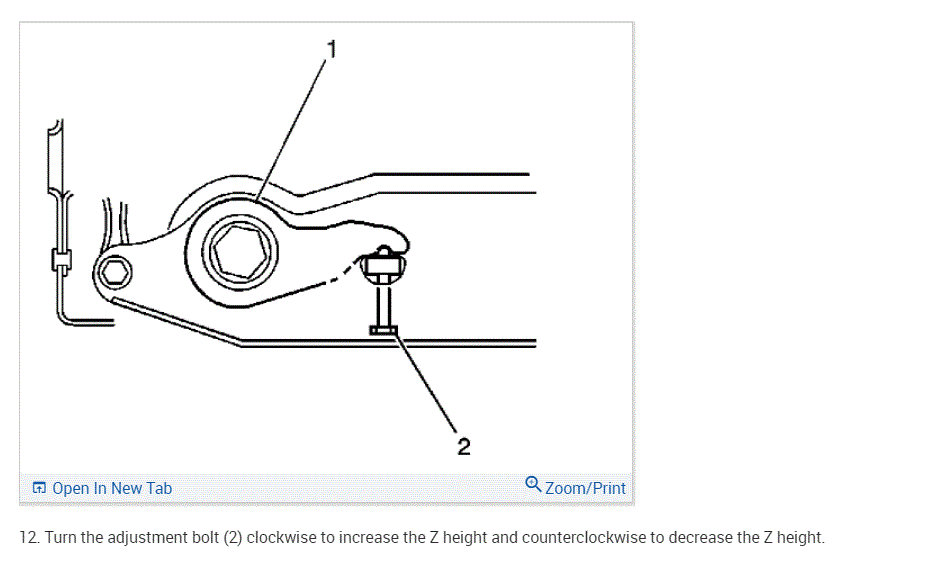

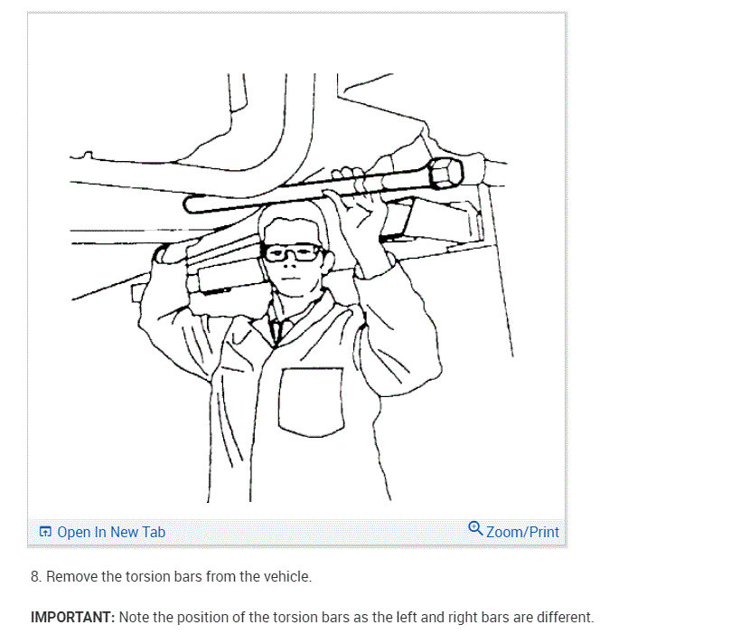

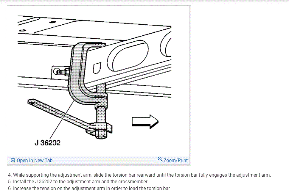

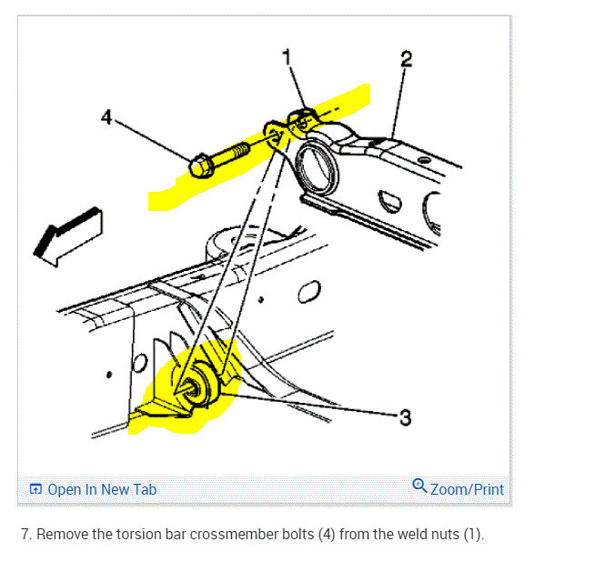

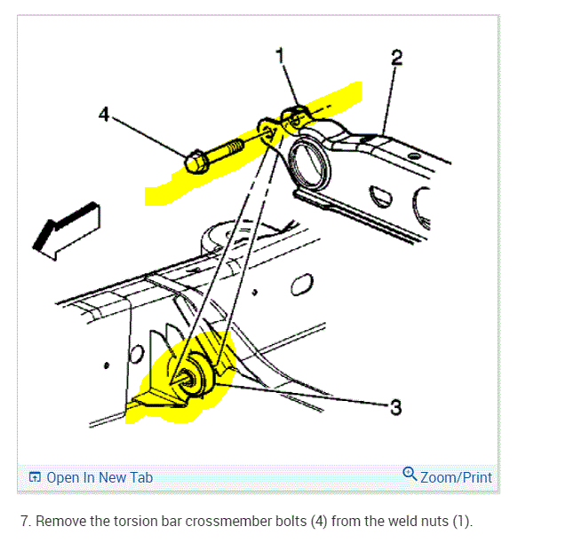

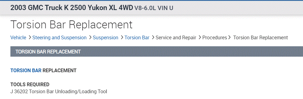

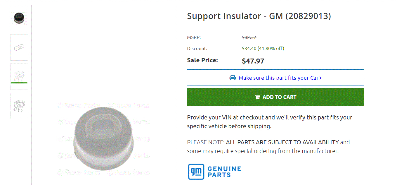

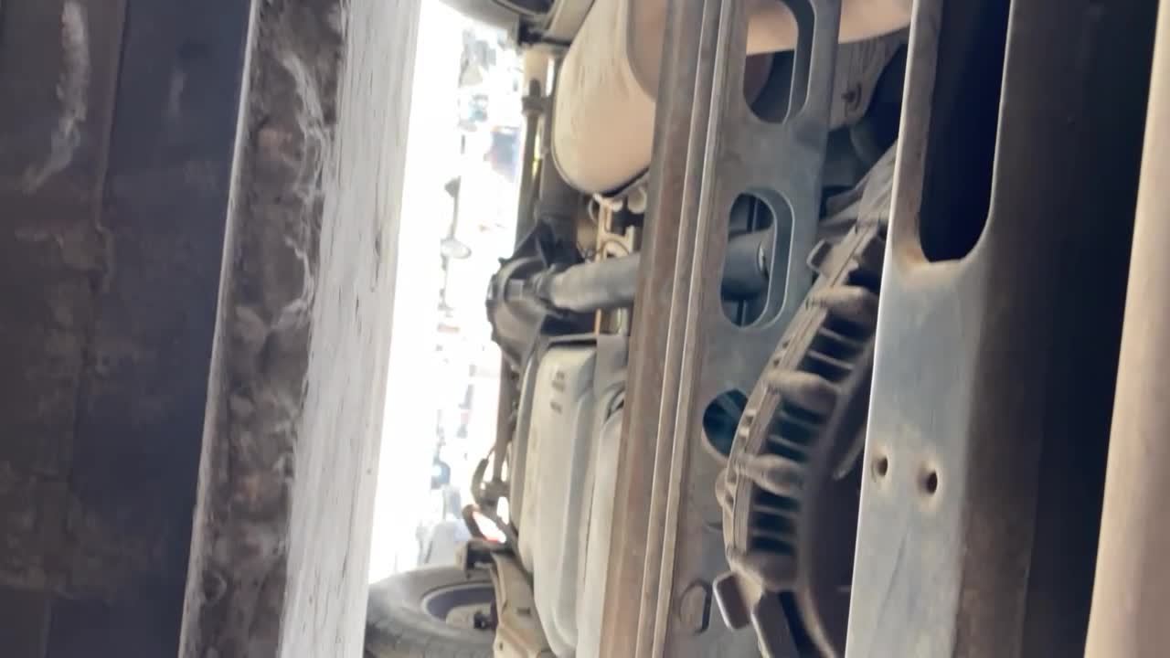

I believe the GM part number is 20829013. They refer to it as an insulator.

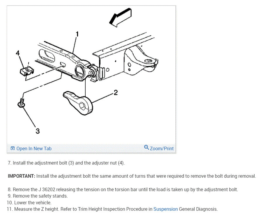

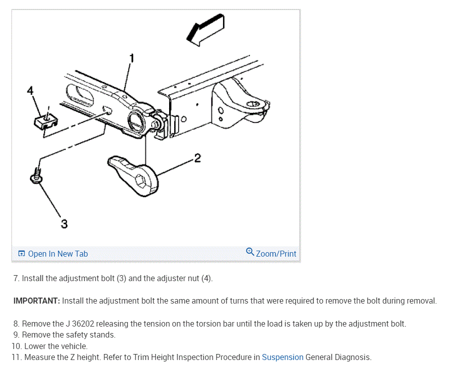

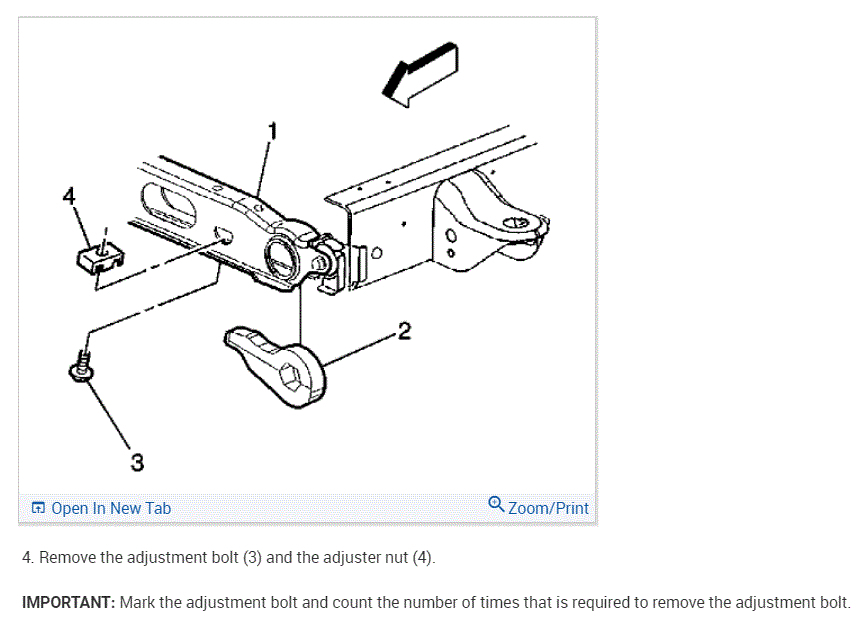

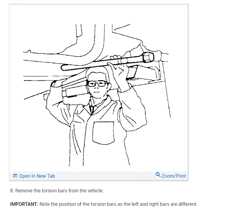

As far as replacement, you need to first remove the torsion bars. They are under tension. Once they are removed, unbolt one side at a time to remove the bolt from the cross member. If you can't, remove the old bushing and install the new one. However, you may need a press to remove it and install the new one.
If you look below, I attached the directions for torsion bar replacement. You aren't replacing them, but this is the only way I have the directions for removal/installation. I highlighted the bushings in the pics. Also, you will need to rent a special tool. See directions starting with pic 2. Pic 1 shows part.

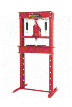

  • 110,194 POSTS

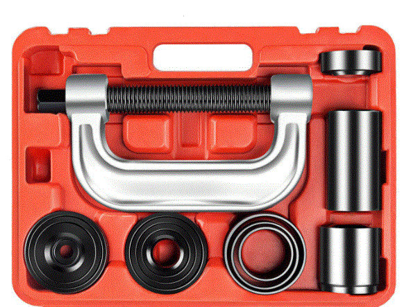

If you remove the cross member, a hydraulic press as seen in pic 1 would work. If you don't remove it, I personally would try using something like a ball joint press. (See pic 2).
Keep in mind, you may not even need one. If it is snug, you can even try to tap it out with a good ball peen hammer.
