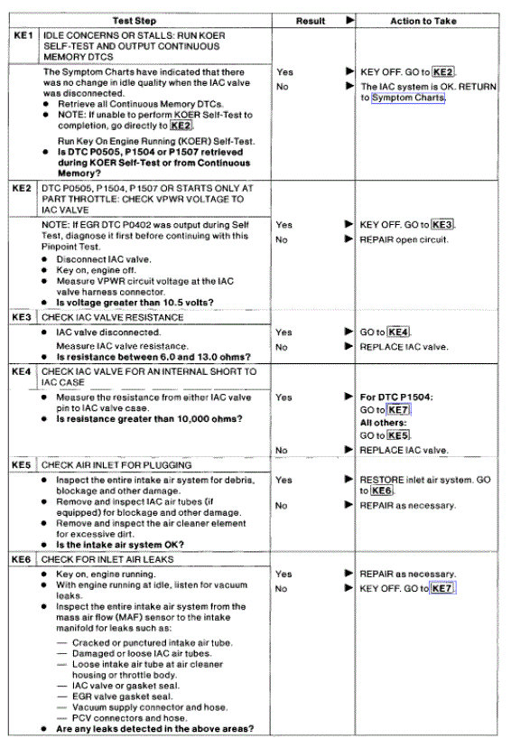

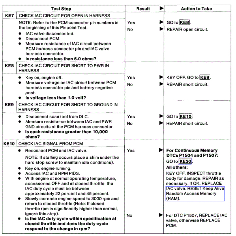

I was referring to the IAC sensor/motor.

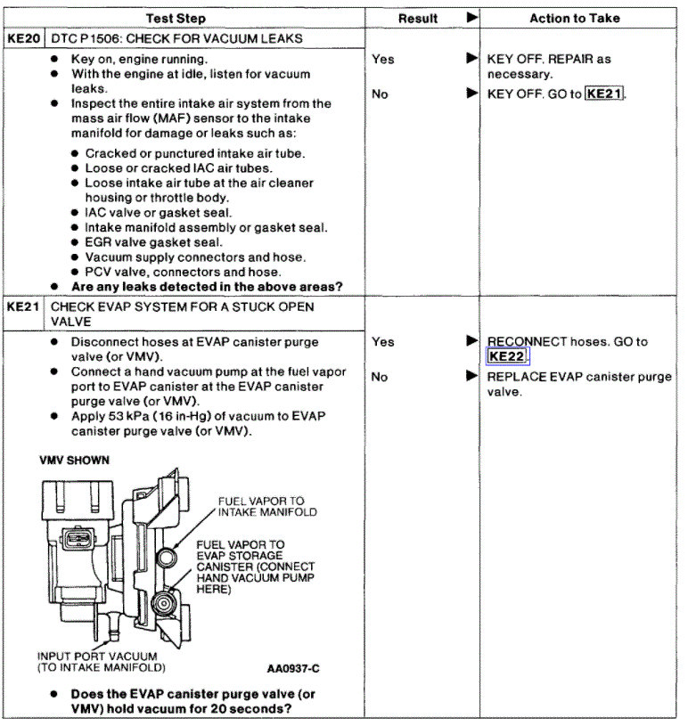

If you look at the attachments below, they are three different sets of diagnostics specific to the IAC. Each one is based on different possible issues.
Take a look through this and let me know if anything helps.
Also, if you have a scan tool that can provide live data information, let me know what the coolant temp sensor is signaling and what the short term fuel trims are.
Sep 21, 2021 at 9:16 AM

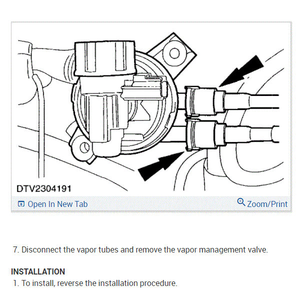

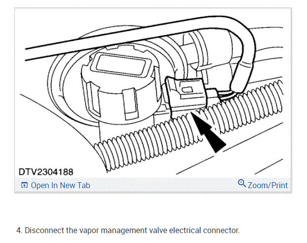

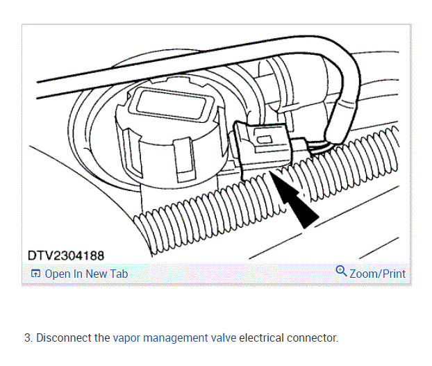

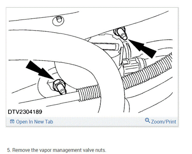

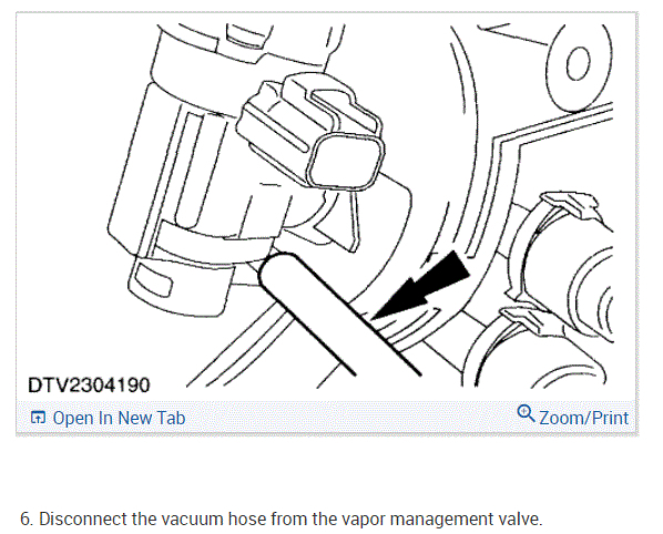

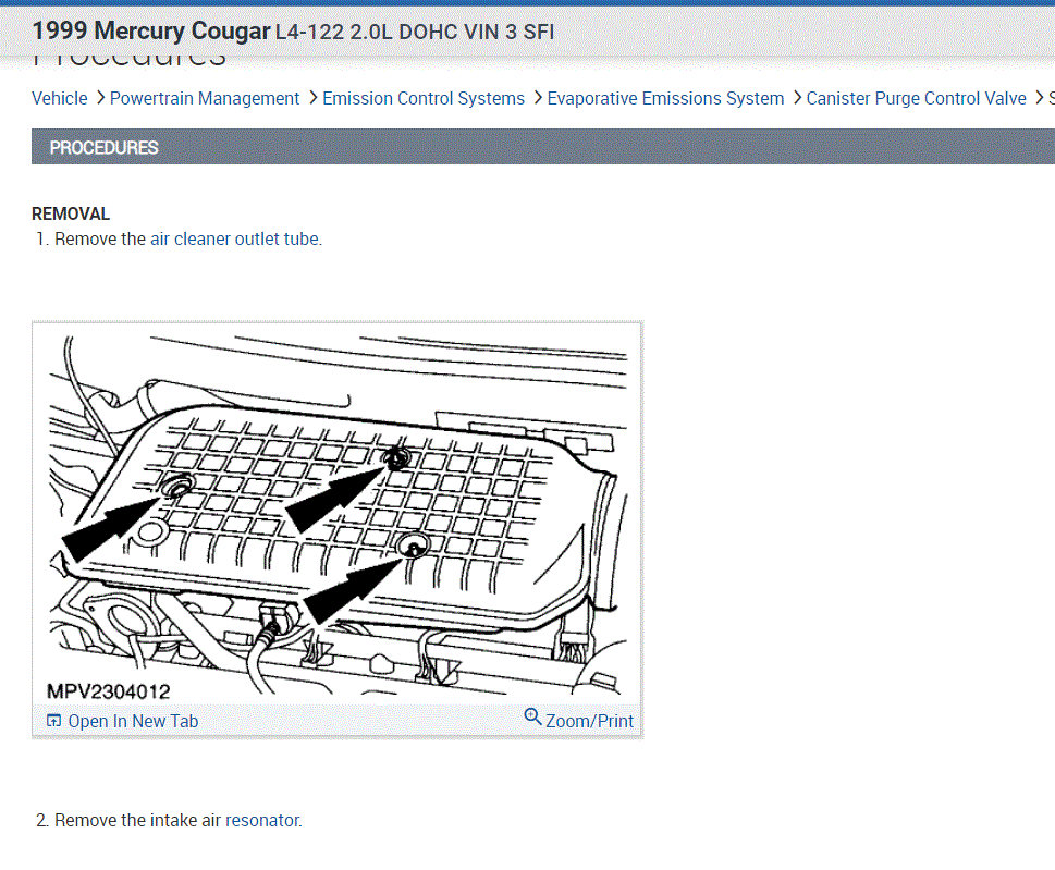

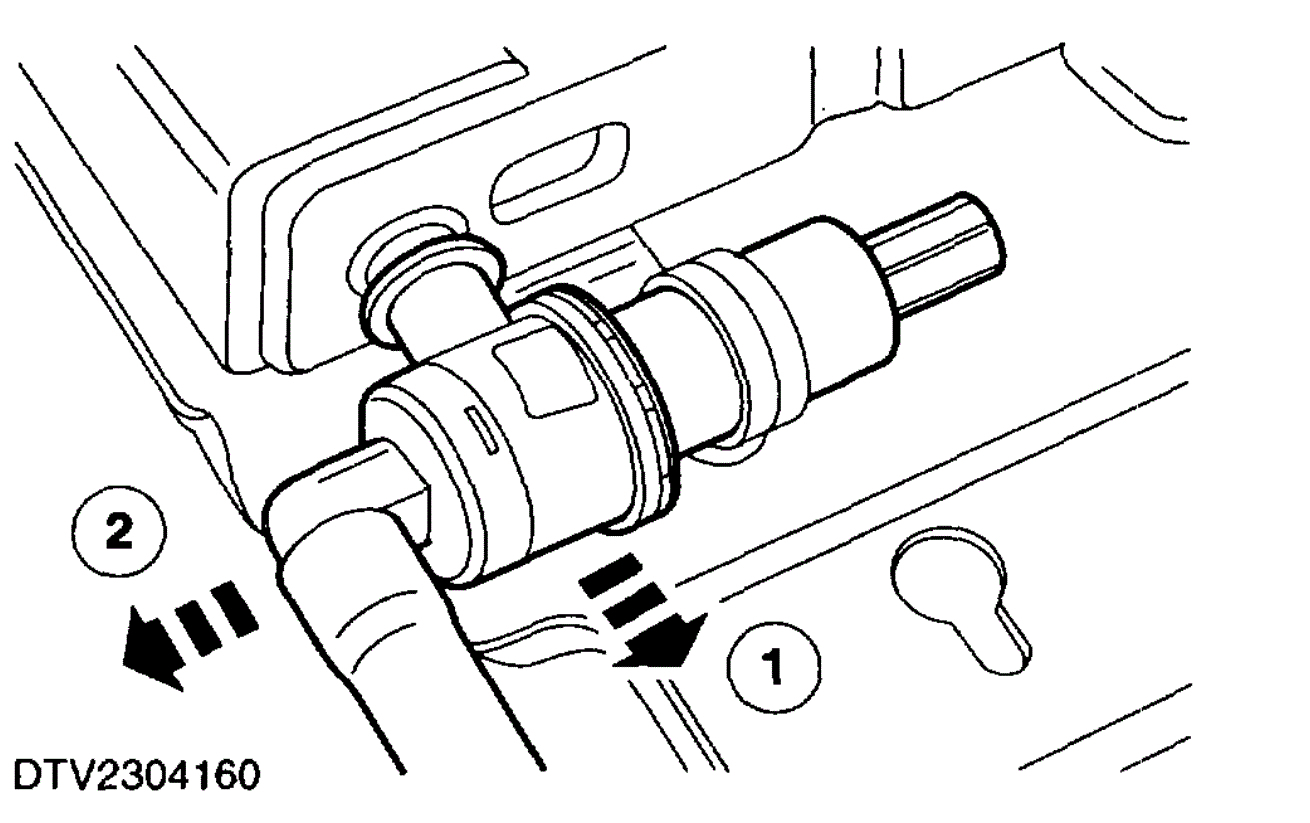

Just one more question please, because purge valve is a new thing for me, where is it located? Thanks in advance.
Sep 21, 2021 at 8:41 PM
  • 110,241 POSTS

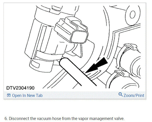

No problem. It's under the hood below the air box. I attached the directions for removal and replacement.
Sep 22, 2021 at 8:14 AM
WISH30
  • 124 POSTS
So, as I can understand from drawings, it is near to the EGR controlling solenoid valve.
Sep 22, 2021 at 1:26 PM
MASTER ASE TECH
  • 82 POSTS
The purge valve itself is near that, it has 2 vacuum lines going to it that are about the width of a pinky finger. Also most cars have a plastic line that will have a green cap on it for the purge line. Follow this line to the purge valve.
Sep 23, 2021 at 4:41 AM

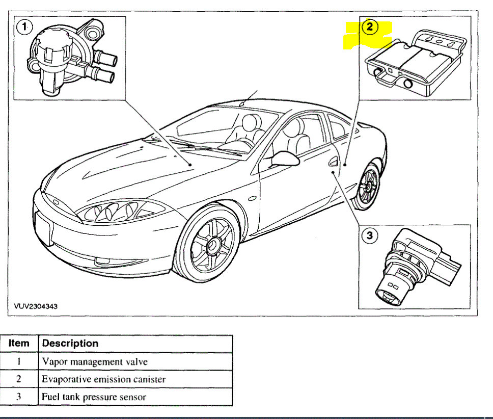

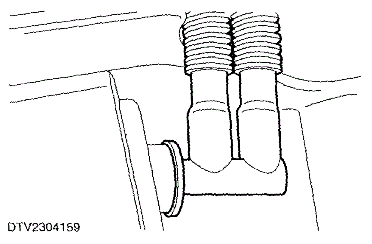

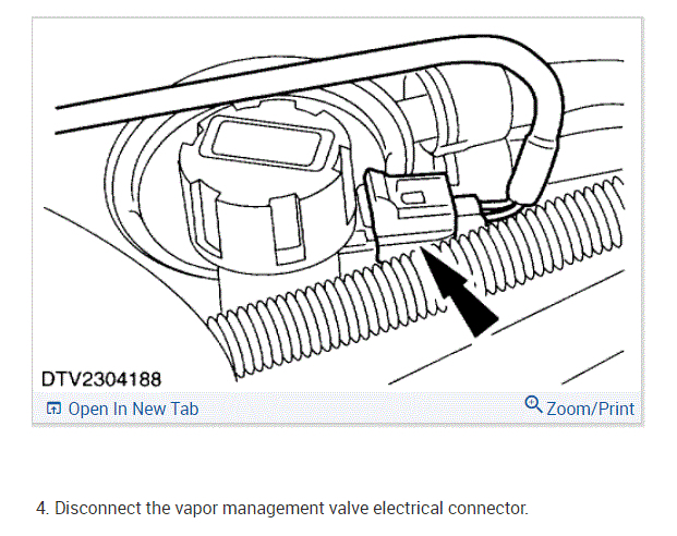

And what about the canister location, is it somewhere near the fuel tank or somewhere in the front? (sorry for asking too many questions, but I must be theoretically prepared first because these 3-4 days I am not able to look directly on the car - it is on service as usual :) this time for AC leaking, this is fifth time for the same problem because here in Macedonia mechanics are so good.
Sep 23, 2021 at 9:13 AM
  • 110,241 POSTS

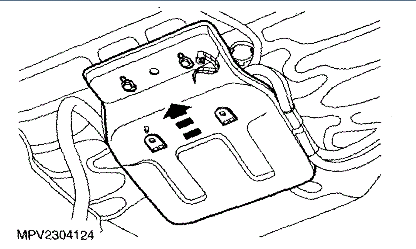

The evap canister is near the fuel tank. See pic 1 below. There is a canister carrier that holds it on the vehicle that will need to be removed to access the canister. See pic 2
Once the carrier is removed, you will see two vapor tubes (pic 3) and the canister vent solenoid.
