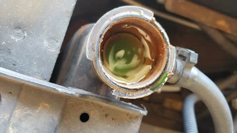

Returning to this thread because I still have some coolant loss. But no obvious leaks.
Roy mentioned a possible head gasket issue. I attached here a bubbling video to describe what I wrote above. It will slowly rise until it just comes out of the radiator.

Yep, I see.
I would have the leak down test done to check the head gasket.
