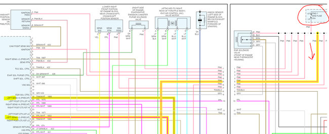

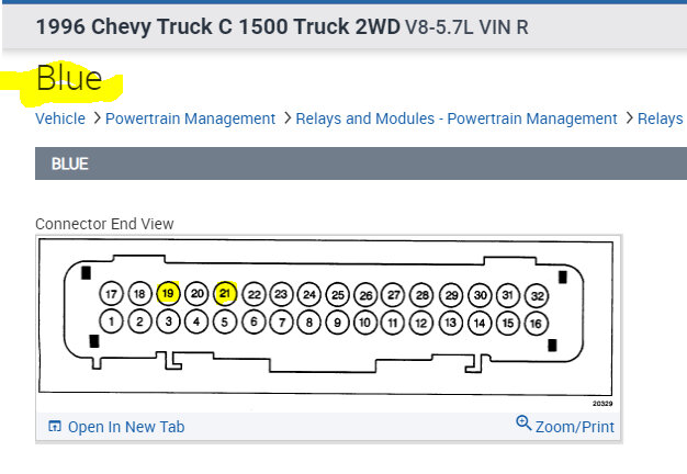

I need to know what fuses control the heating circuit for bank 2 sensor1?
Can you please tell me what the wiring colors are that come from VCM that provide 12v to bank2 sensor 1.
I need to check if there is voltage coming from VCM.
thank you
Aug 22, 2023 at 6:44 PM
  • 110,194 POSTS

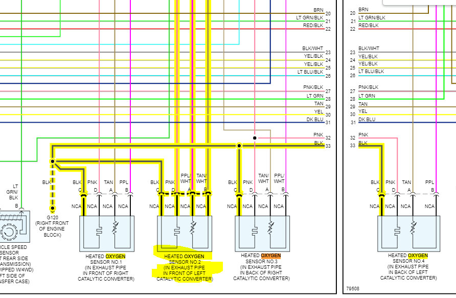

Power is supplied the engine 1, 20-amp fuse in the under-hood fuse box. When you check this fuse, make sure there is power to and from it. It will only have power with the key in the run or start position.
I attached two pics below and highlighted the relevant wiring for bank 2 sensor 1. Two wires go to the VCM, and one is from the power supply mentioned.
Take a look and let me know if it helps.

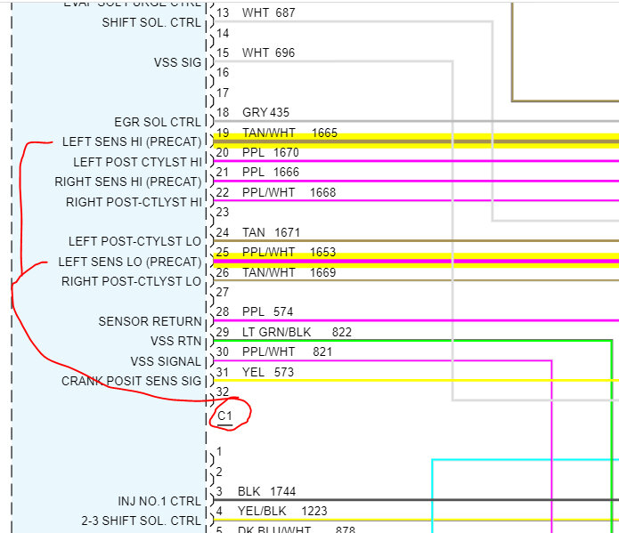

Thank you for your help, but i need to know what pin on the cable side of the 02 sensor is suppling 12 v to bank2 sensor 1. I remove cable coming from VCM but don't know were to check for 12v.
key on engine off. The diagram are not that good so, I can't tell where they are coming and going from, please send actual site the diagram might be better.

I attached the portion of the VCM that the sensor signals go to. Both wires are in connector 1 at the VCM and are pins 19 and 25. See pics below. Note, the C1 connector will be blue in color.
As far as the site providing it, they come from Alldata. It isn't a free site, so if you need anything specific, let me know and I'll get it for you.

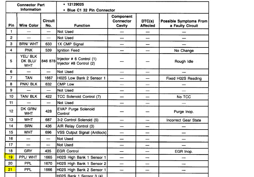

I was wondering if you could tell me what color wiring and the pin number that comes from the VCM that supply's 12v dc to the bank2 sensor1 02 sensor.

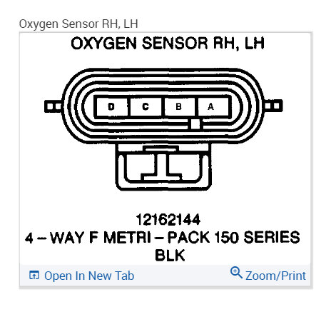

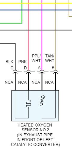

I attached the information below. Pic 2 is a pinout of the connector. Each wire in pic 1 is identified with a letter. The two pics work in conjunction with each other.
Let me know if this helps.
Aug 27, 2023 at 6:12 PM
TEXASTONY
  • 33 POSTS
First thank you for your help and for the diagrams.

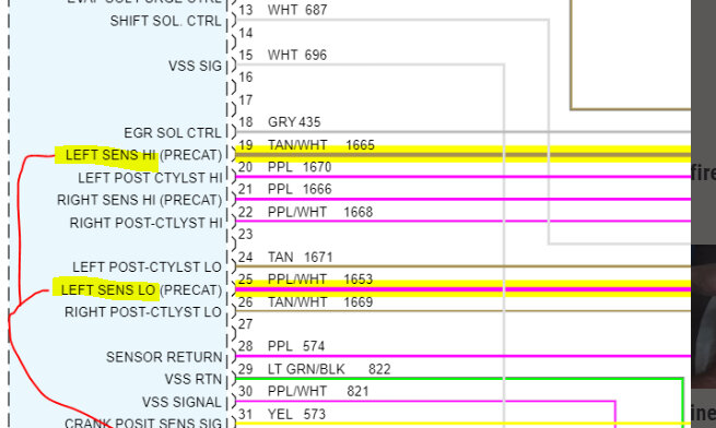

1.So the picture above #12162144 is the cable coming from the VCM correct that connects to 02 bank2 sensor 1 , what two wires do i check for voltage and what is the voltage value at those two wires.

The one going to the "low" reference will provide a ground path. The other is a voltage signal. It should be 5v. See pic below

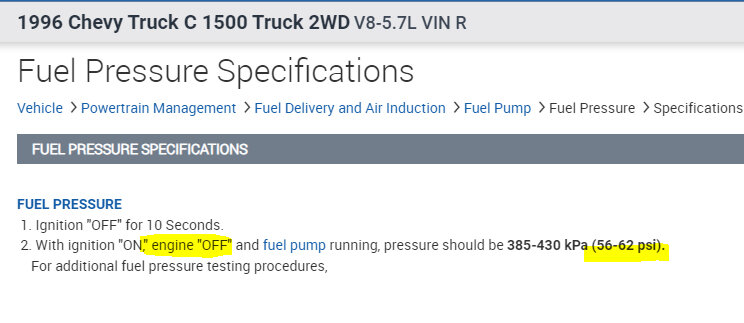

i drove it around for about a half hour without check engine light coming on, It runs better ,but there is still a little feeling like not getting enough gas. I did a fuel leak pressure test when running I got 55 psi . I don't know the correct psi for my 1996 chevy truck 5.7l motor. can you let me know the psi when running. Thanks

The manual only provides pressure with the engine off. See pic below for pressure specifications.
While the engine is running, the fuel pressure should drop about 5 psi, from the static prime pressure. If you snap the throttle, the fuel system pressure should jump up about 5 PSI.
Take a look at this link:
Based on the pressure you got with it running, it sounds like the pump is working as it should.

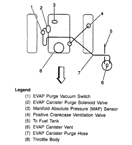

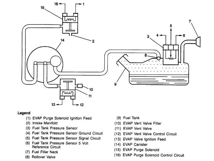

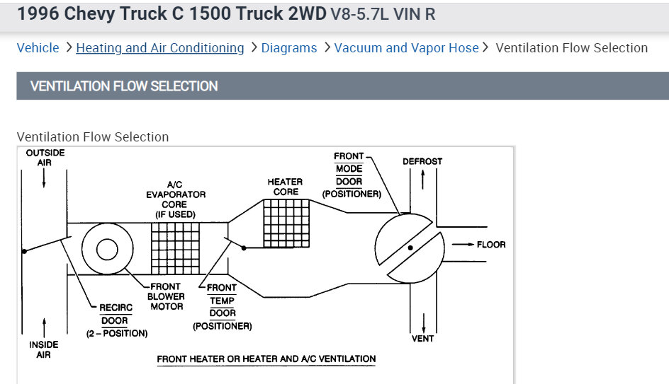

I still has a little miss, like it needs more gas, or something don't know, I don't know how to check the vacuum system. was wounding if there are vacuum diagram for my truck? and if so, would you please email it to me, I bought a BTSHUB Auto Fuel Injector Cleaner Tool Kit Fuel Injector Tester Tool and would like to clean my injectors using these devices, But it with no instructions or customer service number. What is the size of the inlet fuel valve the device connects to on fuel rail on 1996 chevy truck 5.7l.
Aug 31, 2023 at 8:25 AM
TEXASTONY
  • 33 POSTS
On the fuel rail what is the size of the inlet valve, the tool does not have the right one.
Aug 31, 2023 at 8:27 AM
  • 110,194 POSTS
I'm not sure what you are referring to when you say inlet valve. Could you upload a pic of it?
Also, I attached the vacuum schematic below for you. Additionally, here is a link that explains how to check for leaks:
I may have already asked this, but if you have a live data scan tool, could you let me know what the short-term fuel trims are?

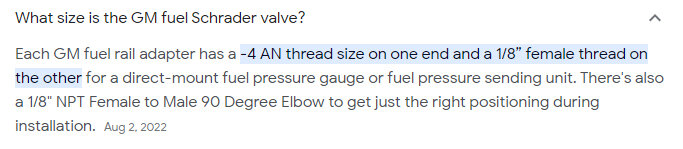

Sorry I meant the Shrader value on the fuel rail. What size do i need to hook up a tester?
Sep 1, 2023 at 10:43 AM
  • 110,194 POSTS
I had to find that one online. I attached a pic of the size. Let me know if that helps or if you have questions.
See pic below.
