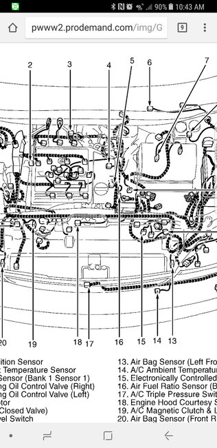

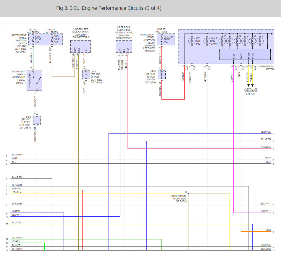

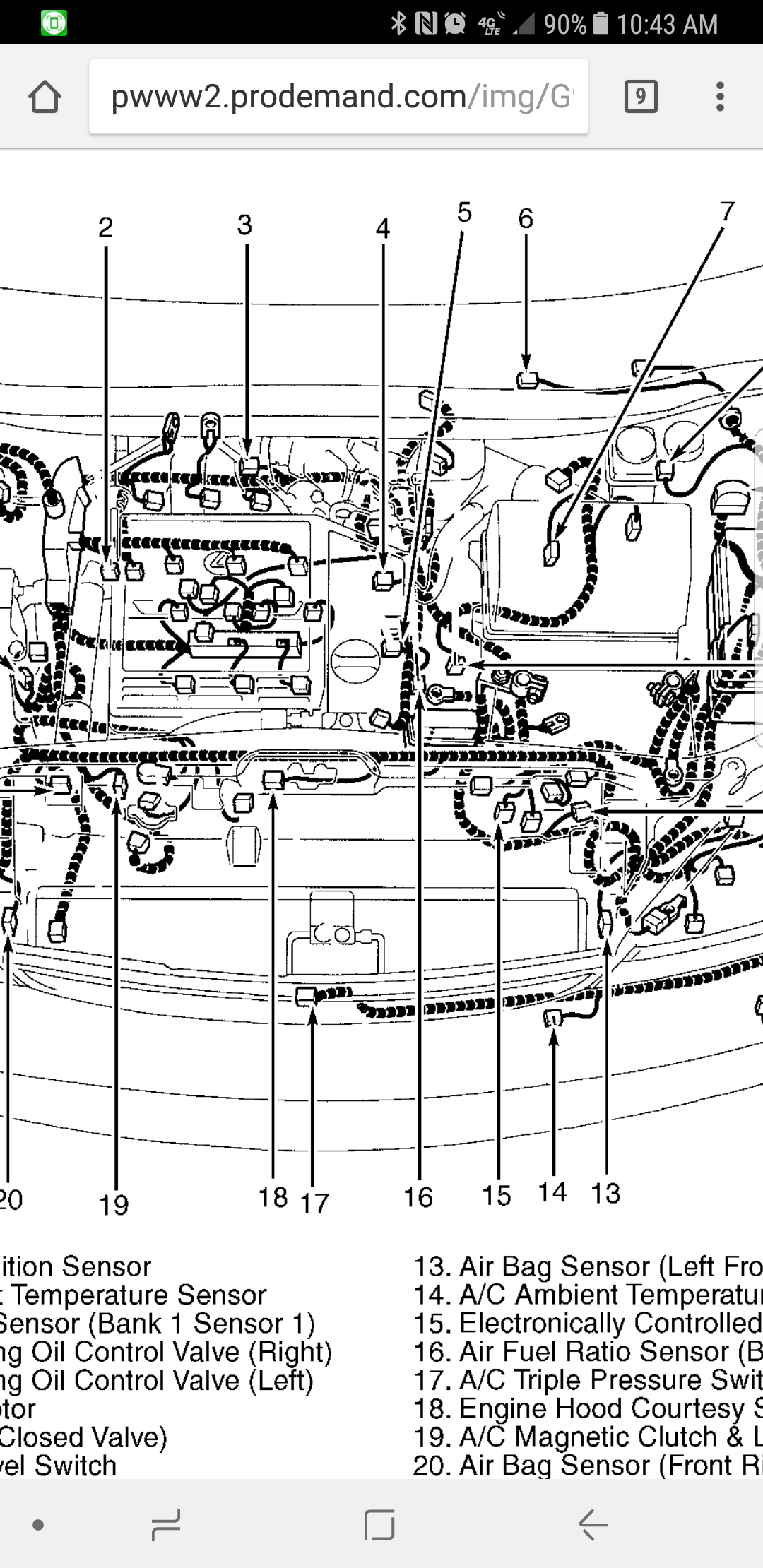

Got code p1150. Autozone computer relayed code was for bank 2 sensor 1, but when i tried to order part they could not tell me if it was upstream $180.00 or downstream $79.00. i need to know the actual location of the sensor and if it is upstream or downstream. i previously paid $30.000 for a five minute sensor replacement near the exhaust. and over $2,000.00 because a sensor was not replaced and blew a hole in my exhaust. I am hoping this sensor is the one between the radiator fan and the engine. i was quoted $375.00. However, if i can i would try to replace it myself depending on difficulty and location.
Aug 22, 2017 at 1:38 AM
SATURNTECH9
  • 30,869 POSTS
It is upstream and number 16 in the diagram.
Aug 22, 2017 at 10:44 AM
NATASHA AVERY
  • 8 POSTS
In the diagram it looks like it is the sensor located between the fan and engine. is that correct?
When i went to Autozone they showed the upstream sensor was different then the downstream sensor, but when i go online for the part it shows you can use the same sensor for upstream and downstream.
Is that true? do you know why?
Aug 22, 2017 at 11:50 AM
SATURNTECH9
  • 30,869 POSTS
It is screwed into the exhaust manifold that diagram is horrible. Also, the upstream screws in and the down stream sensor bolts in so there is no way they can be the same. Have you tried a website called rock auto dot com for parts? They have good prices and I have bought a ton of parts from them over the years. I also have a five percent discount code for them if your interested.

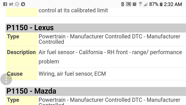

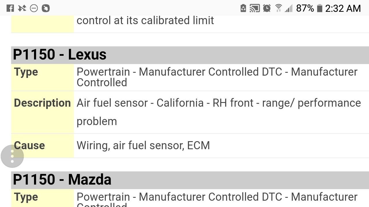

While still on car i tested the2black wires and it read 3.2..as far as i know that means it's good so i left it in?.i had to replace my old battery so CEL was auto reset..now it will idle 4ever, but once i drive 2 blocks the CEL comes on with same code p1150 b2s1 (autozone)..
P1150 Lack Of HO2S-21 Switch Fuel Trim At Limit (2carpros site)

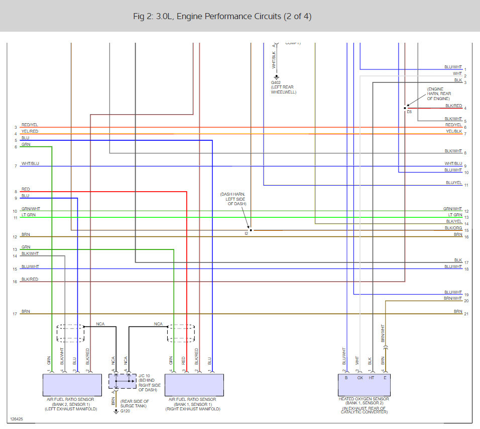

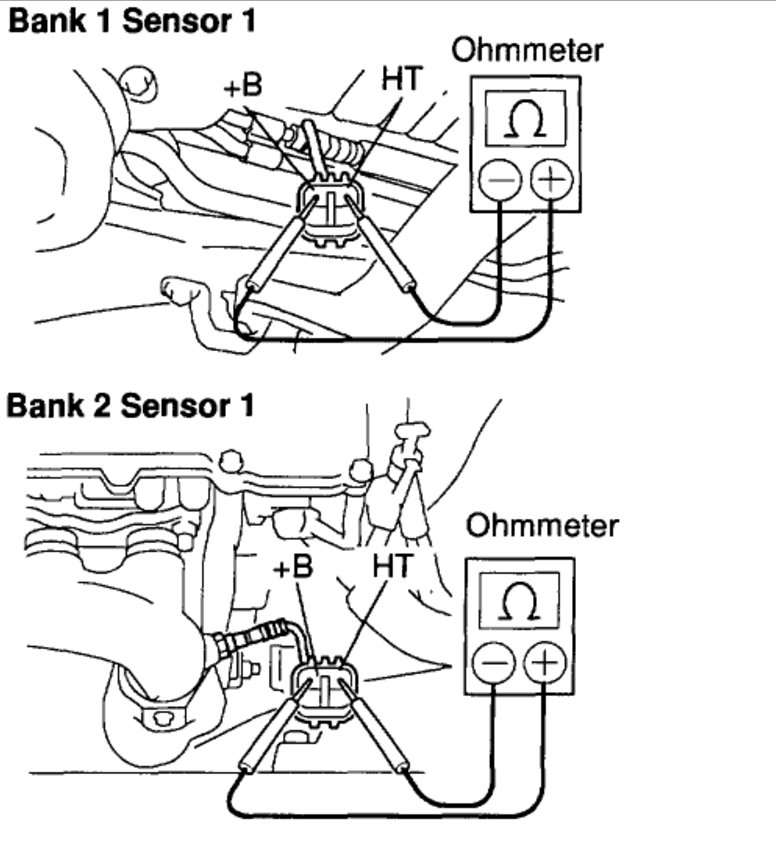

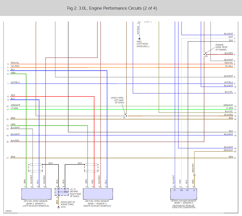

Here are the testing procedure and location for the sensor.
Disconnect the A/F sensor connector.
Using an ohmmeter measure the resistance between terminals +B and HT. Resistance: 0.8 - 1.4 Ohms at 20 °C (68 °F) It the resistance is not as specified, replace the sensor.
Torque: 44 Nm (440 kg.cm, 31 ft.lb) Reconnect the A/F sensor connector.

The code isn't for the heater circuit it's for the o2 sensor readings number one fix is replacing the sensor.But if it started since you were messing with the air box tubes check for rips recheck for loose connections etc that will set a code.

Sorry ken but i have no clue about cars I'm learning as i go...I have no idea what terminals +B and HT are..can you tell me? Is that sensor wires? If so what colors and what color to connect to on multimeter?
When checking for resistance should the ignition be on or car be started? And what settings on multimeter would i use ?

Hi no problem getting people to know car repair is what we do! It is fun most of the time. :) Set the volt meter to OHMS here is a guide to help you see how to work a volt meter
The terminals you need to test are the two near the three notches on the connector. Check out the diagram above and see how they are holding the connector to the oxygen sensor.
I agree with Saturntech9 that the problem could have nothing to do with the sensor the code is saying the sensor reading is out of range which can be caused by an engine misfire. Have you done a full tune up lately?

oh my i feel so duh...i just found out that +B and HT are on the voltmeter...im laughing at myself right now..i just need to know what color are the correct 2 wires im suppose to test? with ignition switch in on position {vehicle not started} I previously tested the heating element {2black wires} measured 3.2..was told black wires was wrong 2 wires.
FOR NEW TEST
once i know "THE CORRECT" color wires I'm suppose to test,{with igniton switch in on postion} and if not between 0.8 and 1.4 then i should replace sensor..and if within range then its dirty MAFS..

oh my god i think im going to lose my mind...im WRONG WRONG WRONG...the +B and HT are NOT on the voltmeter...but i cant find what the correct wire color is for +B and HT...i did the 2 black wires 2weeks ago and they were 3.2ohms but was told those were the wrong wires to test because the heating element is not the trouble code im getting..
Sep 9, 2017 at 4:08 PM
  • 54,178 POSTS

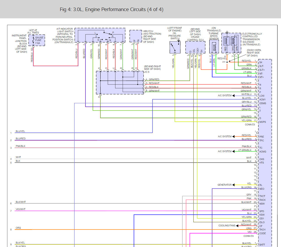

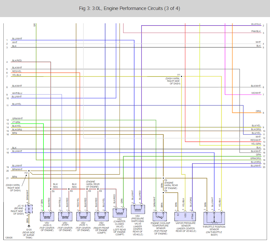

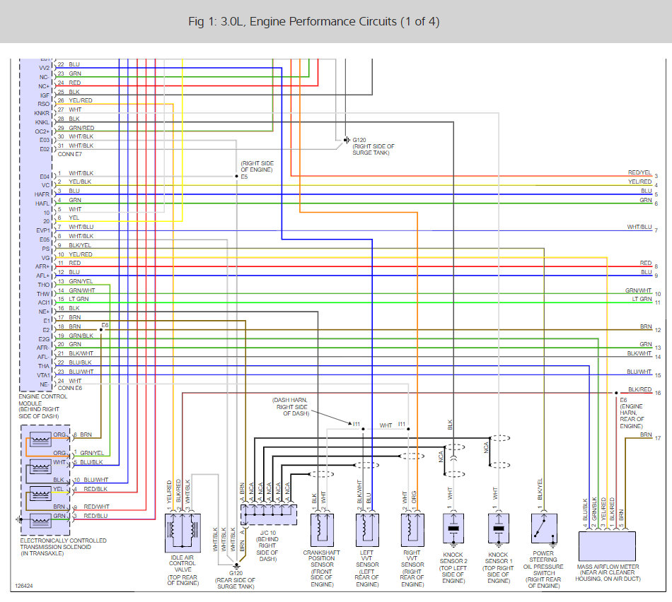

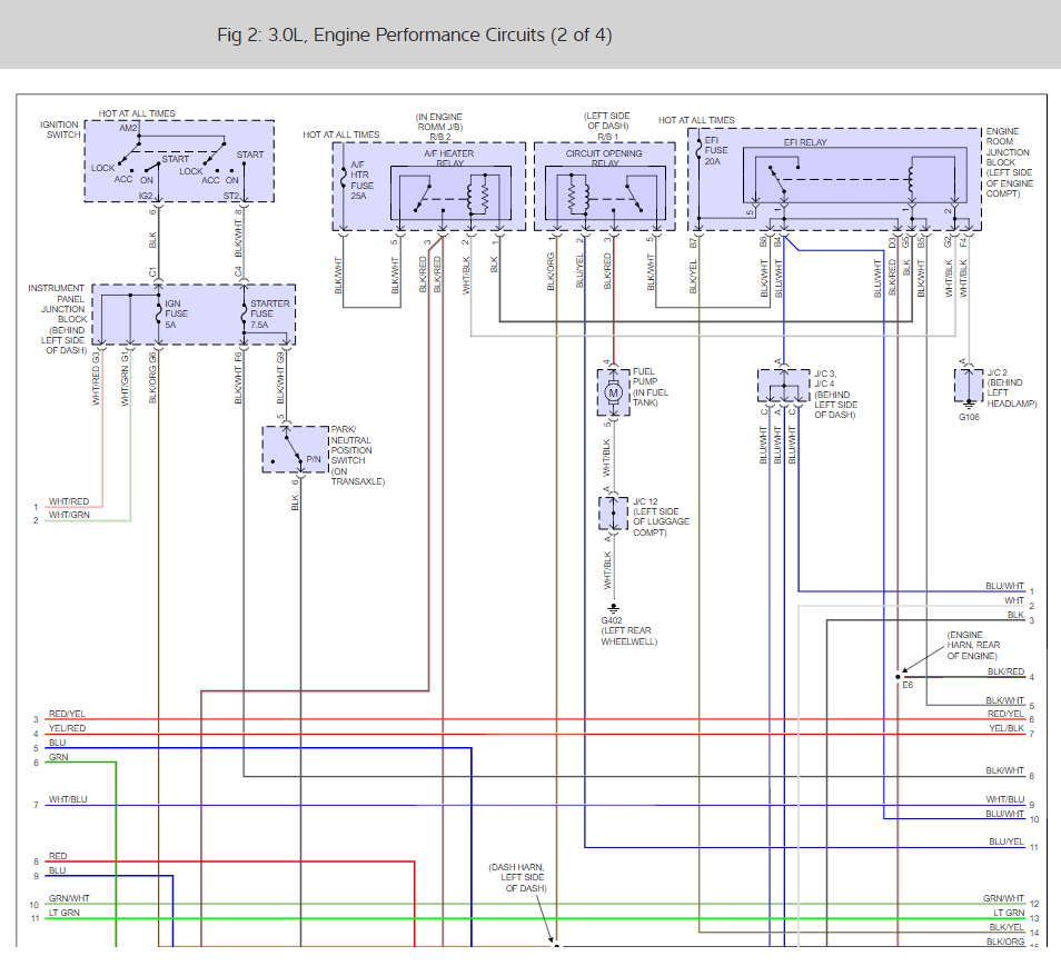

Im glad you are having fun, I do too it why I got into this field many years ago. Here is the engine wiring diagrams (below) so you can find which wires you are looking for to complete the test.
The wires you want to test are black/white and blue.
Sep 11, 2017 at 9:00 AM
NATASHA AVERY
  • 8 POSTS
SORRY I don't understand the diagrams...but over the weekend i tested white n blue w/multimeter,it read nothing.. I was so frustrated I went ahead and just replaced air filter, and the bank 2 sensor 1 on my own and turned off the CEL with the OBD2 scanner..so far I have only driven about 40 miles on a full tank on freeway n streets to see if CEL would come back on..it hasnt so far ,,but now when i connect the OBD2 scanner after driving for 15 minutes then have car at IDLE it says..closed loop using 02sensor for fuel mix.
