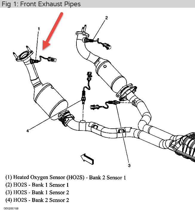

Location of Bank 2 Sensor 1 Cadillac SRX 2004 3.6 Litre
Mar 8, 2016 at 6:58 PM
HMAC300
Experienced Mechanic
48,601 POSTS
Here is a guide to help you see what you are in for when doing the job.
https://www.2carpros.com/articles/how-to-replace-an-oxygen-sensor
Cheers
