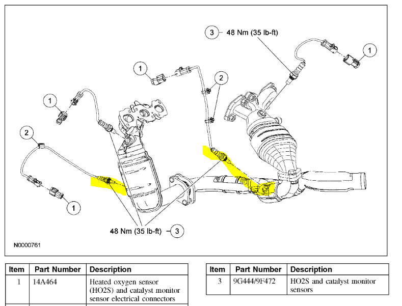

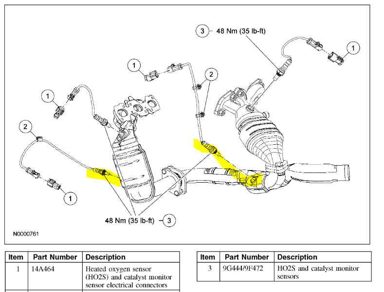

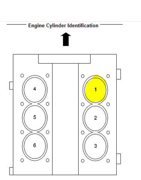

The car is throwing a p2270 code which is the 02 sensor, however I can't seem to locate where the sensor is or even a diagram to show where it's located. It is sensor 2 in bank 1 and should be located just below the catalytic converter but it is not.

Bank 1 is the side that has cylinder 1. If you stand at the front of the vehicle, it will be on your left. (see pic 1)
Sensor 2 is at the end of the converter. On this vehicle, the catalytic converters are integral to the exhaust manifold. If you look at pic 2 below, I highlighted both sensor 2 sensors. If I am orienting myself correctly with the pictures, the manifold on the left side of the pic should be bank 1.
