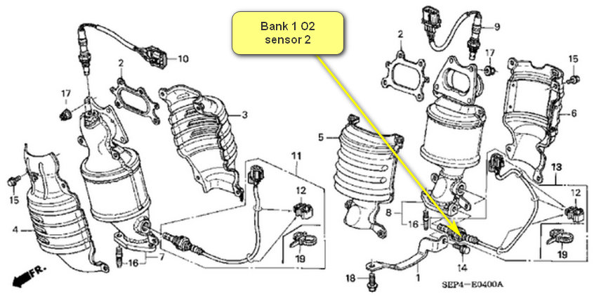

I got the P0141 error code. I want to attempt to replace the sensor myself and I have a couple of questions.
I understand that there are 4 O2 sensors on my car.
Where is the bank 1 sensor 2 located?
Is the bank 1 sensor 2 the "downstream" sensor?
Thanks in advance for your help.

Bank 1 on your vehicle is the rear bank facing the firewall.
O2 sensor 2 is the downstream sensor from the catalytic converter.
To replace the sensor, you should use an O2 sensor socket which has a special cut out for the wiring. See picture below.
How to replace an O2 sensor 2 bank 1 on Acura:
https://youtu.be/DHtLru4Flbk
Also, how to replace the O2 sensor:
https://www.2carpros.com/articles/how-to-replace-an-oxygen-sensor
Location of the O2 sensor 2 is in the 1st picture below
