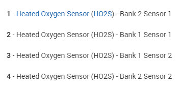

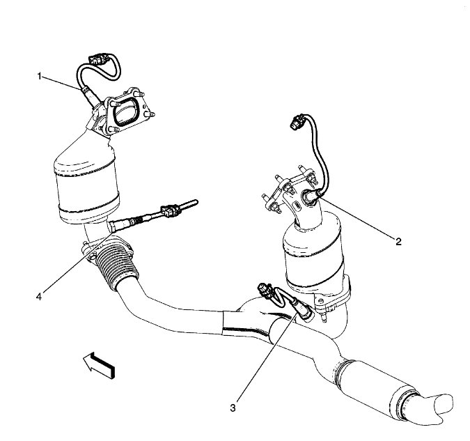

Need to know how many oxygen sensors the car listed above has. The exact location and how to get to the bank 1 sensor 2.

Here is a tutorial showing what is involved for an 02 sensor replacement. Here is a guide to help you step by step with instructions in the diagrams below to show you how on your car.
https://www.2carpros.com/articles/how-to-replace-an-oxygen-sensor
I've attached below pictures of your vehicles 02 sensor locations.Hope this helps and thanks for using 2CarPros.

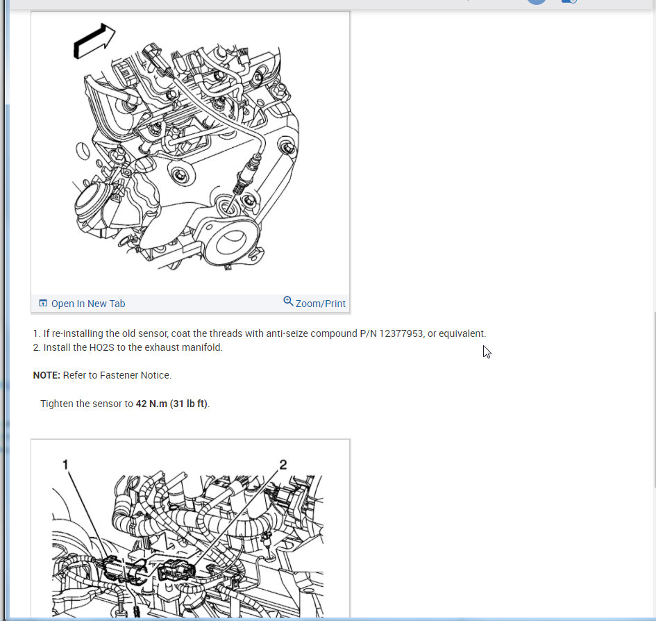

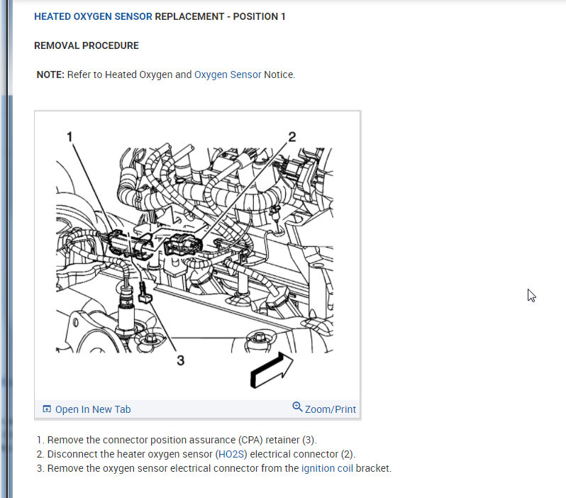

Here are some guides that will help with this:
https://www.2carpros.com/articles/how-to-test-an-oxygen-sensor-02-sensor
Plus here is a video on a different vehicle but it is similar enough that you should be able to get useful info out of:
https://youtu.be/B4CAou7i7Io

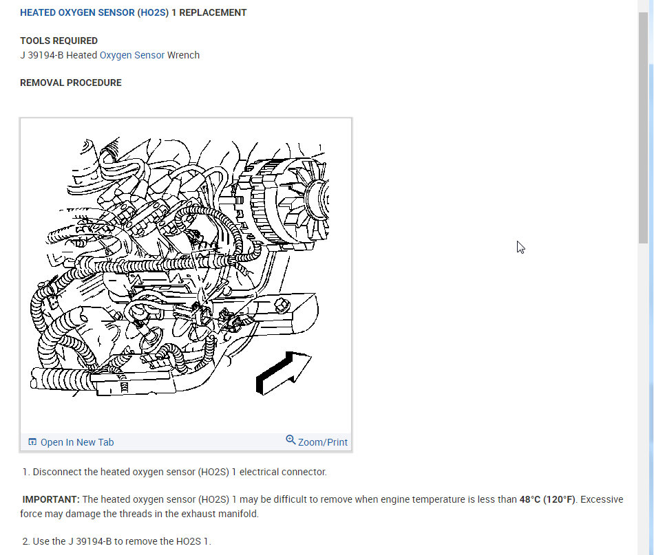

Below is the process from the manual that will help with this. Please let us know if you have other questions. Thanks

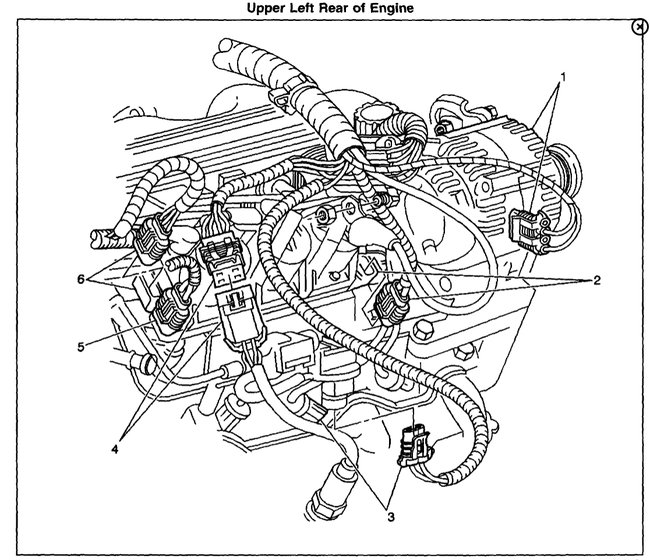

LIVERAHOPE1012
  • 2006 CHEVROLET IMPALA
  • 3.5L
  • V6
  • 176,000 MILES

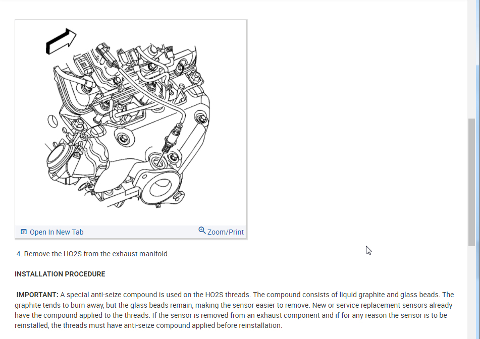

I heard a rattling under my car and noticed that my O2 sensor was lose and looked like it needed replacement. I read online that you should replace all of them if one is bad, and it stated my vehicle has three. I found the second O2 sensor on the back side of the engine by the fire wall. I looked in the front driver side where they said the third should be and I can't locate it. I have looked all around and so has my boyfriend. I feel like the third one doesn't exist! If you could give me a diagram of sensor locations that would be amazing. Please help :(

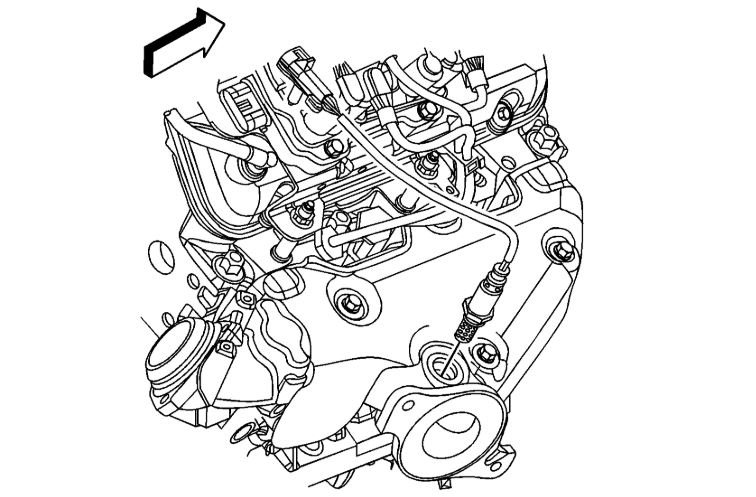

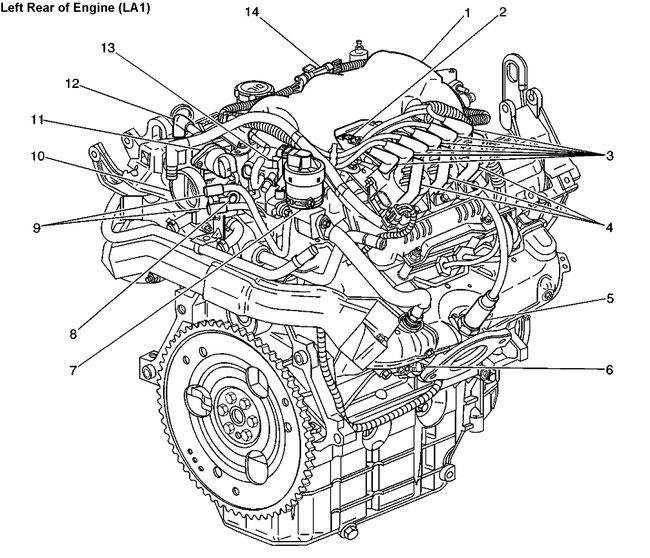

  • 52,797 POSTS

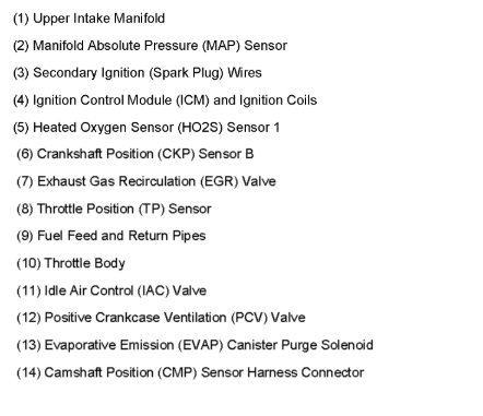

Good afternoon,
First, there are only two sensor in your car.
Second, you do not need to replace all if one is bad. Just the one that is bad is all that needs to be replaced.

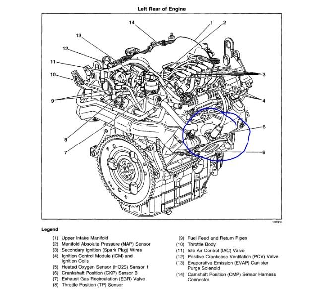

I attached pictures of the two sensors on your engine.
+1

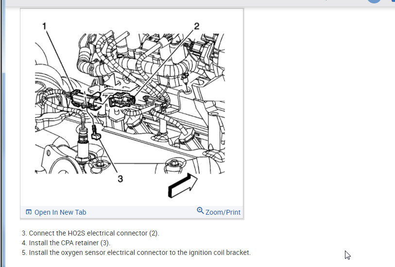

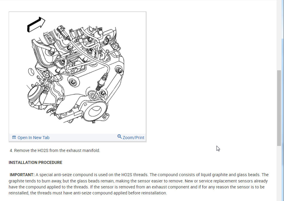

Here is a guide that will help with this:
Below you will find the process from the manual on how to replace the sensors. Please let us know if you have other questions. Thanks

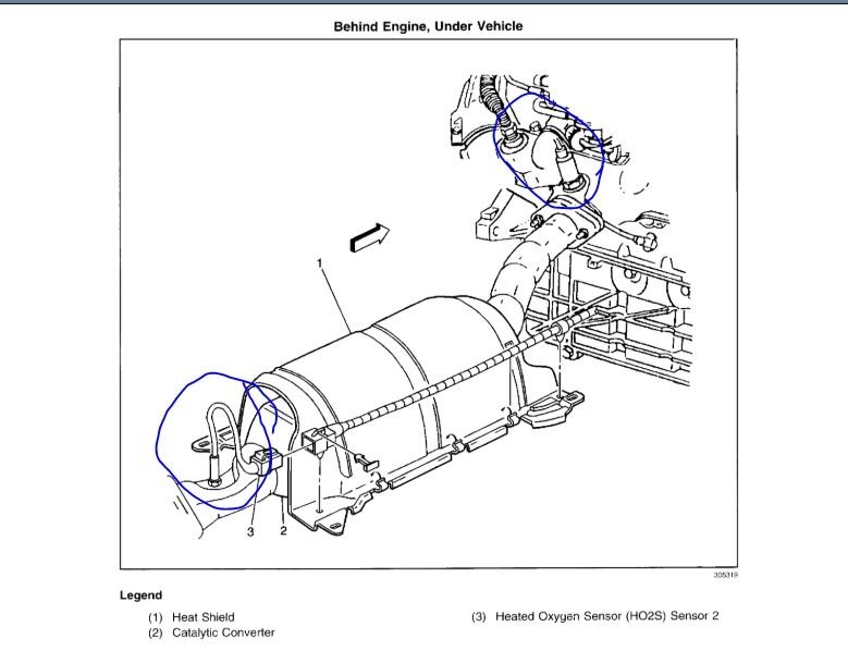

My car has been pulling an OBD code for the Bank 1 Sensor 1 oxygen sensor, but I cannot find it. I can only seem to find one before the catalytic converter and one after, so am I overlooking one or are there only two? If there are only two, why would the same code continue to flash if the two sensors were replaced? Please help.

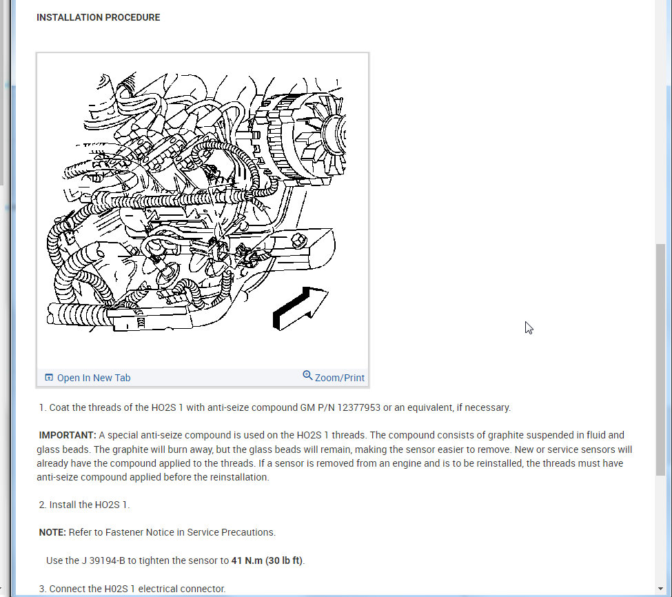

Here is a guide to help you change the sensor out and diagrams below that show the location of the sensors:

MRSTONE2007
The code it is pulling is P0135. I have replaced the one before the catalytic converter, but the problem persisted which led me to believe there is another which I found and fixed thanks so much I will get back to you if I have another problem. I love this site.

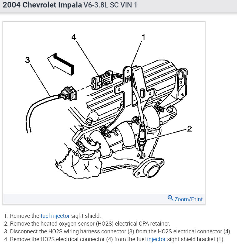

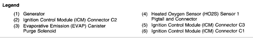

TRENTDENNIS
  • 2004 CHEVROLET IMPALA
  • 6 CYL
  • 2WD
  • 75,000 MILES

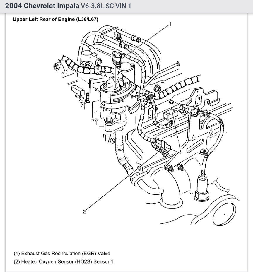

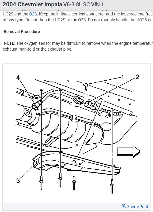

Trying to find the location of the O2 sensors. Found one on the rear of the engine, but can't locate the second sensor.
Saturday, May 8th, 2021 AT 1:17 PM (Merged)
  • 75,992 POSTS
Heated Oxygen Sensor (HO2S) Sensor 1 (3.4L VIN E)In exhaust manifold, rear of engine compartment. See Fig. 36.
Heated Oxygen Sensor (HO2S) Sensor 1 (3.8L VIN K & VIN 1)Above exhaust manifold. See Fig. 56.
Heated Oxygen Sensor (HO2S) Sensor 2 (3.4L VIN E)In exhaust system, behind catalytic converter. See Fig. 45.
Heated Oxygen Sensor (HO2S) 1 (3.8L VIN 1)In exhaust manifold, rear of engine compartment. See Fig. 31.
Heated Oxygen Sensor No. 2 (3.8L VIN K)In exhaust system, behind catalytic converter.

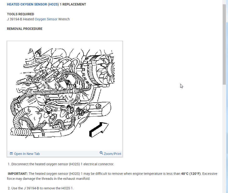

I am trying to change my front o2 sensor by myself so I was wondering what id the best way to locate it? Can I reach it from the top of the engine or should I look from the bottom?

Here is a guide and some diagrams to help you see what you are in for when doing the job:

I had a code reader hooked up to my car it read that I needed to change the cam shaft sensor and oxygen sensors and catalytic converter. I replaced the cam shaft senor. It doesn't want to pick up speed and overheating after you get to 50 mph. Can't figure out why it's overheating now. I haven't replaced the rest of the stuff yet. So my question is, how many oxygen sensors do I need to get and does the catalytic converter have to be welded I place or not? Thanks in advance!

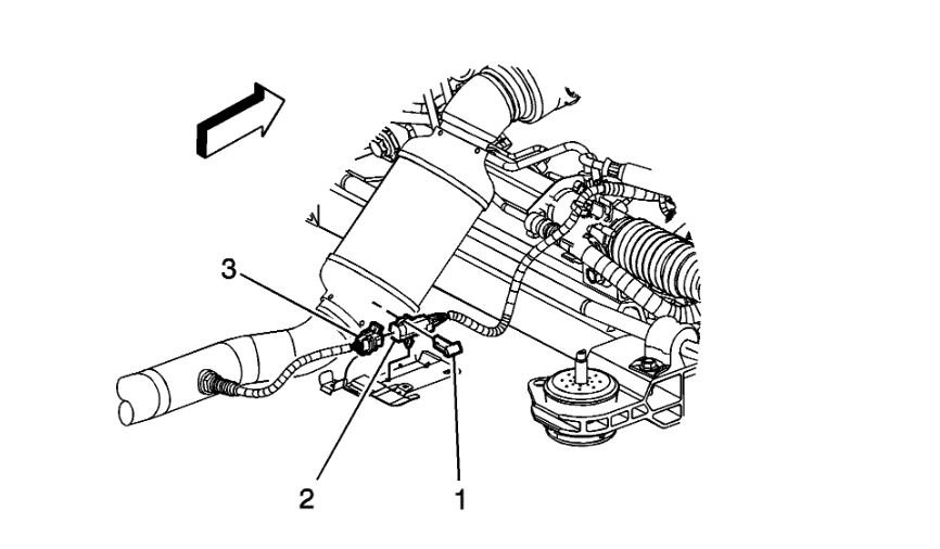

  • 52,797 POSTS
Good afternoon.
Codes do not tell you to replace anything. They just indicate the system that has a fault.
Can we start with the codes?
Your car has 2 sensors and the catalytic converter is a direct fit.
https://www.2carpros.com/articles/how-an-oxygen-sensor-works
I attached the location of the sensors and the catalytic converter for you.
