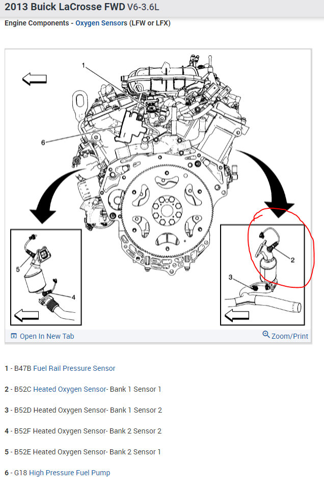

Hello, I am wondering where the bank 1 sensor 1 location is on the car listed above. Is it closest to firewall or opposite side closest to front of the car?

The bank 1 sensor 1 located closest to the firewall. See diagram below for reference.
