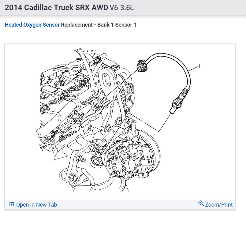

Where is the bank 2 sensor located?
Apr 28, 2019 at 9:29 AM
  • 110,244 POSTS
Welcome to 2CarPros.
When you open the hood, bank 2 is the one right up front. The rear is bank one (near the firewall).
Here is a guide to help walk you through the steps with the location of all oxygen sensor in the diagrams below
https://www.2carpros.com/articles/how-to-replace-an-oxygen-sensor

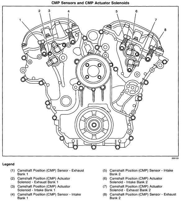

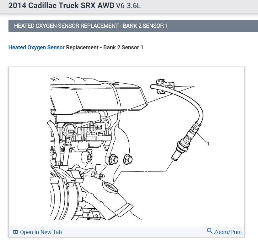

So there are two on the left side up front. I had an error code P0021 Bank 2 camshaft timimg over advanced bank 2
Apr 29, 2019 at 7:43 AM
  • 110,244 POSTS
Welcome back:
Take a look at the attached picture. It shows where the sensors are located. Bank 2 is on the right side of the engine when facing the front of the engine. There is a legend at the bottom of the picture identifying each component
Let me know if this helps. By the way, the pic is specific to your vehicle.
