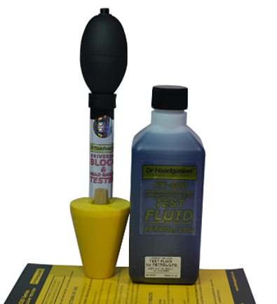

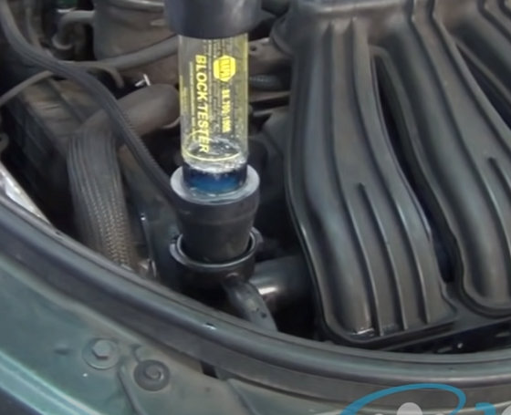

It sounds like the engine might have a leaking head gasket.
The best way to test for a leaking head gasket is using a chemical test. The liquid reacts to carbon monoxide and changes color from blue to yellow/green.
How to test for a leaking head gasket.
Please let us know how you get along.

Head gasket is intact. Did the simple test none of it shows blown heads.
