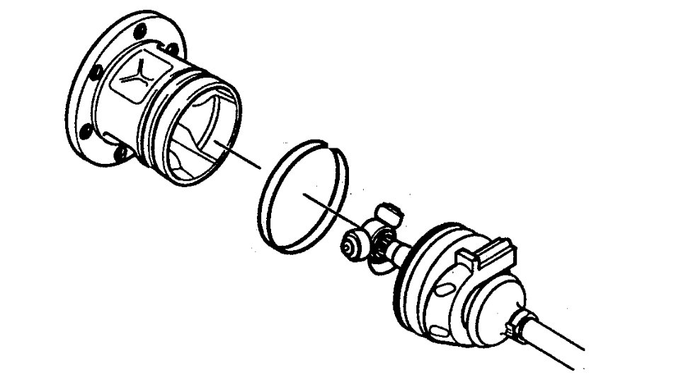

When i was trying to replace the upper ball joint i took it out of the control arm first and than the knuckle fell. i went to put it back up in the control arm and now it wont go back in and stays at an angle. i think i pulled the CV shaft out too far when it fell out.

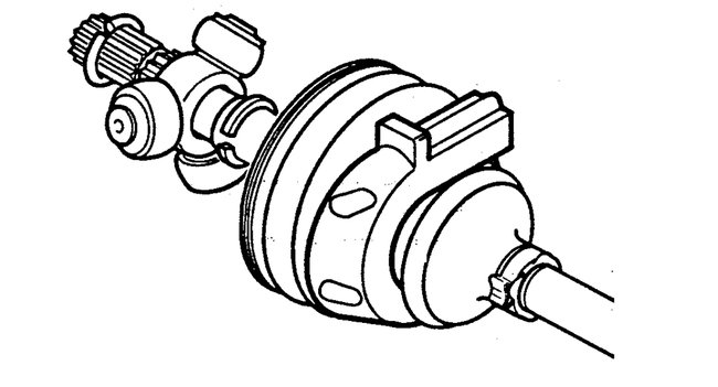

I found a picture of the inner joint which is the most common for coming out.
The axle would have to be removed to put it back together.

I sent a diagram for you about how it is set up.
You will not be able to get the suspension back together until you get the inner joint back together.
