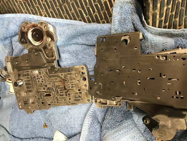

I am replacing the seal annoyed in the transmission and when I took the plates off that’s in the pan there were two ball bearings Ashley for ball bearings in there that came out and I need to know which ones go where to put it back together.

Can you upload an image of the ball bearings? There are check balls in the valve body, is this what you are talking about?

Yes, the balls in the valve body.

This is what I’m looking at.

Got it! thank you. Okay, there are large and small check balls, here are the locations for them. Check out the images (below). Let us know if you need anything else.
