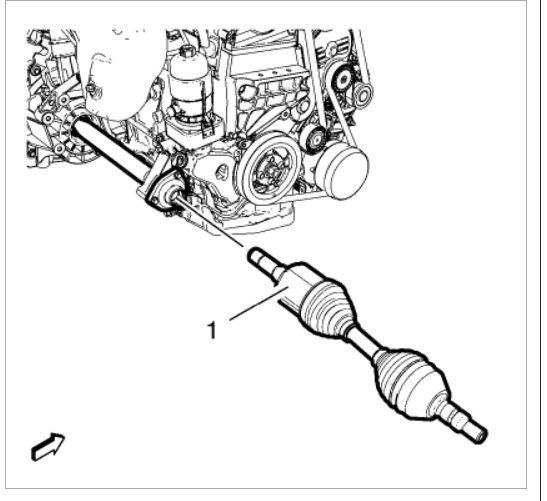

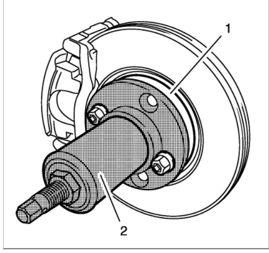

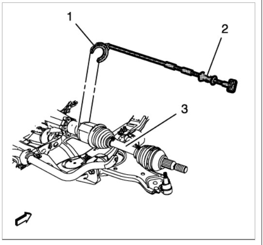

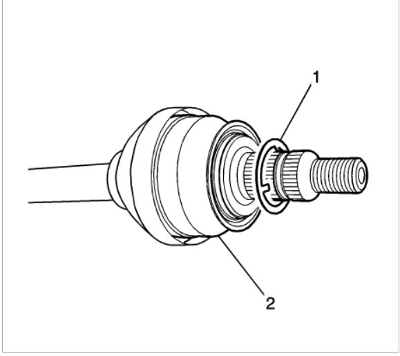

It sounds like you have a CV axle that has come apart. To confirm the failure you will need to raise the car up safely.
Here is a guide of what it will take to replace the the CV axle:
https://www.2carpros.com/articles/replace-cv-axle
Here is how it will be like for your car:

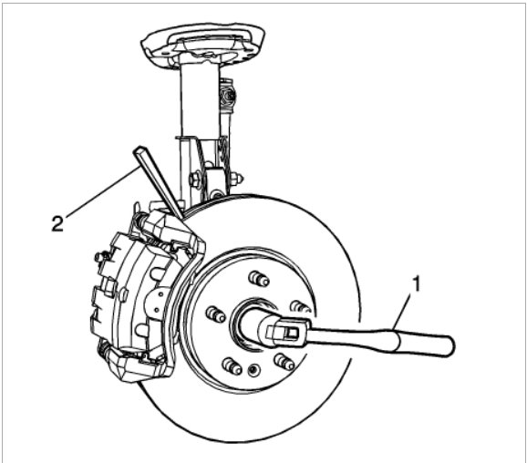

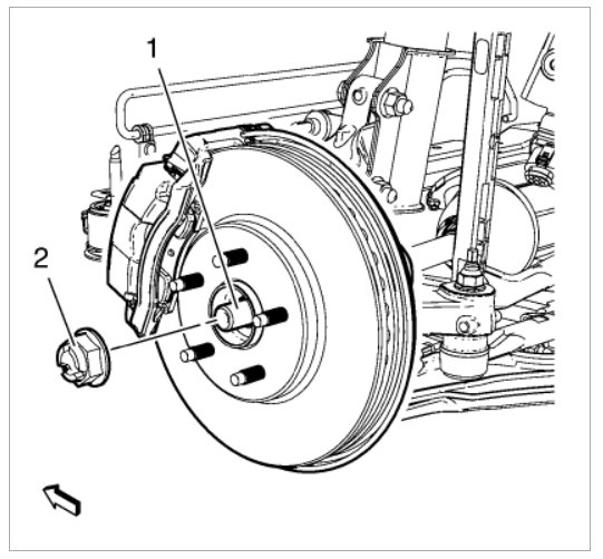

Using a torque wrench (1) and the appropriate size socket, tighten the wheel drive shaft nut to 150 Nm (111 lb ft) .
Release the wheel drive shaft nut (2) trough 45 degrees .
Retighten the wheel drive shaft nut (2) final pass to 250 Nm (185 lb ft) .
Install the tire and wheel assembly. Refer to Tire and Wheel Removal and Installation See: MaintenanceWheels and TiresService and Repair.
Lower the vehicle.
Diagrams (below).
