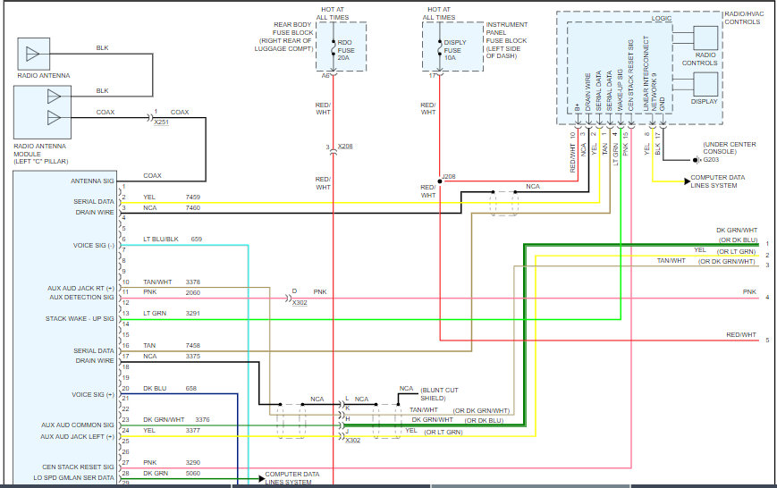

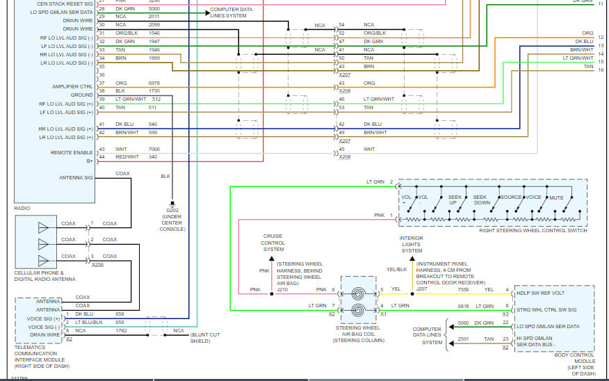

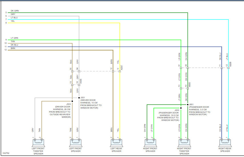

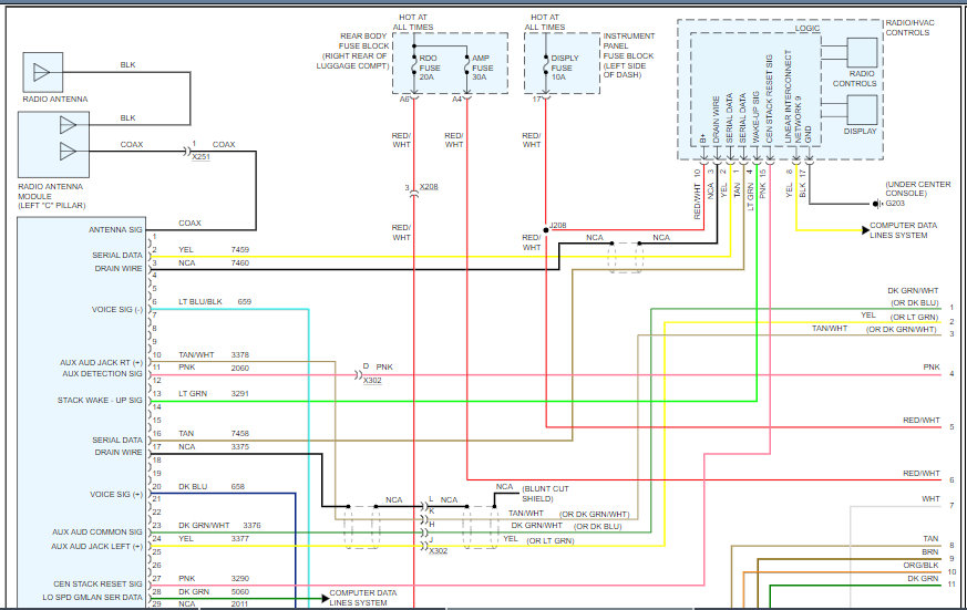

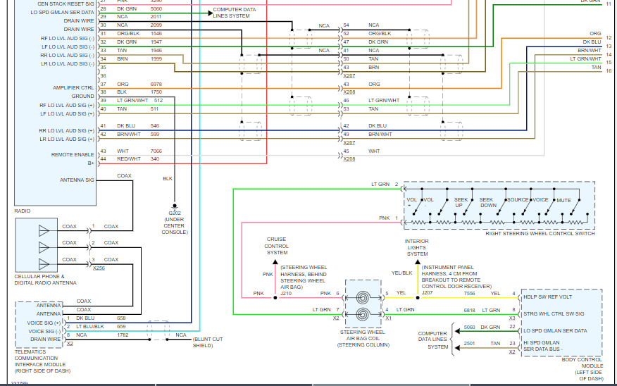

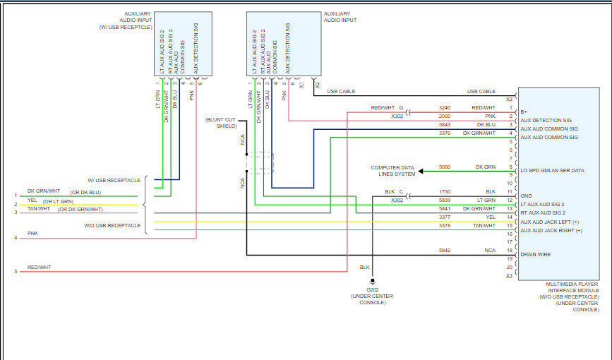

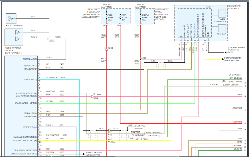

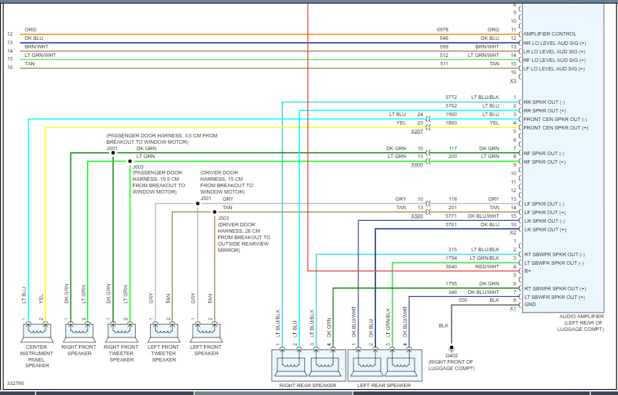

Is it possible to set balance control on the radio? I need the radio wiring diagrams please.
Jul 25, 2020 at 10:53 AM
DANNY L
  • 5,648 POSTS
Hello, I'm Danny.

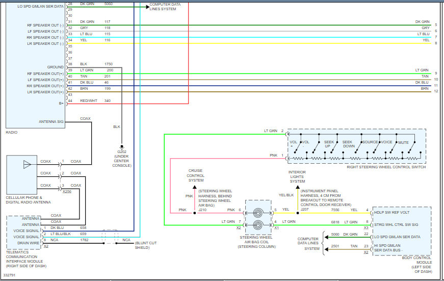

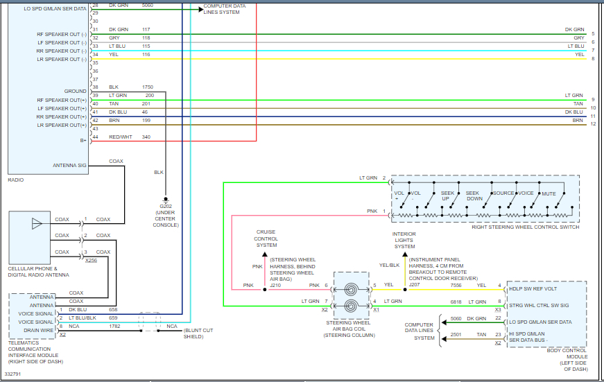

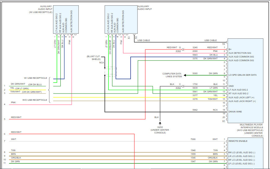

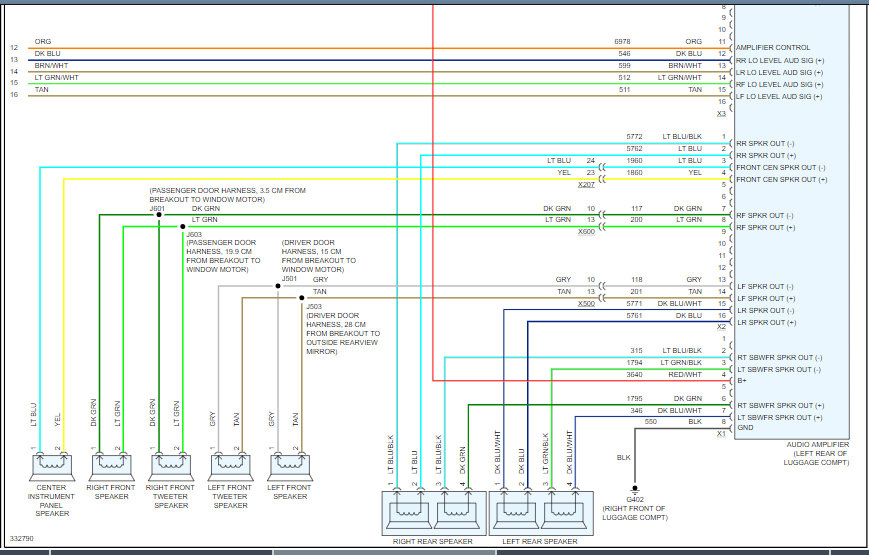

I've attached the radio diagrams you requested below for your car. I've cut the diagrams in half so you can view larger. The first 4 pictures are for the base audio system and the last 4 pictures are for the premium audio system. Hope this helps and thanks for using 2CarPros.
