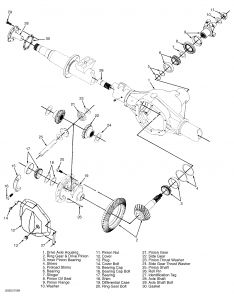

when i put my pickup in reverse or drive the rear differential will clunk like a bad ujoint but its not the ujoint its in the rear diff. how do i find out whats causing this noise? it seems to be getting louder so had to quit driving it.
Aug 29, 2020 at 4:47 AM (Merged)
DOCFIXIT
  • 18,828 POSTS
Hi Most likely worn pinion gear and bearing also possible ring gear worn. Jack up both rear wheels off ground in neutral rotate driveshaft in one direction till wheel moves then reverse till wheel turns note amount of play if more than 1/2 inch thenworn diff. parts. Hope this helps Thanks for donate

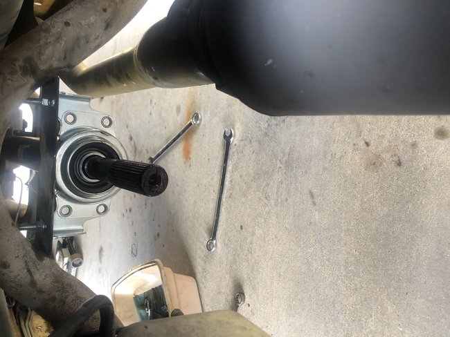

Replaced all three u joints and center bearing. I reinstalled the same design (batwing) style center bearing that was on the truck. I made note of the direction of the bracket before removing and installed the new one the same. I have since looked at several videos and noticed the flat part of the bracket facing the rear whereas mine has the flat part facing the front. Everything appears lined up, I just need to know if this is an issue or if it really doesn't mater as far as direction.
5123321055
  • 16 POSTS
Update: was able to pull up previous pictures of my truck and it is in fact backwards from how I took it out. It will destroy the bearing pressing it out to flip around so my question is, will it be okay or do I need a new bearing?
DANNY L
  • 5,648 POSTS
Hell, I'm Danny.
Question first.. Did you buy the assembly as a complete unit, Or did you press the new bearing into the new housing? As long as the bearing is not rubbing/interfering with any part of the front or rear slip yokes all will be good.Let me know and thanks for using 2CarPros.
Danny-
5123321055
  • 16 POSTS
Complete unit. There is no interference with either side and bearing freely spins.
DANNY L
  • 5,648 POSTS
Hello again.
You're good to go! Be sure to grease the splines for the slip yoke.. (driveshaft) Here is a picture of my 1997. Hope this helps and thanks again for using 2CarPros. Keep on truckin'
Danny-
