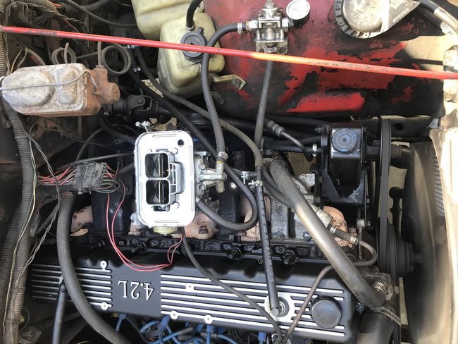

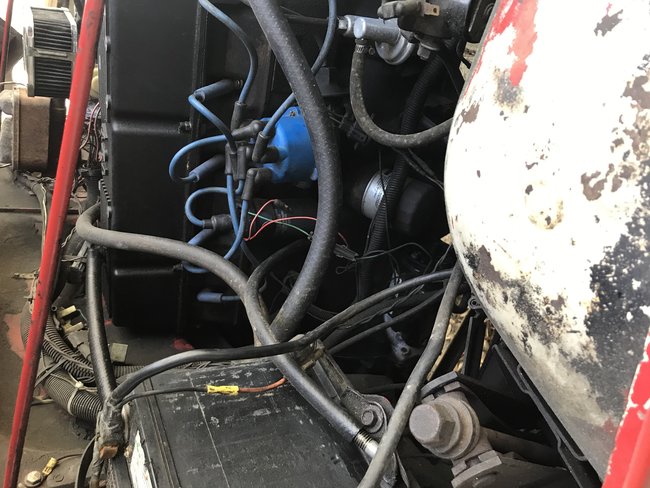

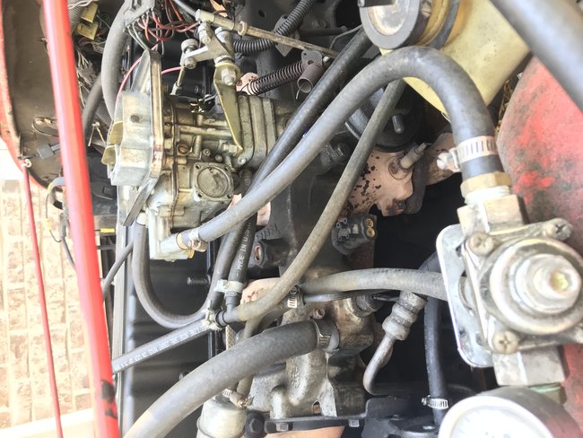

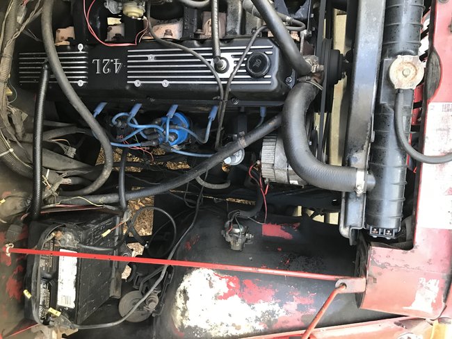

Pics. broke the dipstick tube so that’s my new one if you’re wondering what the heck? The rear hole in the valve cover is a dead end hose going beneath the battery for air. I was told to put a little air cleaner in that but haven’t gotten around to it. Just cleaned the terminals on the ignition coil and it seems to be cranking now! Is there a better connector online for that thing? Mines shot. But I would still like some suggestions on any issues you see in this engine bay mess.

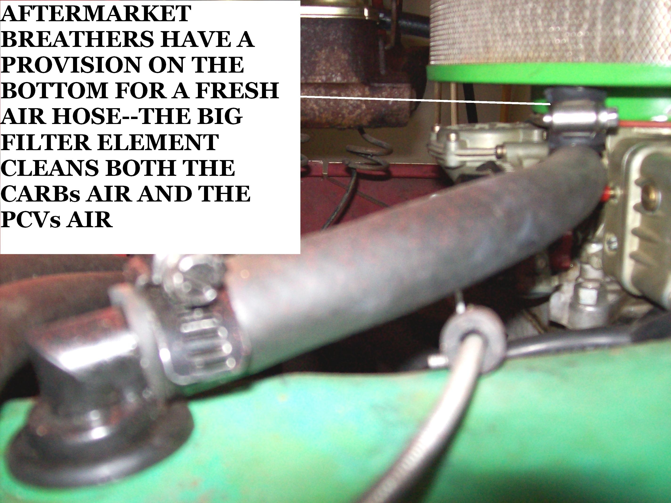

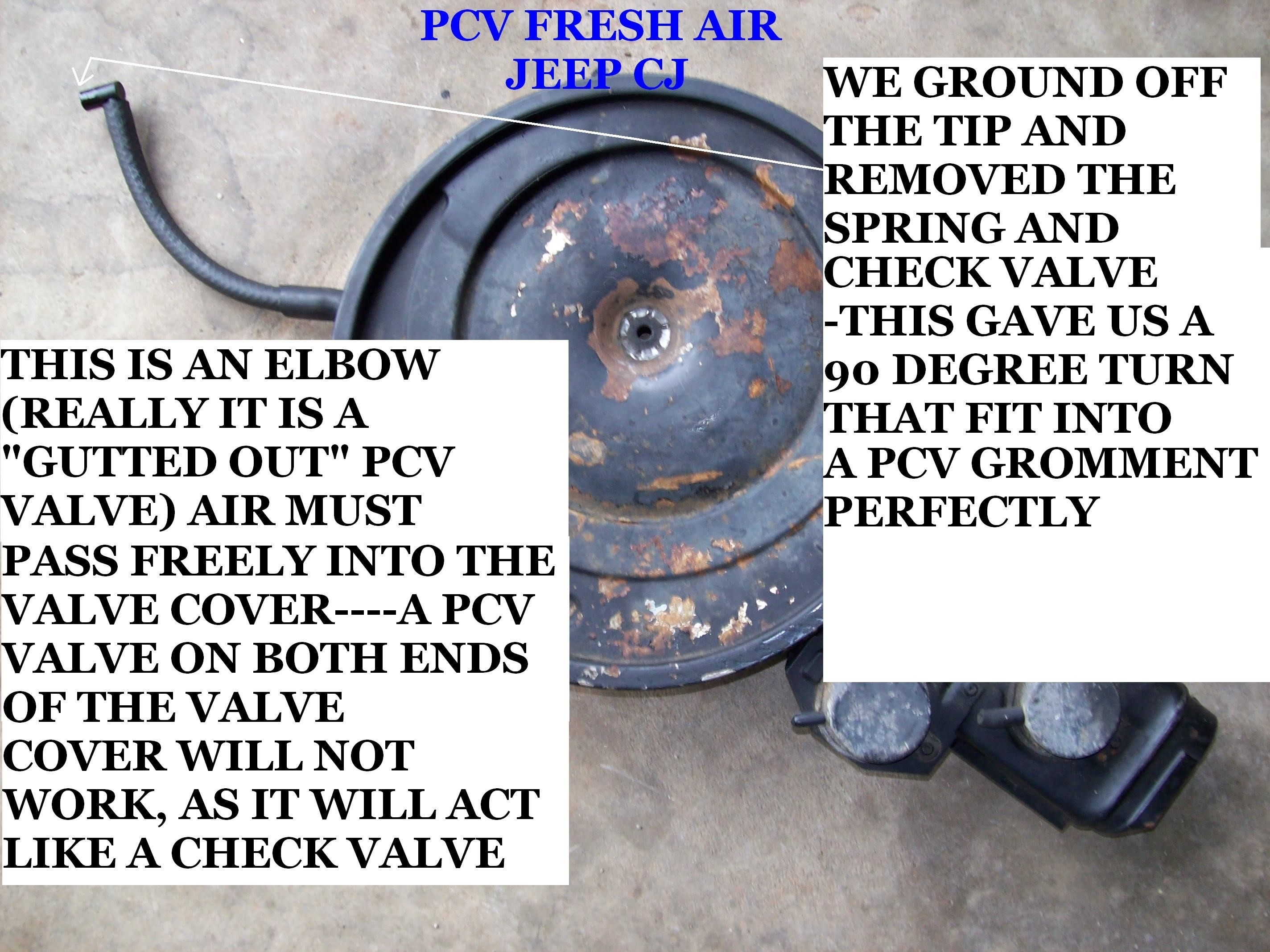

This may not be the correct size, but you can find one to fit into a grommet and just stick into the rear hole of the valve cover.
The idea is to keep the air clean and the "means" from getting stopped up.
https://shop.advanceautoparts.com/p/mr-gasket-open-element-breather-2049/17360161-P?searchTerm=air+cleaner+fo+valve+cover
I prefer the original way, back to the carburetor's breather. You can get fittings for the underside of the Weber's assembly to pipe it back in, thus drawing clean air from the carburetor's cleaner.
Picture below of drawing air off of my Holley's air cleaner.
I found this a while back and I stuck it in my favorites, although I'm quite happy with my Holley set up, I thought a Weber kind of person might benefit from it.
https://theprojectguyblog.wordpress.com/2014/03/21/weber-carburetor-installation-on-jeep-258/
