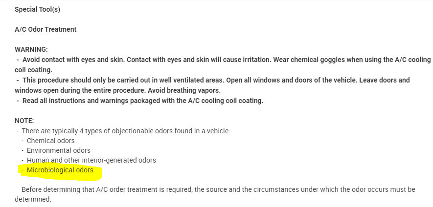

Wow, 9,000 miles. I would want to keep it too. As far as the odor, does it have a musty odor? Is the odor only noticeable inside the vehicle?
Do me a favor. Check the passenger side floor/carpet to see if there is any evidence of mold. The evaporator for the AC may have leaked and caused an odor.
Also, allow the vehicle to warm up and then open the hood to see if there is any evidence of the odor.

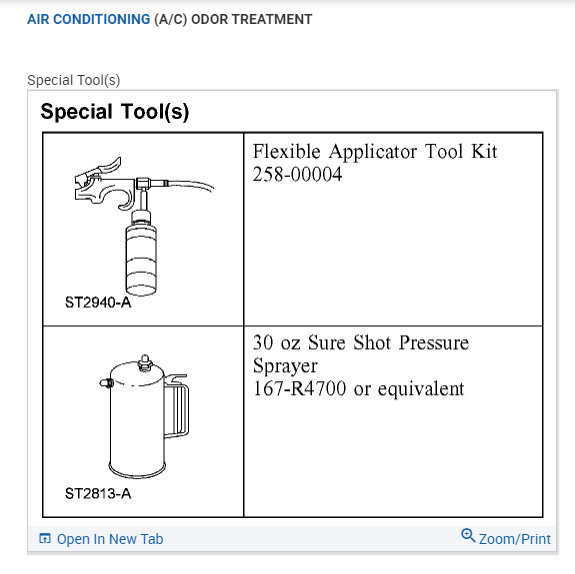

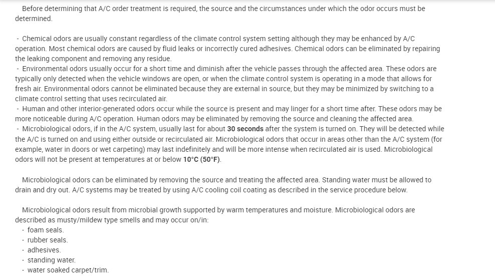

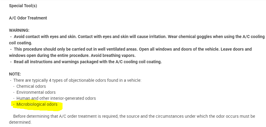

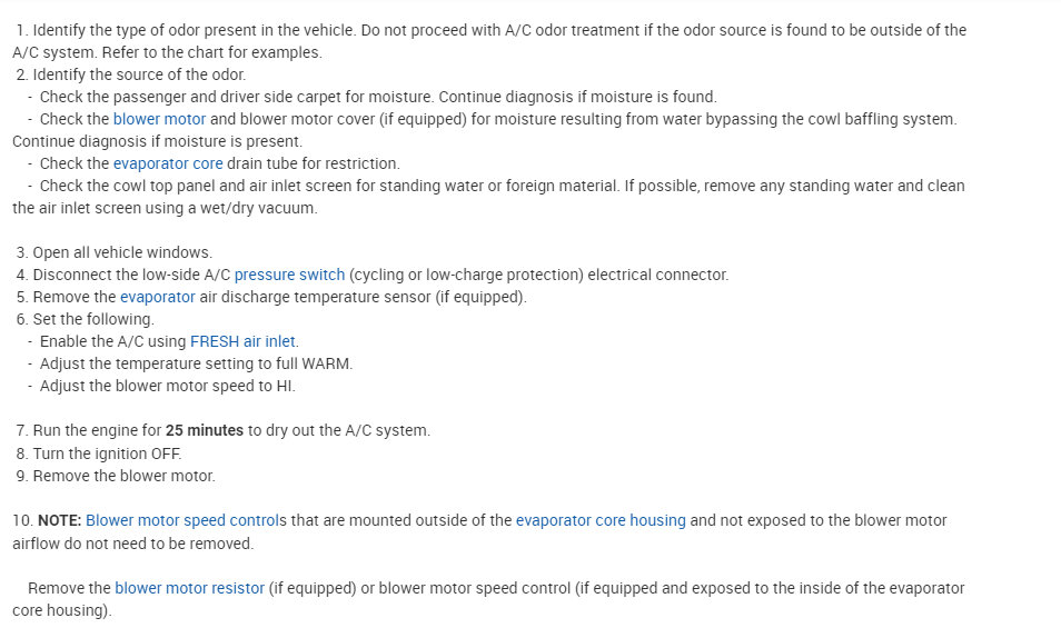

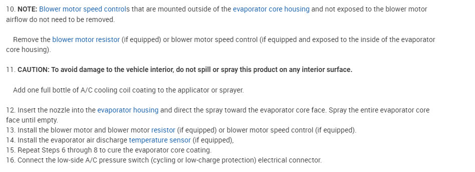

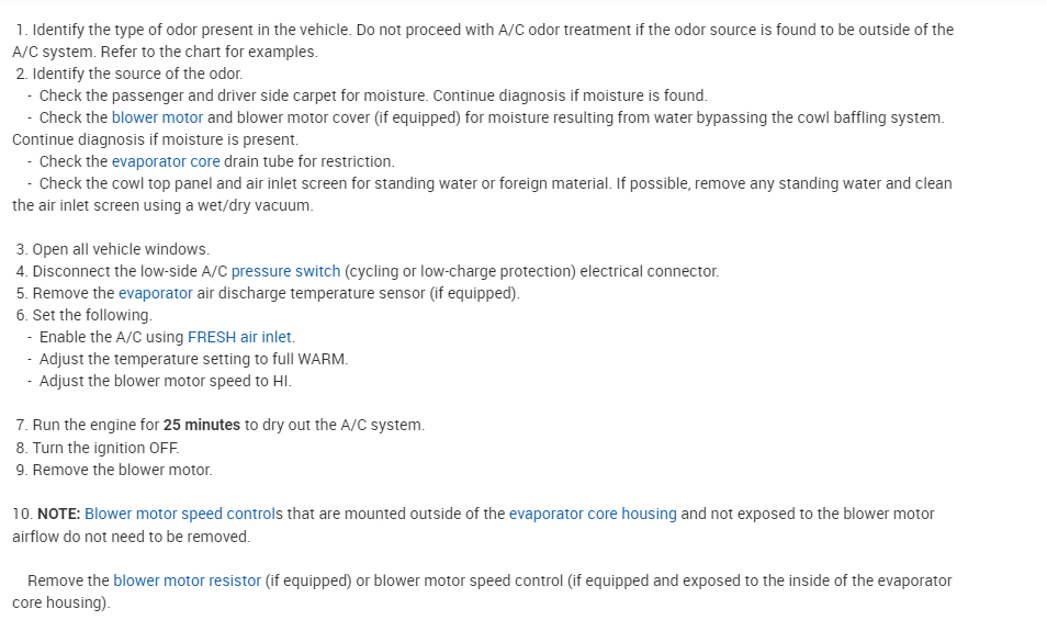

Additionally, I attached the procedure that a dealer would have followed when the vehicle was new. Take a look at it.
I do have one last question. Is there any chance mice may have gotten to the vehicle? They can make a mess and cause a strong odor. Check for evidence of that as well.
Let me know what you find.

The odor is not musty or mildewy to me. It is sharper smelling.
I see no evidence of mold in the areas you mention or anywhere else.
The car is on a charger right now as the battery has declined, but past experience has not located the smell in the engine compartment especially, it is much stronger inside the car.
As for mice, there is evidence in the engine compartment, and they have gotten into what I think is the AC intake through a plastic grill. The detailing shop I took the car to pointed this out and cleaned the intake as best they could without disassembling anything and I believe that this could be at least part of the problem, but I am kind of familiar with rodent odors and while there are similarities the odor I smell is very distinct and differs from only mouse odor. Also, the smell was there only days after Dad took delivery of the car and I don't think mouse odor would become that bad that fast. But I don't know.
If the ducting contains the problem, what can be done to correct it? Major disassembly or a flushing as the documents you provided suggest? A Mechanic suggested spraying an entire can of Lysol into the ducting intake but I won't do that. I think it might make things worse.

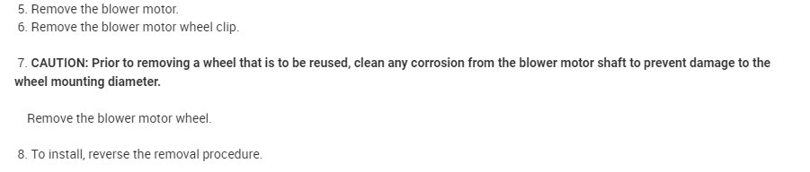

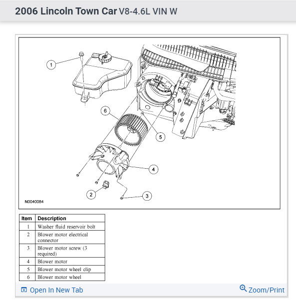

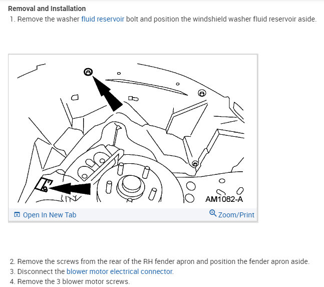

If no one has done it yet, remove the blower motor so you can see into the HVAC box. It really isn't too difficult to do.
If you look below, I attached the directions for removing it. At least this will let you see inside the box to determine if there is something inside.

To remove the HVAC blower, I will have to remove the front wheel in order to reposition the fender apron. Not very convenient for me but I will try. I will let you know the results.

I removed the HVAC blower motor, and the cavity looks clean and clear excepting a light tan film. No obnoxious smell either other than the ever-present background smell. Is there any more for me to check here before reassembly?
