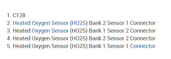

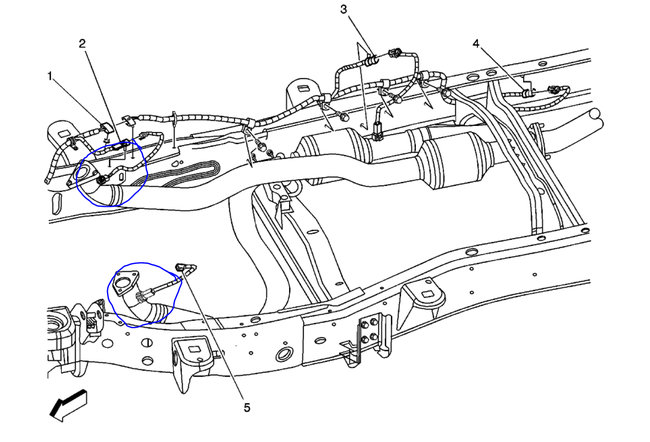

I need to change oxygen sensor bank 1 and oxygen sensor bank 2 but I don’t know where they are located. Could someone please tell where they are located?
Feb 12, 2021 at 12:38 AM
Good morning,
I posted the location and procedures for replacing the sensors.
https://www.2carpros.com/articles/how-an-oxygen-sensor-works
https://www.2carpros.com/articles/how-to-replace-an-oxygen-sensor

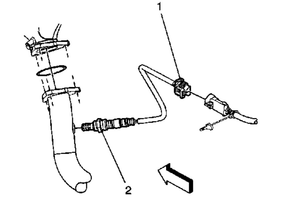

HEATED OXYGEN SENSOR (HO2S) REPLACEMENT BANK 1 SENSOR 1
TOOLS REQUIRED
J 39194-B Oxygen Sensor Wrench
REMOVAL PROCEDURE
1. Raise the vehicle.
CAUTION: Refer to Vehicle Lifting Caution in Service Precautions.
2. Disconnect the connector (1) for the HO2S.
NOTE: Refer to Heated Oxygen and Oxygen Sensor Notice in Service Precautions.
3. Remove the HO2S (2) using a J 39194-B.
NOTE: Refer to Excessive Force and Oxygen Sensor Notice in Service Precautions.

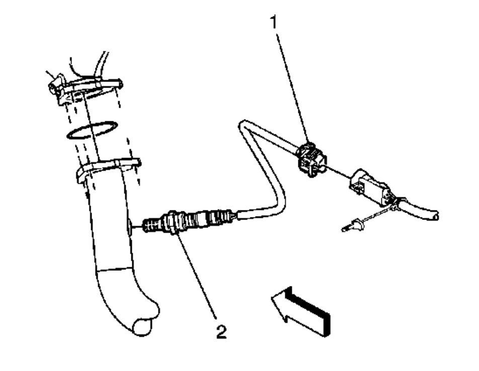

HEATED OXYGEN SENSOR (HO2S) REPLACEMENT BANK 2 SENSOR 1
TOOLS REQUIRED
REMOVAL PROCEDURE
