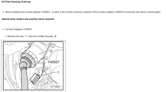

Bad oil leak from behind oil filter housing.
2006 VOLKSWAGEN JETTA
165,000 MILES • 2.5L • 5 CYL • 2WD • MANUAL
CMCFARLAND
Not sure how to remove the oil filter housing in order to replace that gasket.
Leaking oil under pressure quite badly.
Thanks!

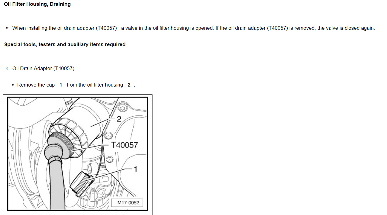

http://fkh161.ca/VW/OilFilterHousing.pdf
Oil Filter Housing, Draining
When installing the oil drain adapter (T40057) , a valve in the oil filter housing is opened. If the oil drain adapter (T40057) is removed, the valve is closed again.
Special tools, testers and auxiliary items required
Oil Drain Adapter (T40057)
Remove the cap - 1 - from the oil filter housing - 2 -.
Hold the hose from the oil drain adapter (T40057) in a container and install the oil drain adapter (T40057) onto the oil filter housing - 2 - until it stops.
Allow the engine oil to drain.

He wants to replace the #3 seal in the above pdf... no need to remove the filter with the Assenmacher tool.
Thomas

Thanks didnt catch that just remove whole housing and replace the number 3 seal and you will be good to go.
