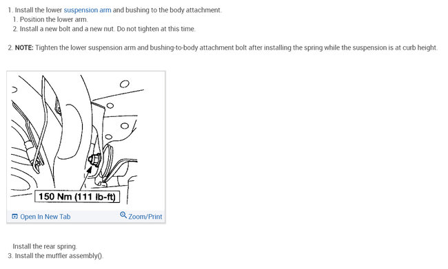

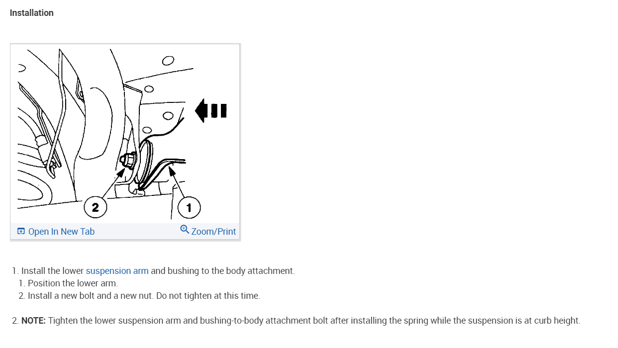

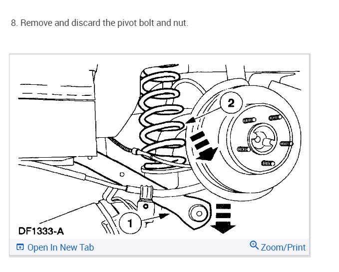

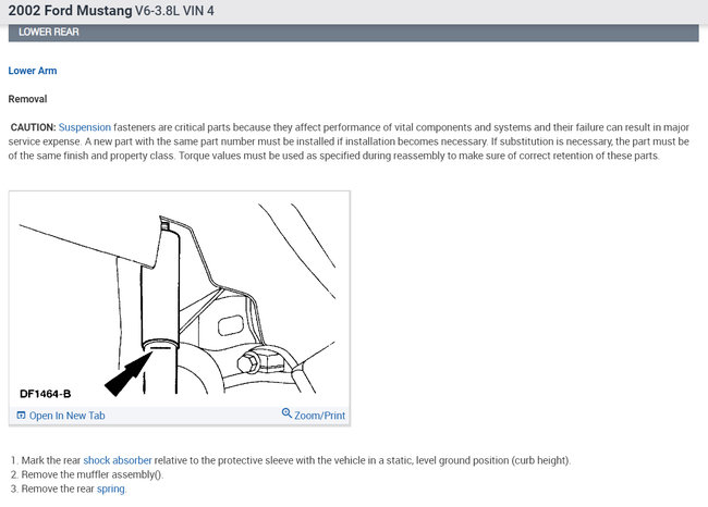

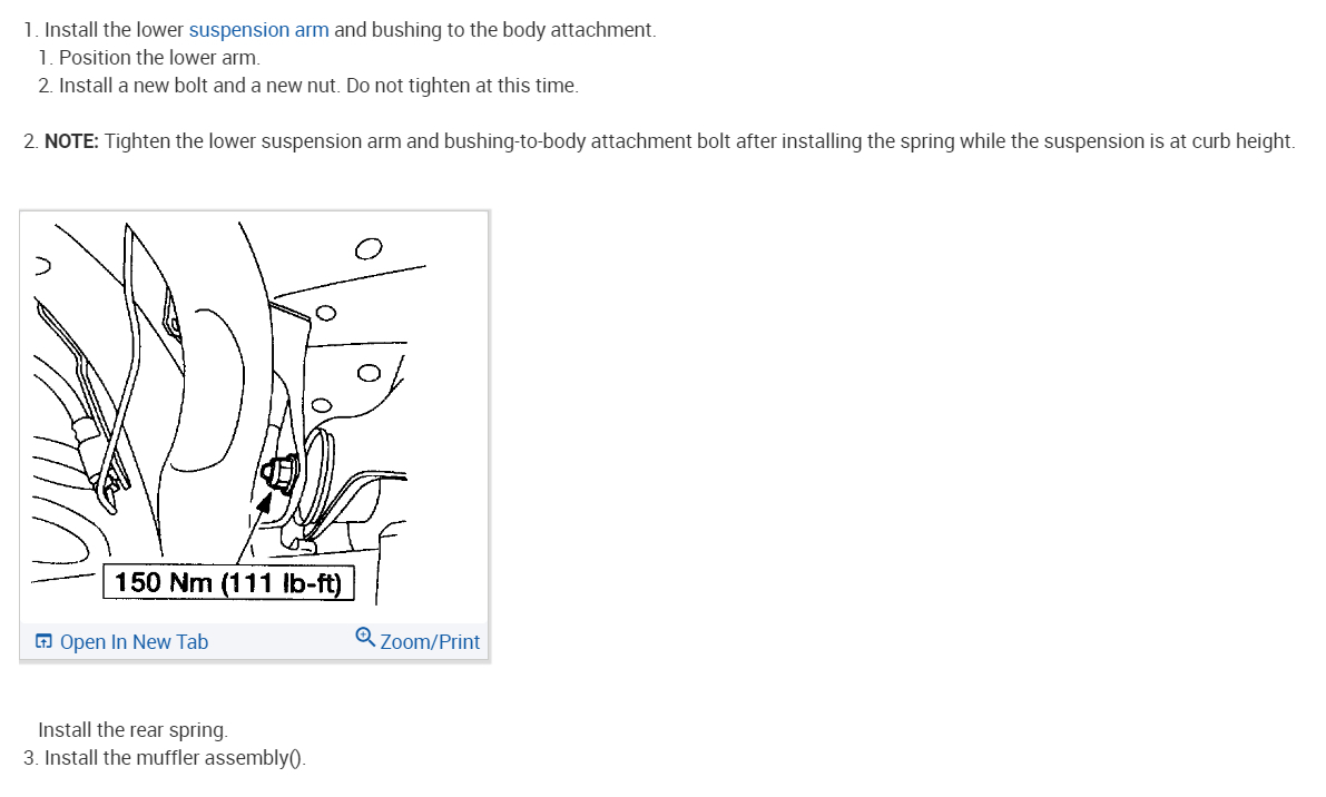

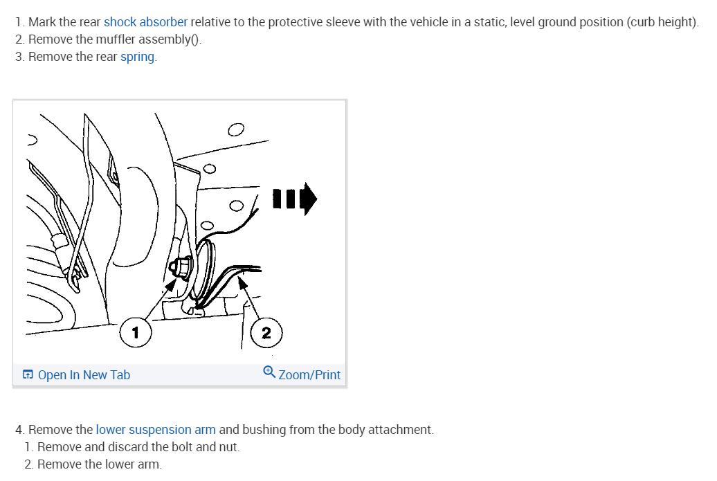

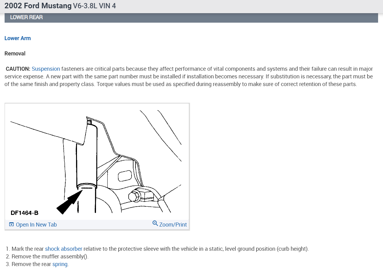

If we could hear the noise, it would be better, please shoot a quick video with your phone so I can hear the noise. That way I can tell for sure what's going on. You can upload it here with your response. In the meantime, let's lift the rear of the car and use a flashlight to see if you can tell if something is broken or worn out.
Here is a guide to help:
I have included diagrams so you can see what to look for. Check out the diagrams (below). Please let us know what you find. We are interested to see what it is.
