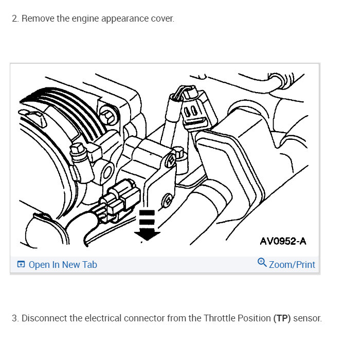

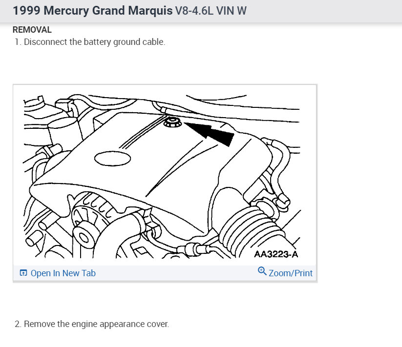

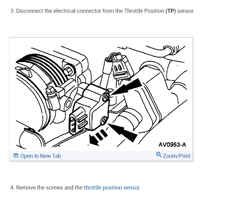

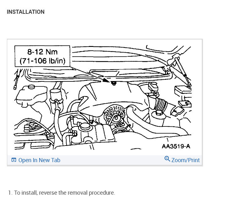

I have seen the TPS sensor not respond so the computer does not know the throttle is being opened. You can use a voltmeter set to OHMs to check it. here is the location. Also see if the fuel pressure is stable when the throttle is opened.
Also make sure the grounds are clean and tight to the engine harness. Do you have the code numbers? Check out the images (below). Please let us know what happens.
