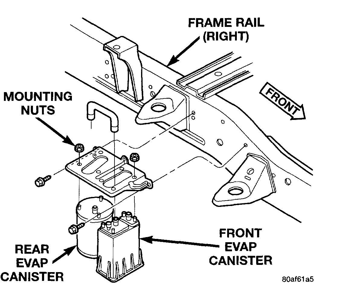

Engine misses when just cruising no load, but pulls good under full throttle. engine code shows different cylinder misfire every time it happens so not always the same one. new computer year ago new catalytic converter and exhaust.

Are there any additional codes other than a misfire? Next, have you checked fuel pressure to make sure it isn't too high or too low. Also, have you checked for engine vacuum leaks?

no other codes. I am retired and only have a cheap scan for codes. fuel pressure gauge test is okay. have not done vacuum test.

think maybe i found the problem. i guess the last time we went up on mountain to get fire wood we pulled the fuel vapor canister off on some sage brush it is down under the back corner of the cab. will have to get a new one and try it.

That certainly will create a vacuum leak. Also, there should be two canisters there. Here are the directions for replacing them. The attached pic correlates with the directions.

1999 Dodge or Ram Truck RAM 1500 Truck 2WD V8-5.2L VIN Y
Procedures
Vehicle Powertrain Management Emission Control Systems Evaporative Emissions System Evaporative Emission Control Canister Service and Repair Procedures
PROCEDURES
EVAP Canister Location
see pic 1
Two EVAP canisters are used. Both canisters are mounted to a bracket located below rear of vehicle cab on outside of right frame rail.
REMOVAL
1. Remove fuel tubes/lines at each EVAP canister. Note location of tubes/lines before removal for easier installation.
2. Remove mounting nuts at each canister.
3. Remove each canister from mounting bracket.
INSTALLATION
1. Place each canister to mounting bracket.
2. Install nuts and tighten to 9 Nm (80 in. lbs.) torque.
3. Install fuel tubes/lines to each canister.
