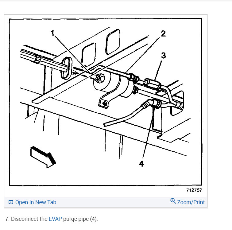

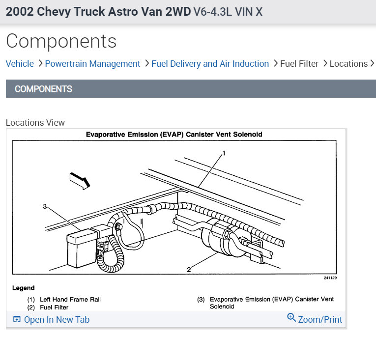

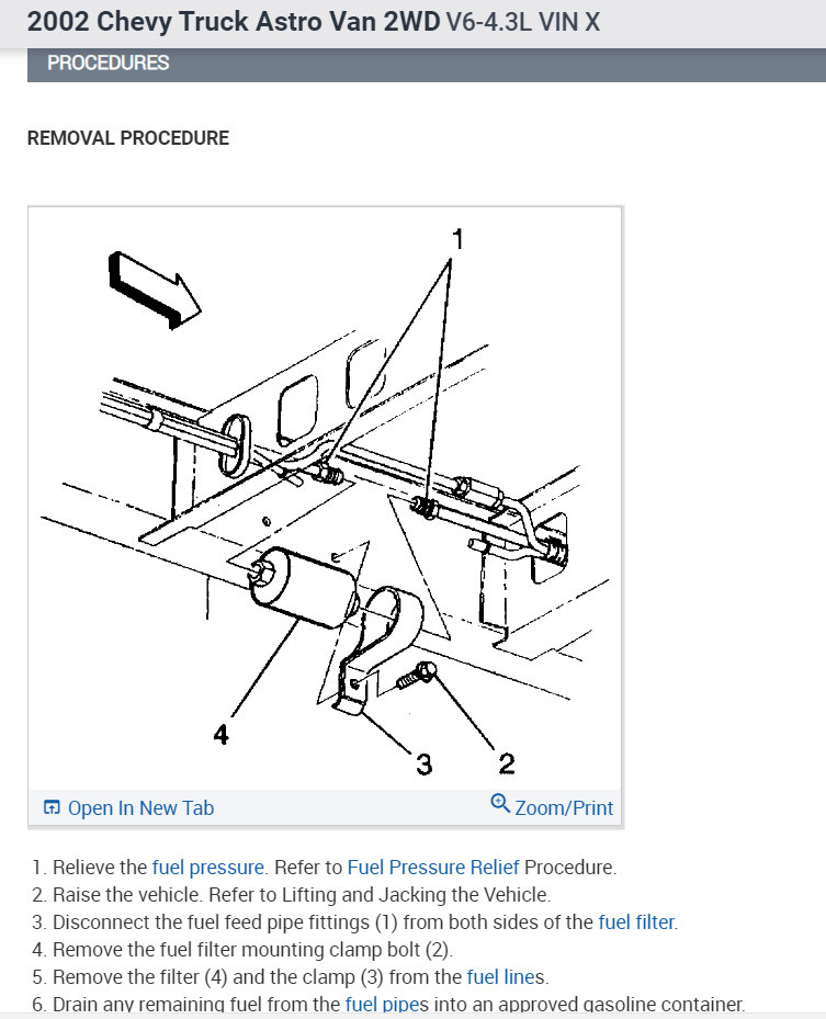

If the compression is good and the engine has fresh spark plugs etc., I would do a fuel filter because they can clog up limiting the amount of fuel getting to the engine.
Here is a video of the job being done and instructions in the images below for your car:
https://youtu.be/cMa2bp4jbNU
Clear the codes after the job is done. Check out the diagrams (below). Please let us know what happens.

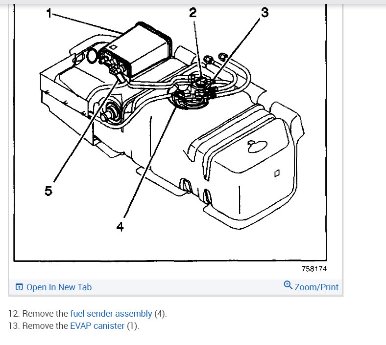

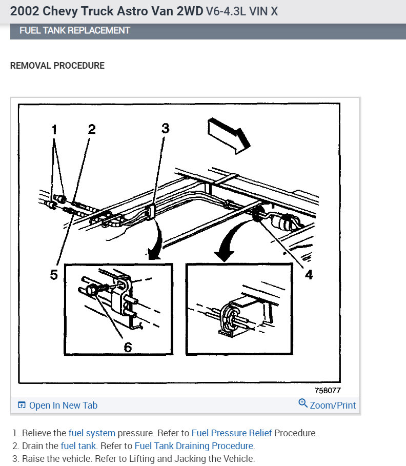

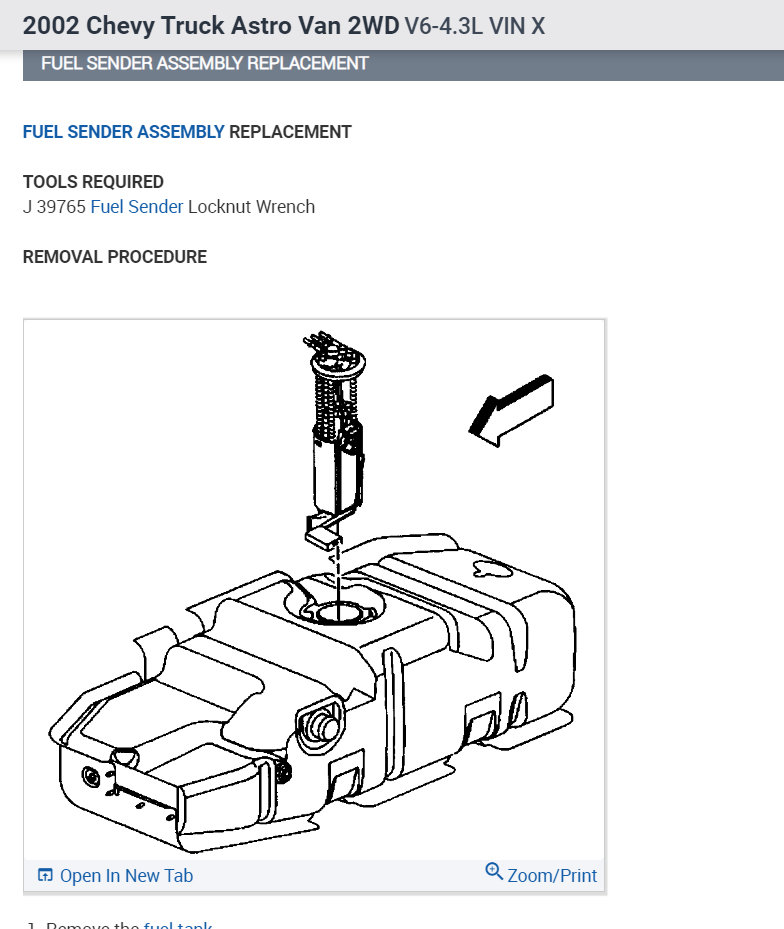

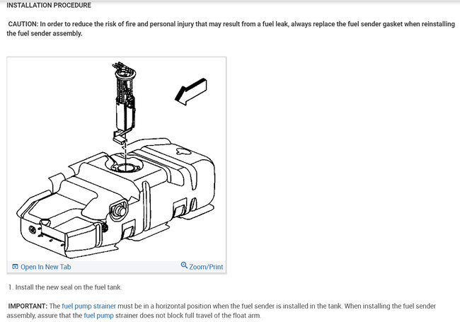

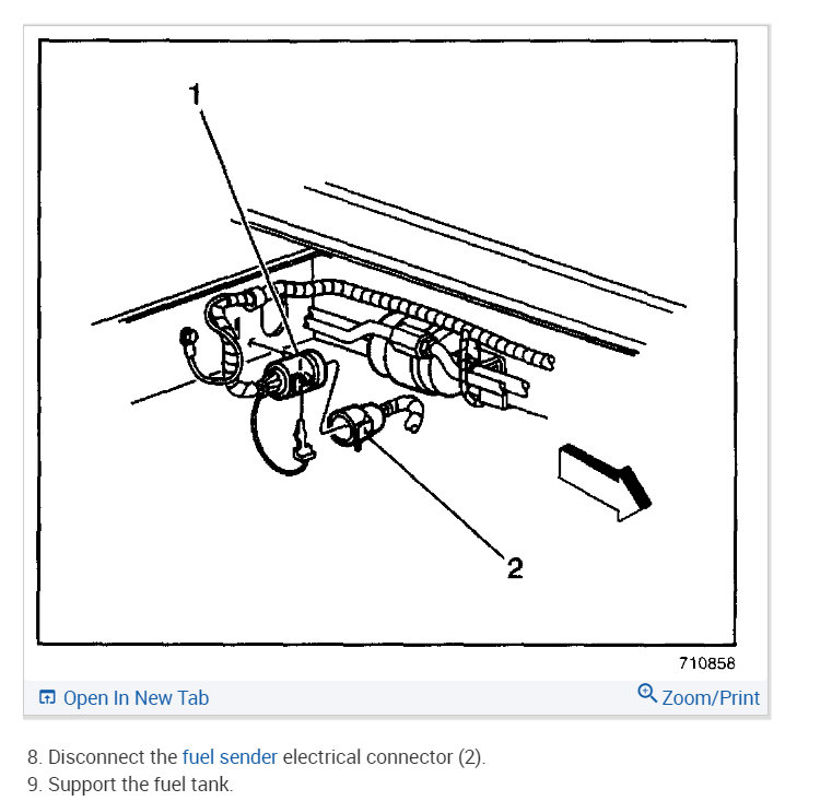

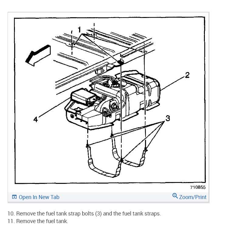

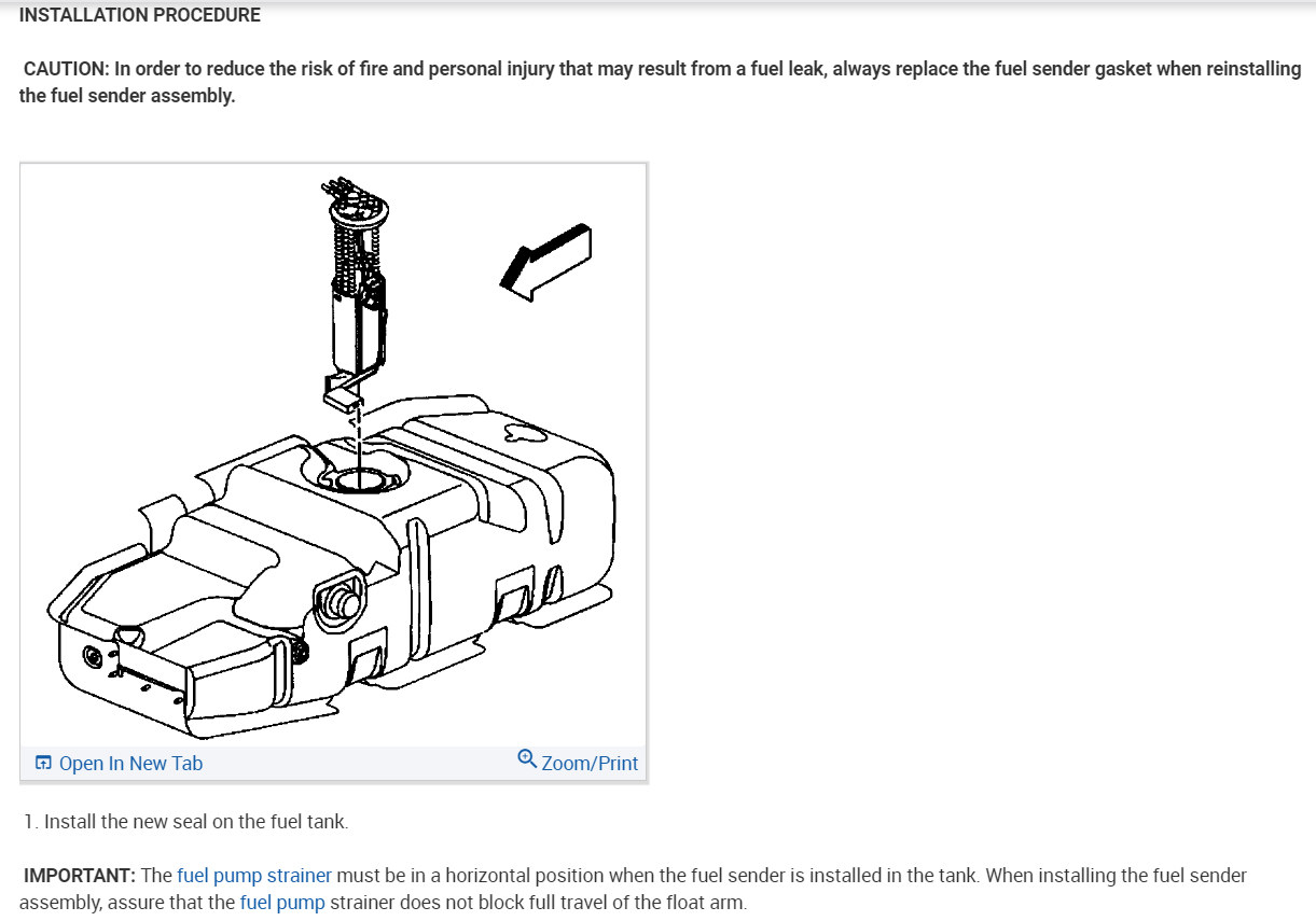

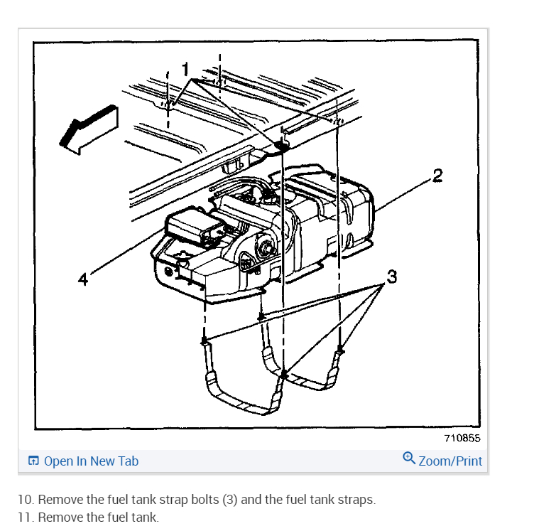

It sounds like the fuel pump is starting to go out. To be sure this guide can help you check the fuel pressure. I have also included how to change the pump out just in case in the images below.
Key On Engine Off .................... 55-62 psi
