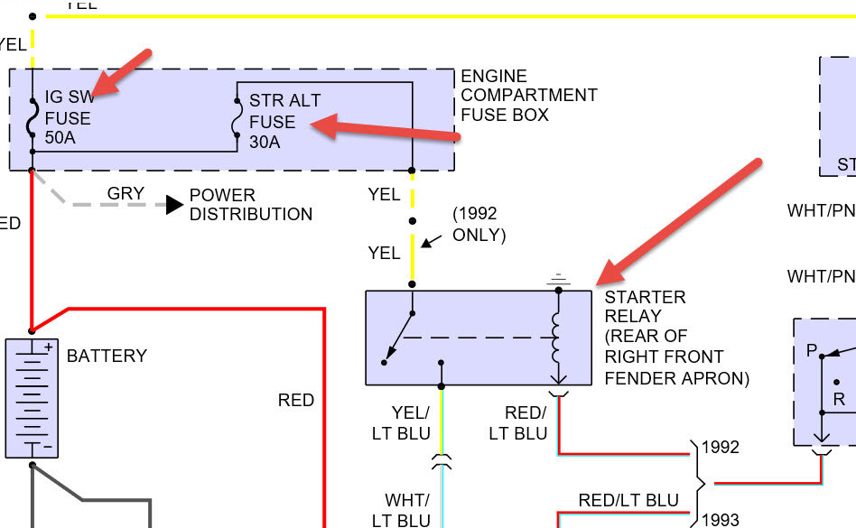

the starter and soilanoid have been replaced . everthing works good for a while. then the only way to start it is jump the soilnoid . when turn key ther is no sound

check items in pic then check to see if ignition switch is sending power through the neutral switch

This is from PUTZ-2015 who sent it through our contact system for some reason - "the solved the problem needs a ignition switch. thanks could you tell me where the headlight ground is on 2003 dodge caravan se Canadian model" The headlight ground is near the headlight housing down on the radiator core support, follow the wiring harness downward to locate
