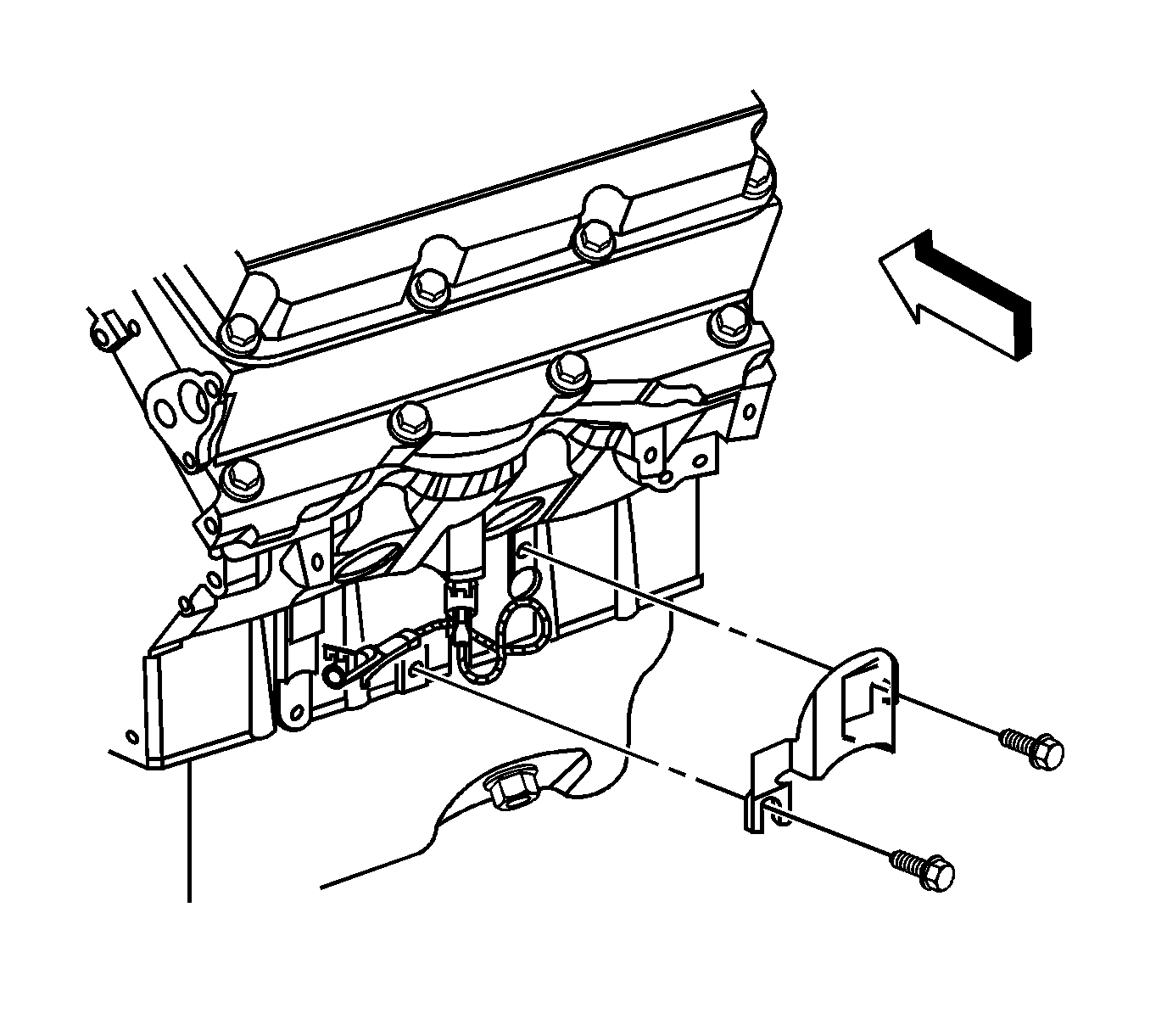

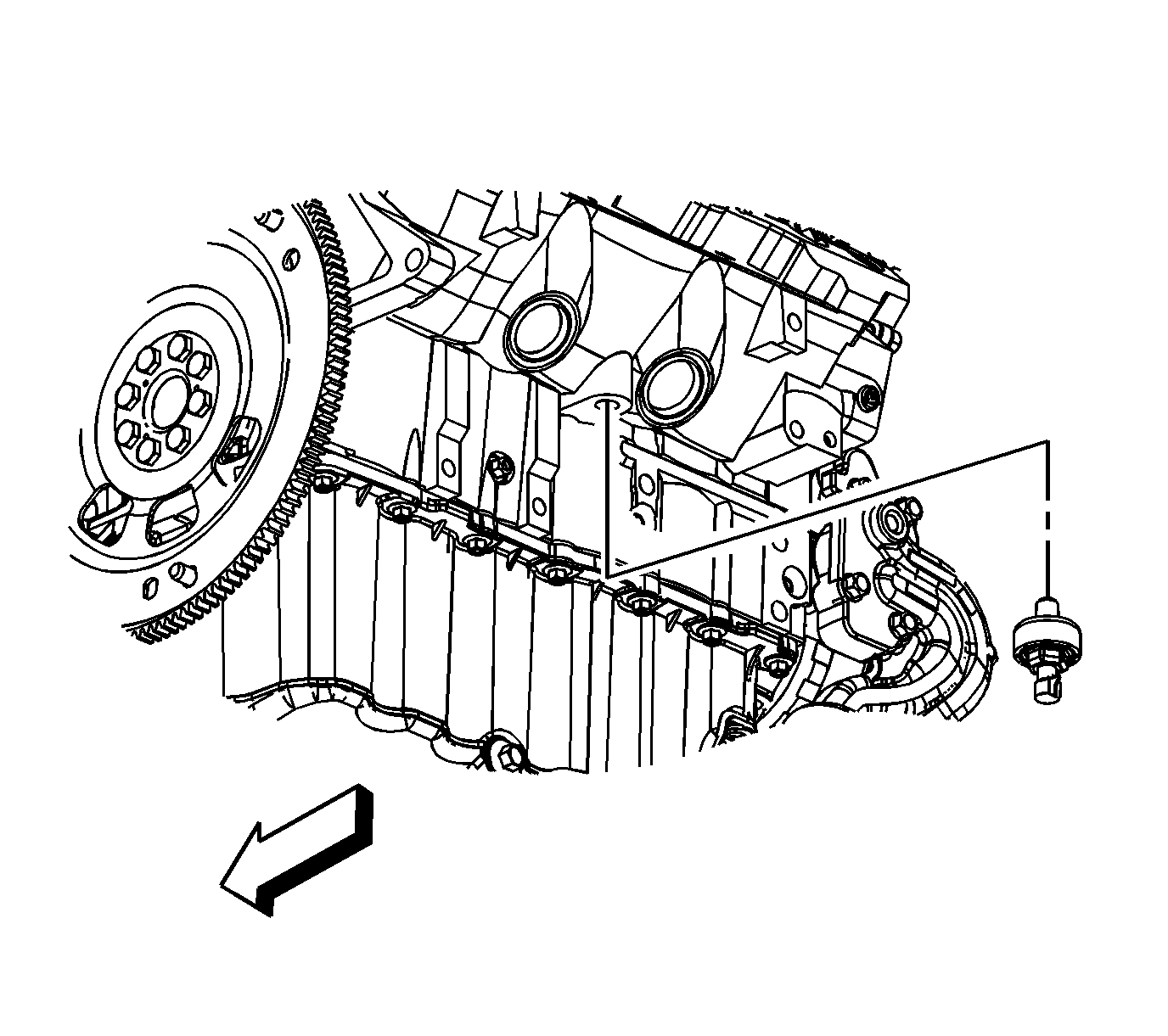

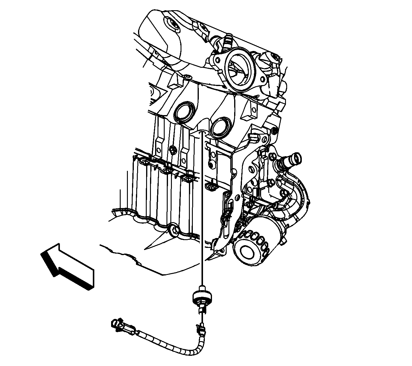

Trouble code P0332 knock senor 2 bank 2. i was trying to figure out where this sensor is located there is not much information on the internet about the location and i was hoping someone could help me out with this.

Here are the directions for replacing the sensor. The attached pictures correlate with these directions as well as show location.
KNOCK SENSOR 2 REPLACEMENT
Knock Sensor 2 Replacement
Removal Procedure
Caution: Hot engine coolant may cause severe burns. Although the cooling system has been drained, coolant still remains in the engine water jacket. This coolant will drain with the removal of the knock sensor.
picture 1
1. Remove the knock sensor heat shield bolts and shield.
picture 2
2. Drain the cooling system. Refer to Draining and Filling Cooling System (Static Fill) Draining and Filling Cooling System (Vac-N-Fill).
3. Disconnect the knock sensor wiring harness electrical connector from the knock sensor.
pic 3
4. Remove the knock sensor.
