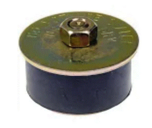

Hi Joe, well, got the freeze plugs done, but my mechanic is having issues with one still leaking coolant. Do you have any ideas how to stop it??
May 9, 2022 at 6:10 AM
  • 110,251 POSTS
If it is leaking, it may have bent when installation. If he can't get it to stop, I would suggest using an expandable rubber one.
I attached a pic below showing what I'm referring to. Let me know if that helps.
See pic below.
May 9, 2022 at 11:25 AM
