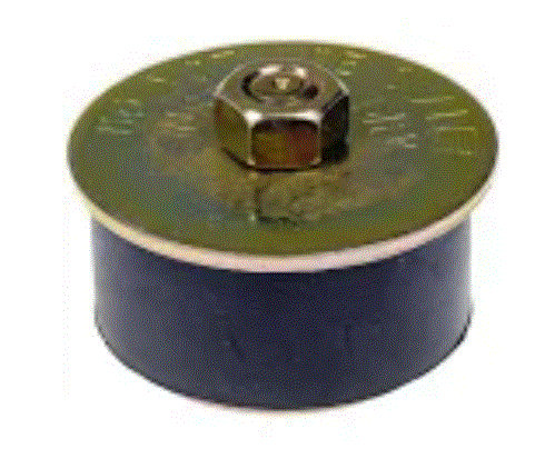

I have the car listed above MK2, I have changed plugs, HT leads, and coil pack I have checked for vacuum leaks. I am getting petrol on two of the spark plugs. When starting idle is at 1,200 then drops to 800 when I hit 50 MPH the car vibrates. No fault codes are coming up.

I'm not sure what you mean by getting fuel on the plugs. Also, do you have a live data scan tool? If you do, can you let me know what the short-term fuel trims are? Also, if you are seeing fuel on two of the plugs, that indicates they are not firing. Have you confirmed they are getting spark even though everything is new? Here is a link you may find helpful:

Hi Joe, thanks for getting back to me. I found out it's a core plug that needs replacing. Thanks for your help.

Hi Joe, well, got the freeze plugs done, but my mechanic is having issues with one still leaking coolant. Do you have any ideas how to stop it??

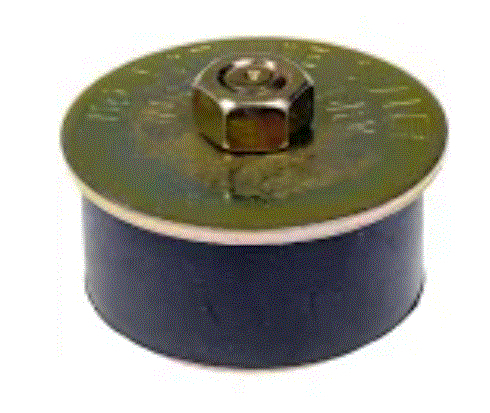

If it is leaking, it may have bent when installation. If he can't get it to stop, I would suggest using an expandable rubber one.
I attached a pic below showing what I'm referring to. Let me know if that helps.
See pic below.

I found out it wasn't fuel it was water from core plug/freeze plug.
