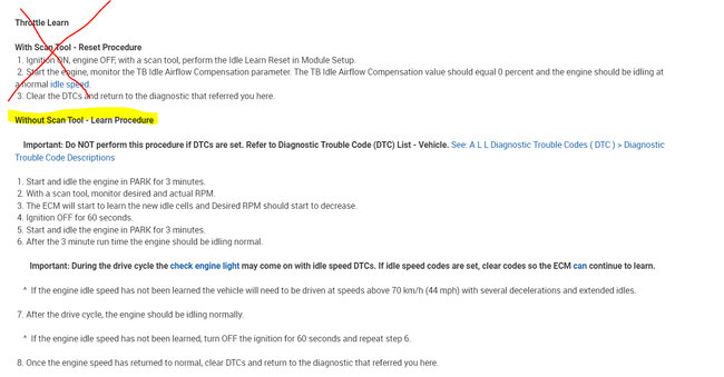

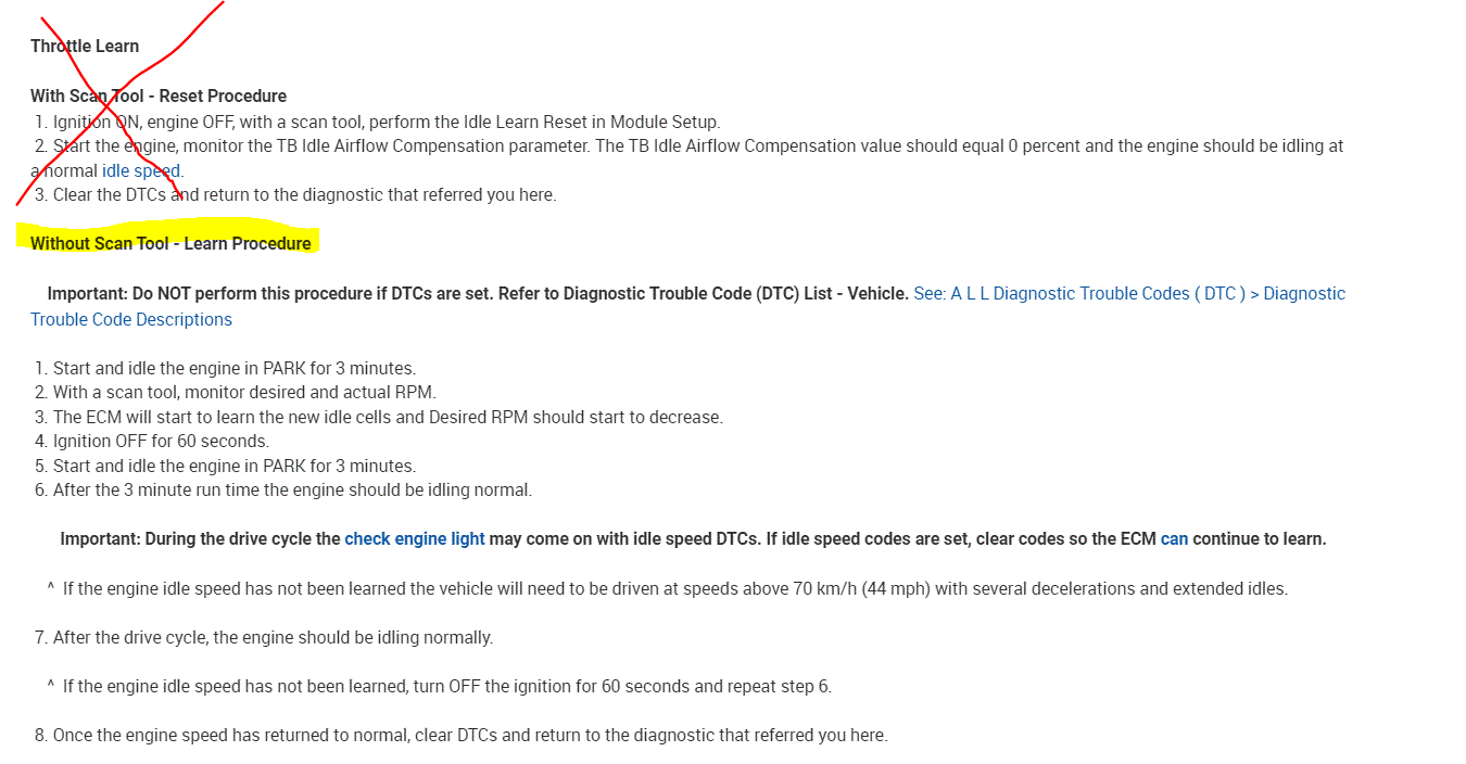

I did a little research, and although the manual has specifications for an IAC, it doesn't show one. So, you may be correct.
If there are no engine vacuum leaks, I looked for an idle speed relearn procedure. I found it. There is one with a scan tool and one without. To add insult to injury, the one for doing without a scanner tells you to watch the scan tool. LOL
However, I don't feel the scan tool does anything but show the RPM speed. Do me a favor. Take a look through the attachments and see if they help change the speed.
I will watch for your reply.
Apr 2, 2022 at 9:06 PM
STARLORD1976
  • 173 POSTS
Tried it twice still didn’t help.

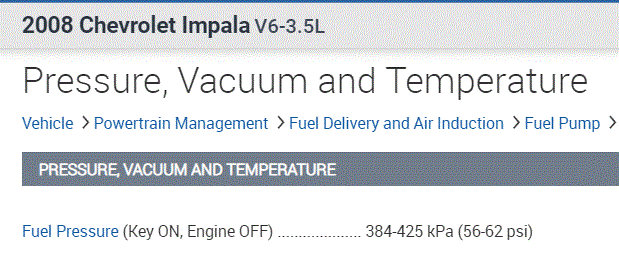

  • 110,194 POSTS
If it is running lean, either it is a vacuum leak issue or low fuel pressure. If you found no leaks, the next thing to check is fuel pressure to make sure it isn't low.
Here is a link that explains in general how it's done:
I attached the manufacturer's fuel pressure specifications below.
Let me know what you find.
