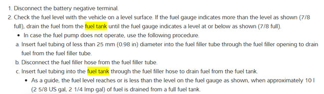

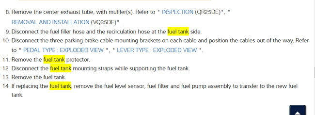

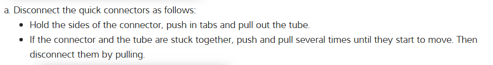

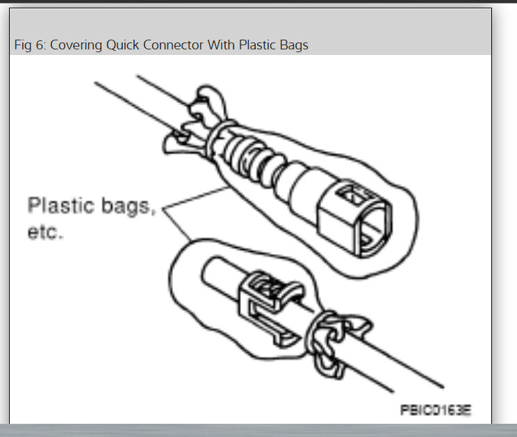

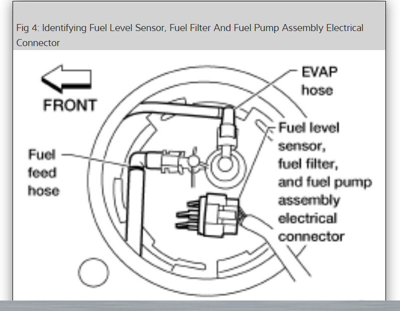

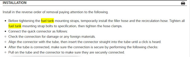

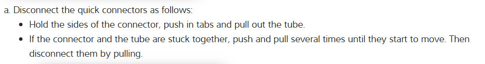

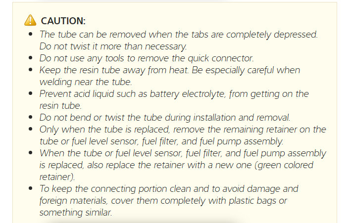

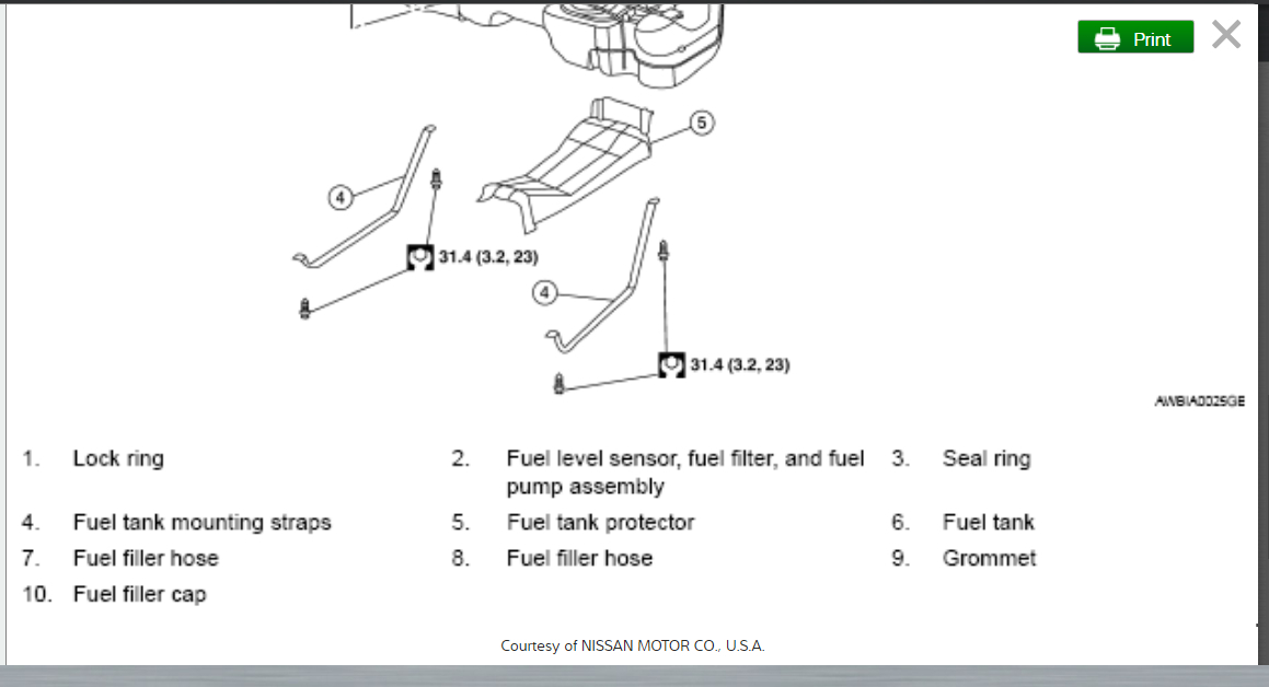

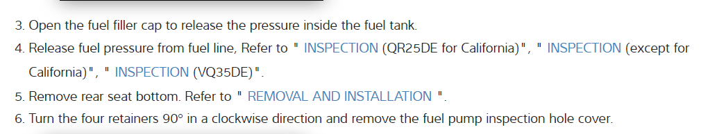

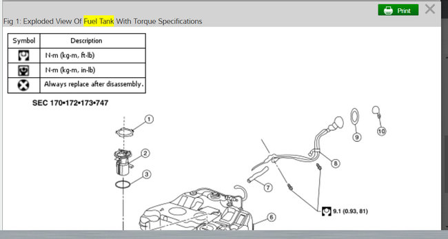

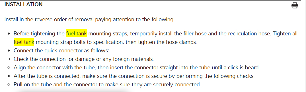

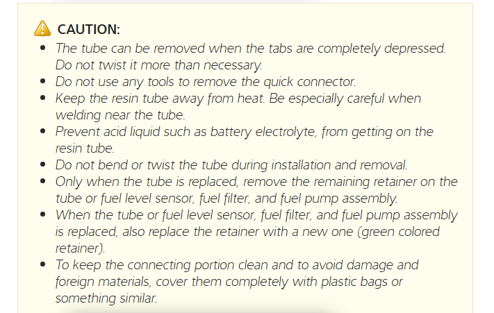

I put a gallon of old fuel in about a half a tank of good gas. It started but then stopped. Won’t start now. I added some Heet additives and it won’t turn over. Tried to symphony gas but it won’t come out.
May 11, 2019 at 9:22 AM
SCGRANTURISMO
  • 4,897 POSTS

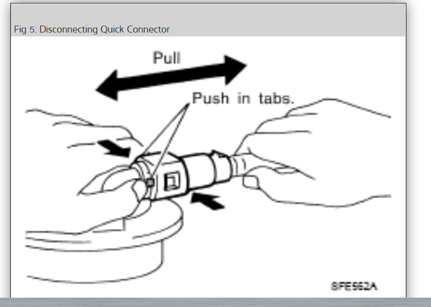

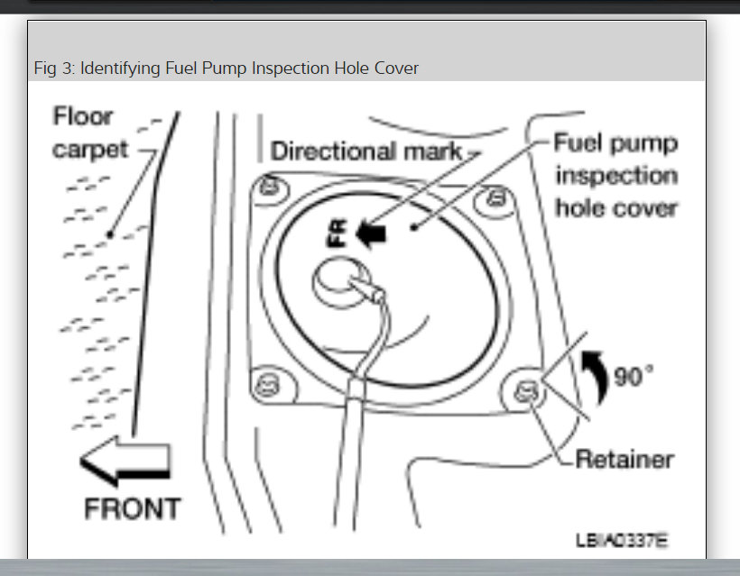

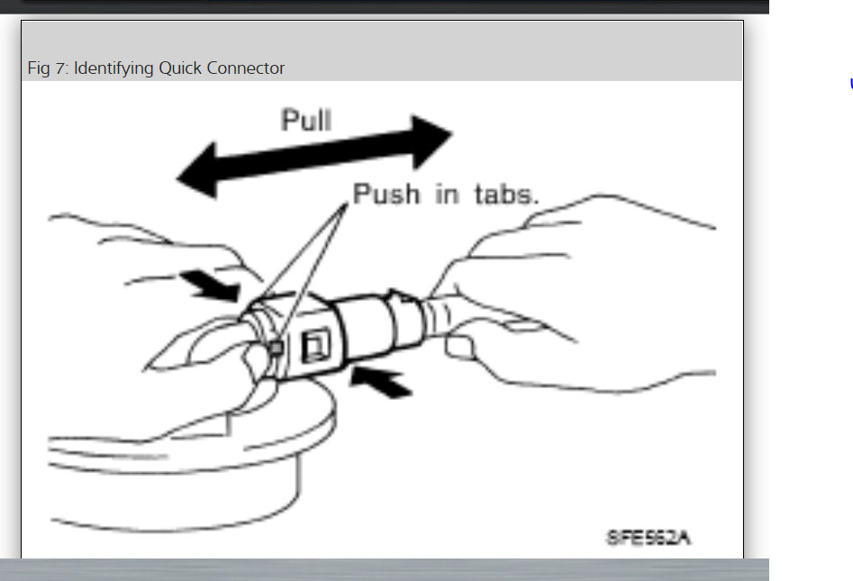

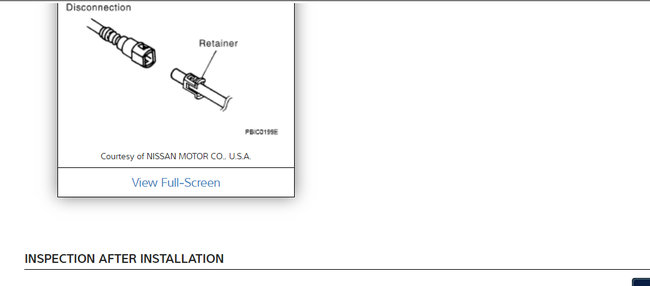

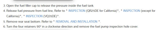

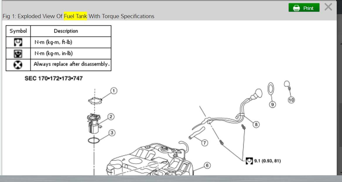

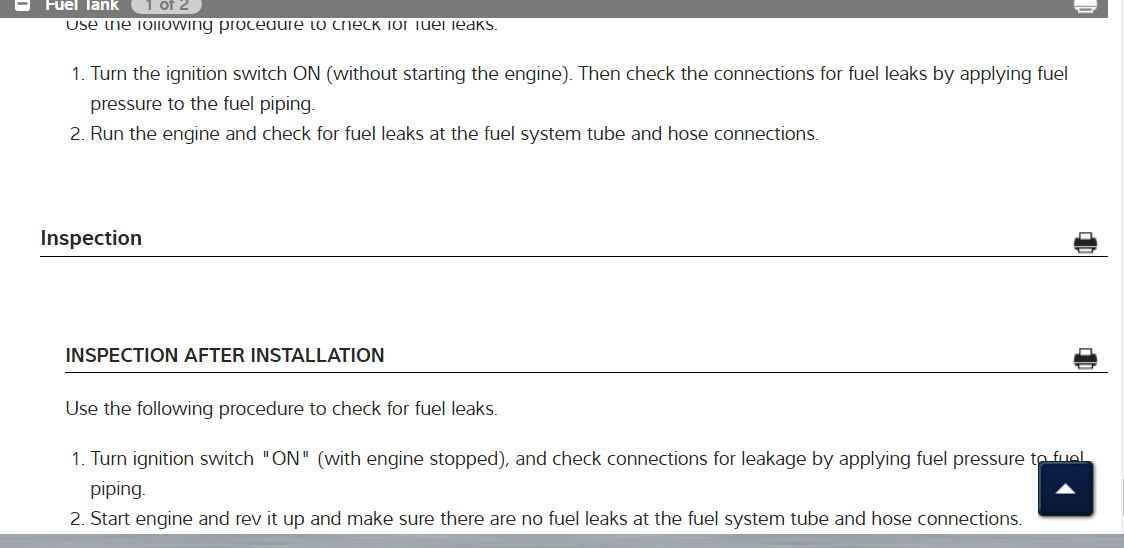

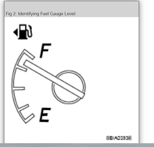

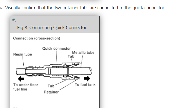

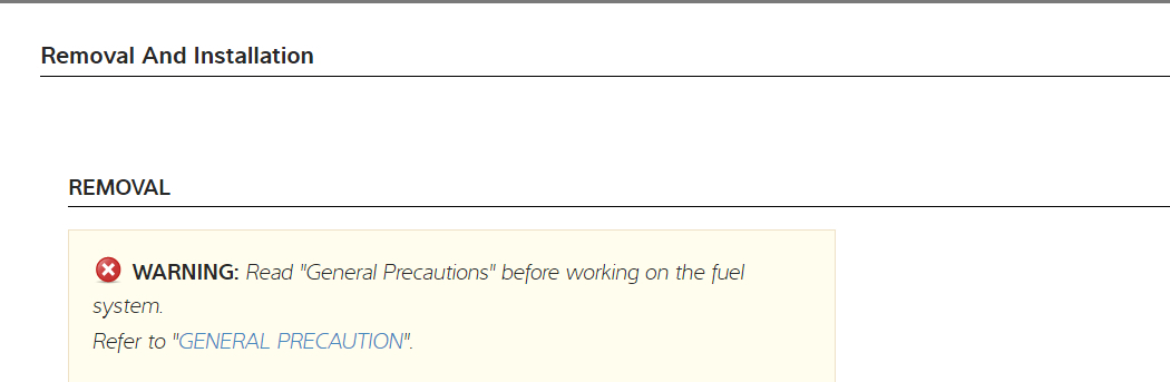

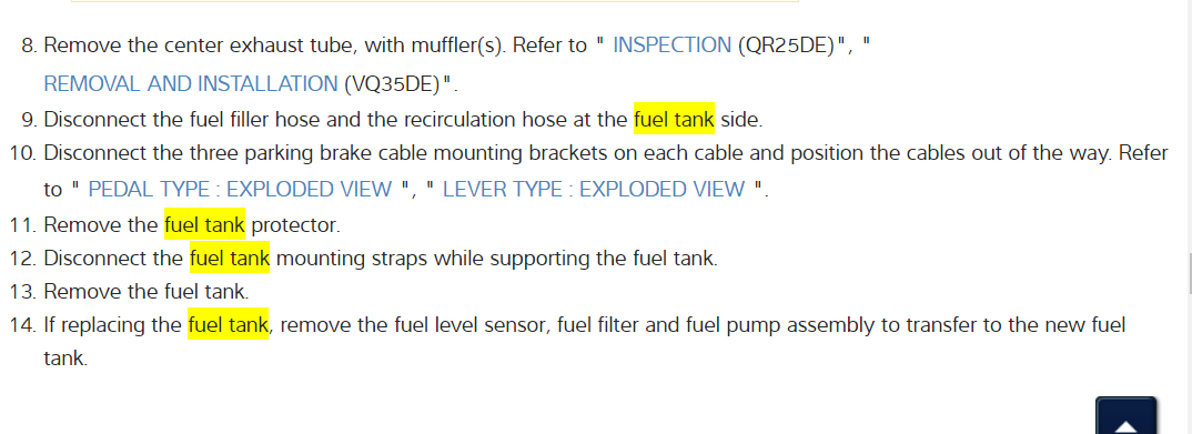

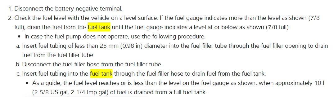

You are probably going to have to drop the fuel tank and drain it then reinstall it and put known good gas back in the tank. I have included for you in the diagrams down below the instructions for the removal and the installation of your vehicle's fuel tank. Please go through the guide and get back to us with how everything turns out.
Thanks,
Alex
