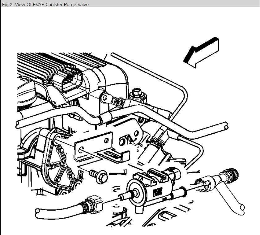

The MAF code is still there. I actually took my car up and got the codes read and wrote down. They are P0101, PO171, P0300 and PO496. Could it possibly be a purge valve? Since it ran that code could it be causing all the other issues?
May 3, 2018 at 7:16 AM
PATENTED_REPAIR_PRO
  • 1,853 POSTS
Well, the P0101 is a MAF sensor performance code, the P0300 is a random or multiple misfire code which could be caused by the MAF. The P0171 is a fuel trim system lean code which again could be caused by the MAF and/or a vacuum leak. A vacuum leak after the MAF could also cause a P0171 as well as the P0110, too. So check all the clamps, etc around the MAF and the duct work for a leak and make sure all the clamps are tight.
The P0496 does have to do with the EVAP flow during non-purge. That refers to a undesirable intake manifold vacuum to the EVAP system. This again could be due to a vacuum leak. So again rule out any and all possibilities of vacuum leaks, go around make sure all clamps are tight and no leaks. Once you find and fix any leaks, all of them codes should go away.
If you cannot find any leaks, you may want to try replacing the purge solenoid valve and see how many codes go away if not all of them go away.

Okay thank you! So check for any leaks, all the clamps and if it does not fix it try replacing the purge flow valve? Everyone is telling me it might be my catalytic converter and a purge valve probably is not the problem.

I do not think it is a catalytic converter issue. That would most likely have a code for it like a P0420 or even an O2 code. Checking for the leak first will not cost anything. Let me know if you do not find a leak. Rockauto has an AC/Delco purge valve for $20.00 just in case. https://www.rockauto.com/en/moreinfo.php?pk=926315&cc=1432073&jsn=446

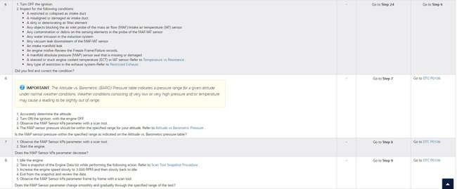

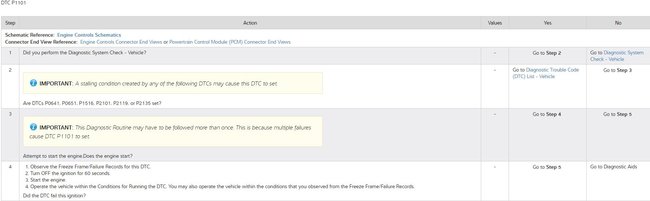

PATENTED_REPAIR_PRO
  • 1,853 POSTS

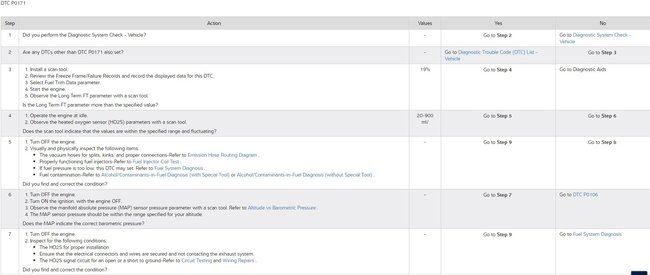

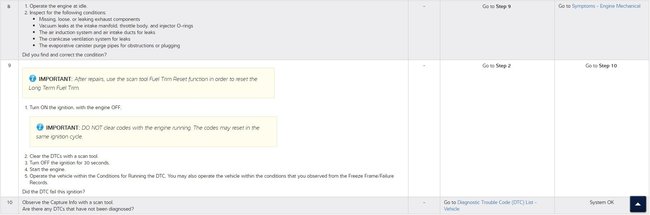

Here is the test for the P0171, which is about the closest to a catalytic converter problem but as you see, one of the first tests if checking for an intake air leak. Also, the test for the P0101 also is checking for an air intake leak.
