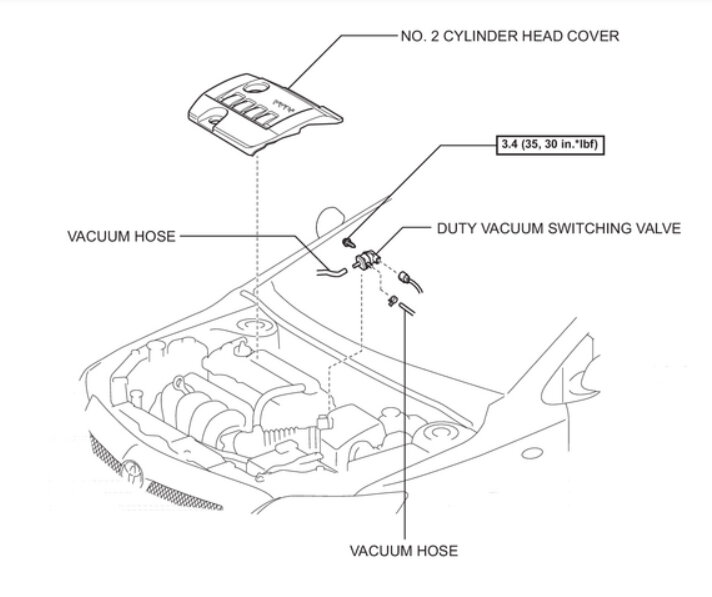

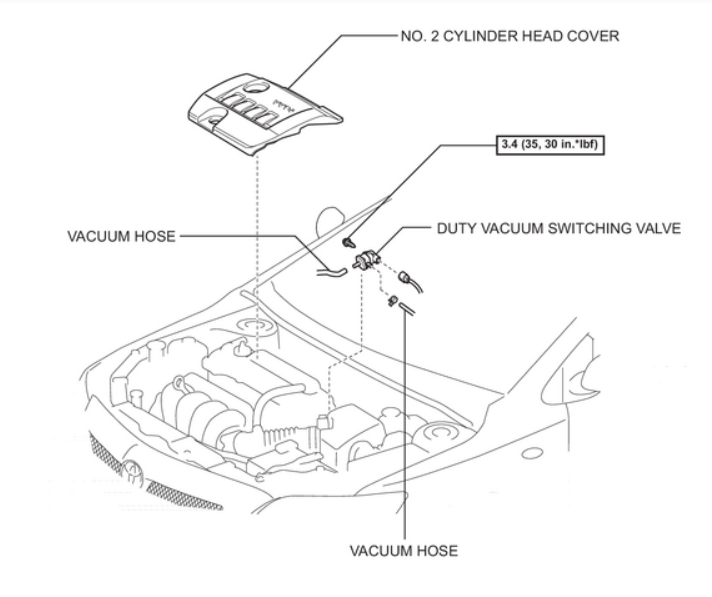

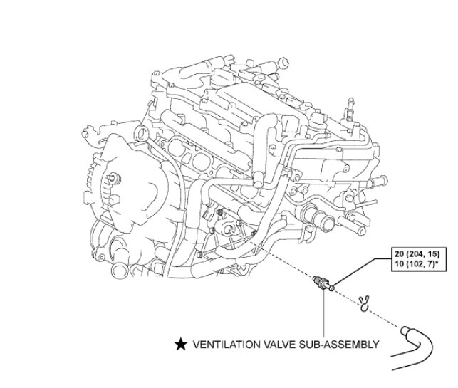

I have seen a stuck open EVAP purge valve cause this, also when the MAF is bad enough to clean, cleaning it will not help, you need to replace it. Also, I would check the PCV valve and the hose going to it.
P0607 - Control Module Performance
I would also drive it more to see if the check engine light comes back on and if you get this code you will need to replace the ECM. You should not be able to blow through the purge valve once it is off of the engine, here are the locations. Check out the images (below). Let us know how it goes.
