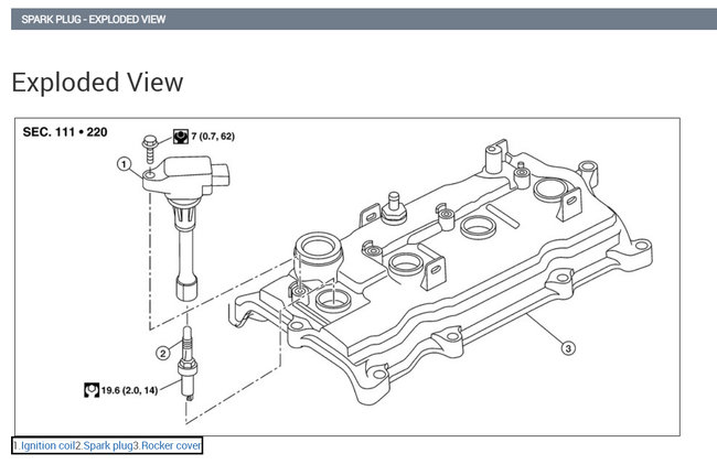

I put gas in my car on Tuesday and as soon as I left the gas station the car jerked and has been doing so since that night.
Jul 8, 2022 at 10:53 AM
  • 55,433 POSTS

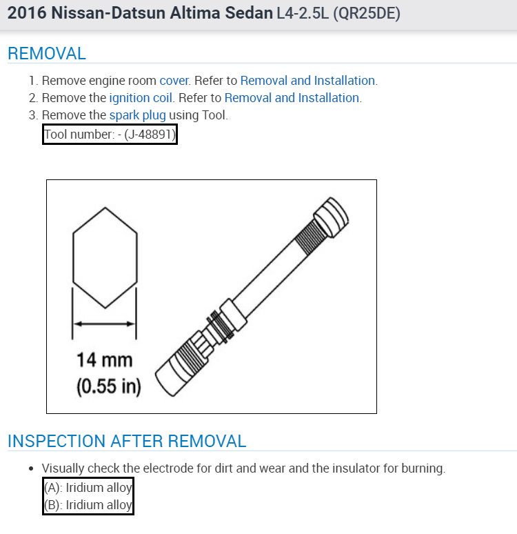

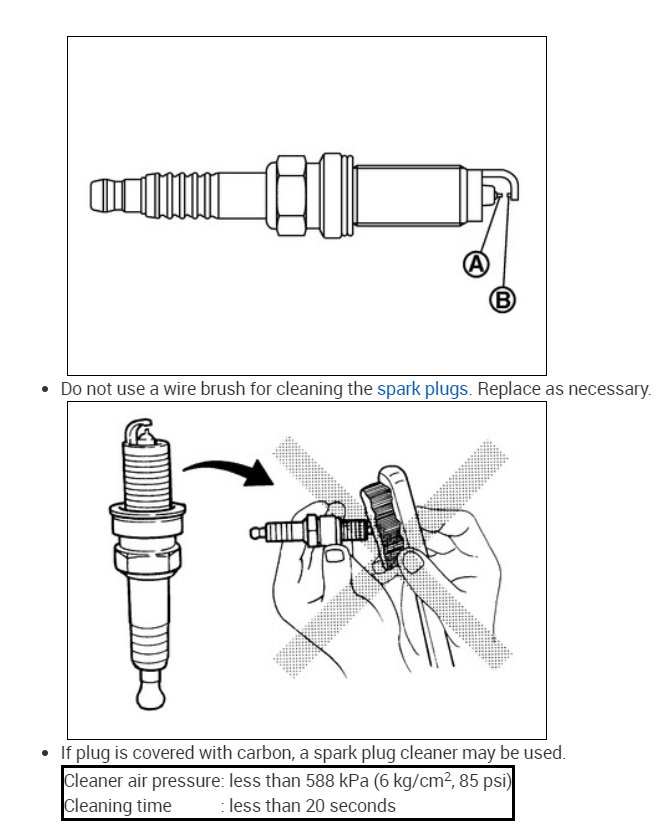

It sounds like the engine is misfiring, have you done a tune up yet? This is where I would start, here is a guide to help with instructions in the diagrams below to show you how on your car.
https://www.2carpros.com/articles/how-to-tune-up-a-car-engine
Also is there a check engine light on? If so, let's run the codes to see what comes up. here is a guide for that as well:
