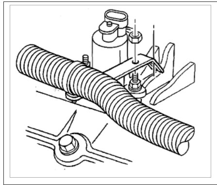

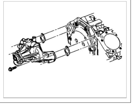

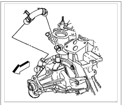

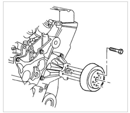

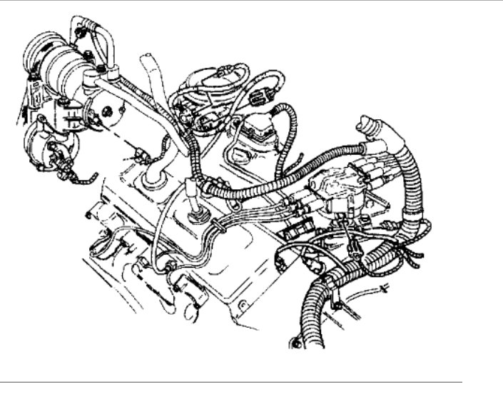

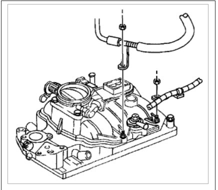

hey Ken my mom passed on so I had to go out of town but I finally got back we talked about my 99 astro van with 4.3 engine about a bad coolant leak you sent me some very good info but I had a chance to jack it up somewhat and I found the leak its on the right side of the engine if your facing the motor I see water running down from behind the power steering pump thank you sincerely Chris
Feb 16, 2018 at 10:03 AM

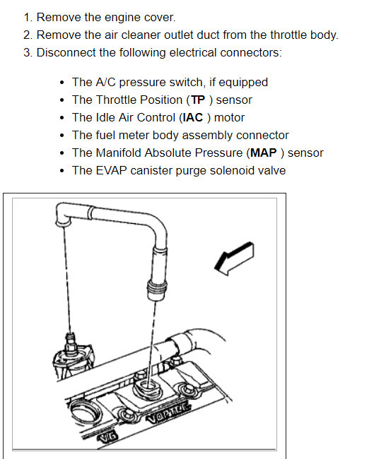

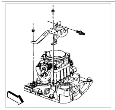

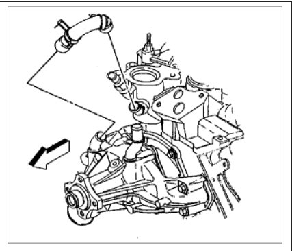

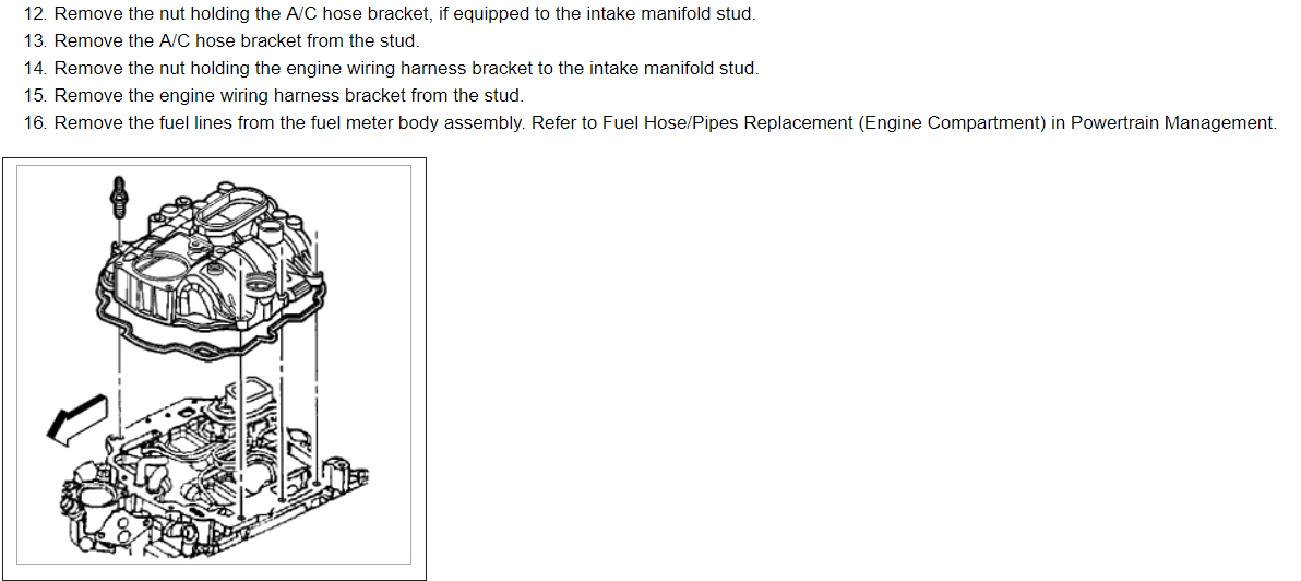

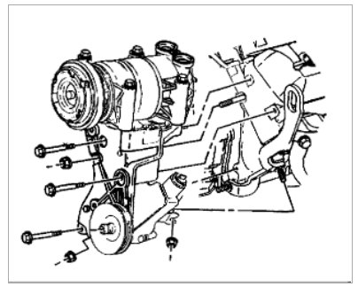

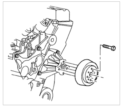

It sounds like either the intake manifold may be leaking or a head gasket. you may need to remove the pump and get a closer look.
Feb 16, 2018 at 10:05 PM
  • 55,399 POSTS
Sorry to hear about your mom, Roy has it right it sounds like the intake manifold gasket is leaking or you have a water pump that has gone out. You might need to take the engine a part a little to see exactly where it is coming from.
Here are diagrams and a couple guides to help you do the job.
https://www.2carpros.com/articles/water-pump-replacement
and
https://www.2carpros.com/articles/replace-intake-manifold-gasket
Here are what it will be like for your car (below)
