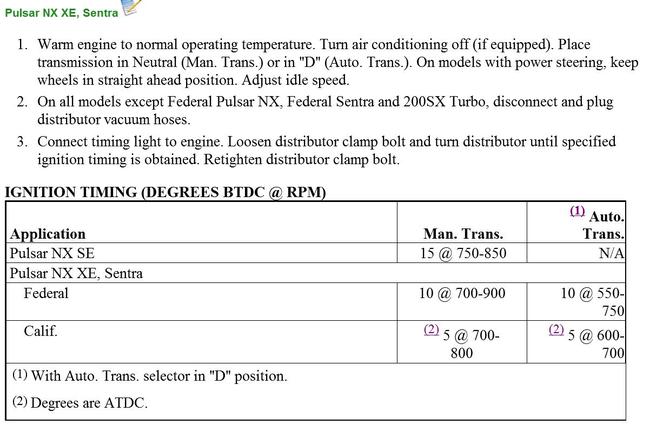

Thanks. This is federal emissions. I have seen 2 degrees after for this car also, Under hood sticker says 7 BTDC, so I tried it both places, but seems to run best at 7 BTDC. Still blistering my plugs. Checked for air or vacuum leaks-none. Vacuum gauge held steady at 17 inches hg. At idle, and my altitude is about 2500 ft. Above sea level, if that matters.
