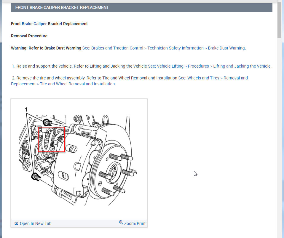

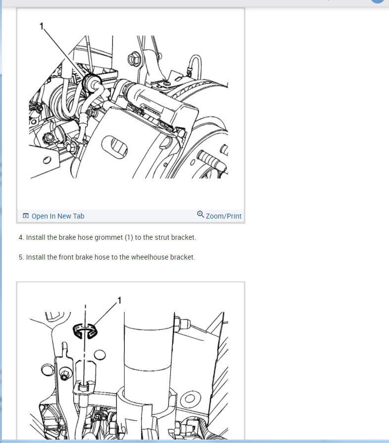

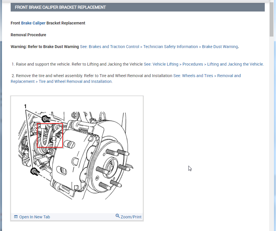

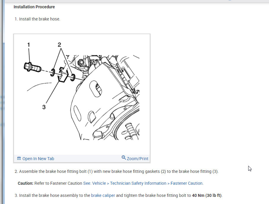

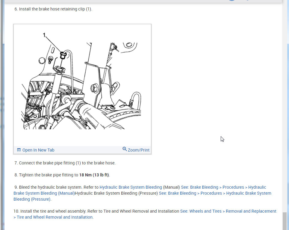

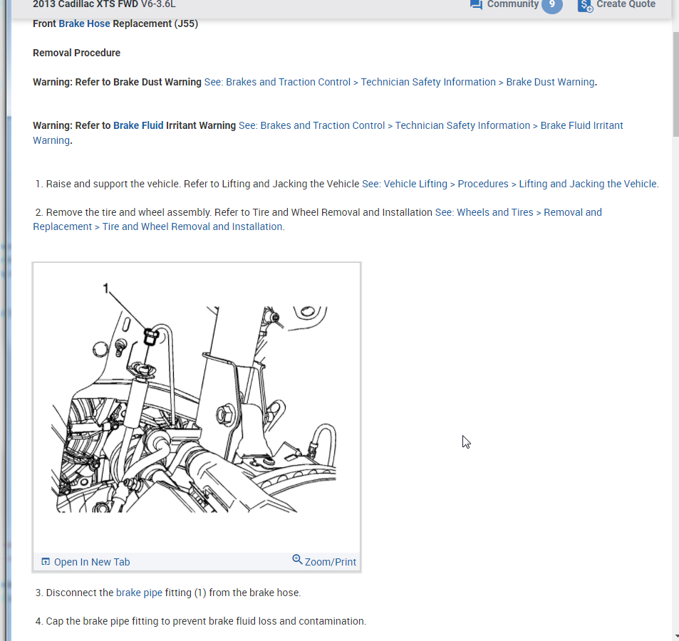

The easiest way to tell is to pump up the brake pedal and when the caliper does not release, open the bleeder screw. If fluid comes out and the wheel frees up, it is the brake hose that is the issue.
I attached the procedure for changing the hose. It is the same for both sides.
Front Brake Hose Replacement (J64)

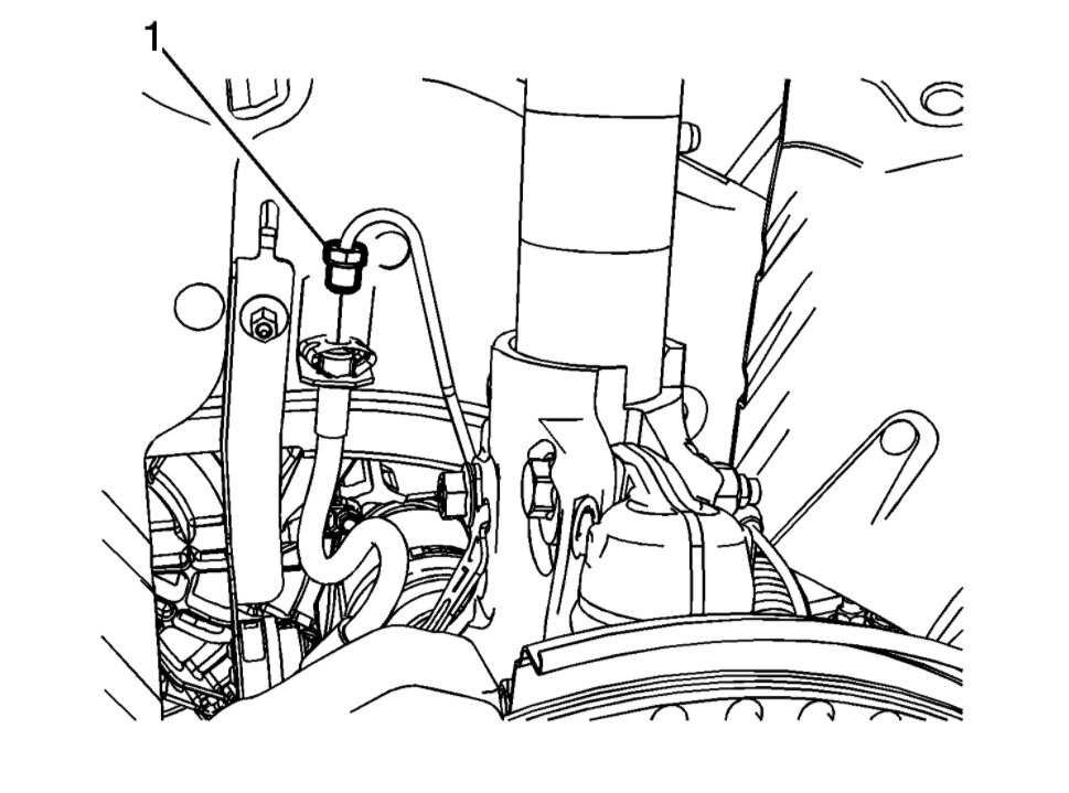

3. Disconnect the brake pipe fitting (1) from the brake hose.
4. Cap the brake pipe fitting to prevent brake fluid loss and contamination.

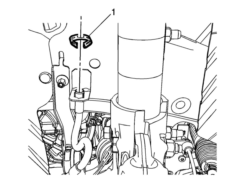

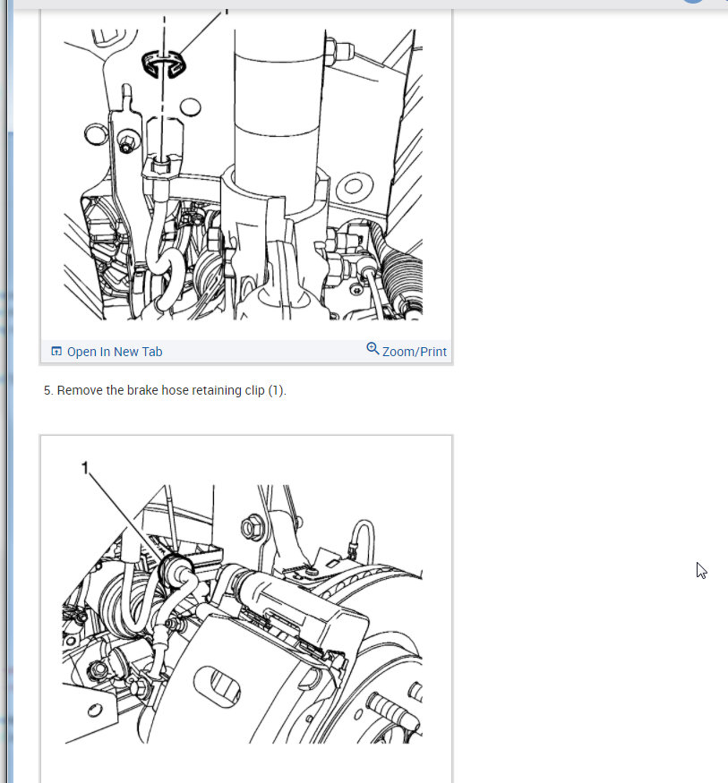

5. Remove the brake hose retaining clip (1).

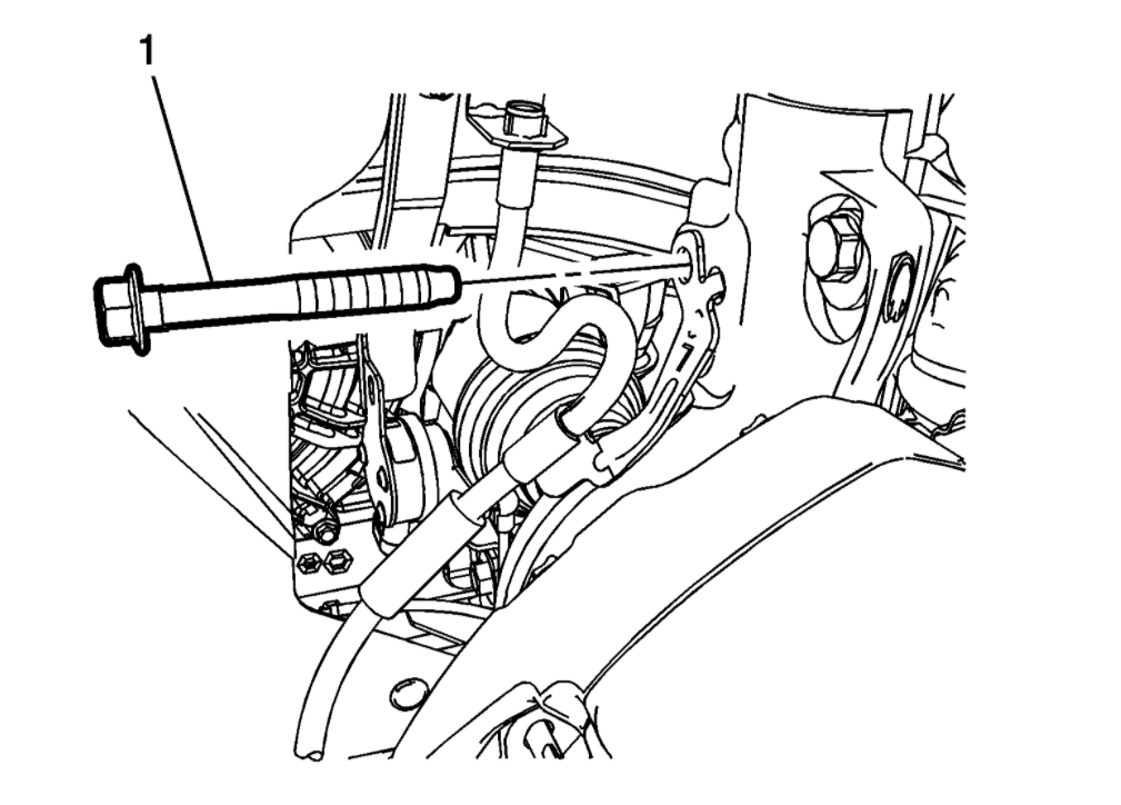

6. Remove the front strut assembly pinch bolt (1) from the steering knuckle and brake hose bracket.

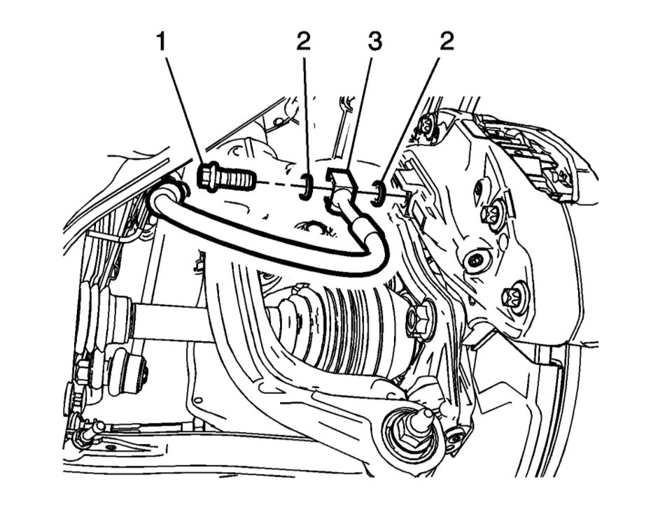

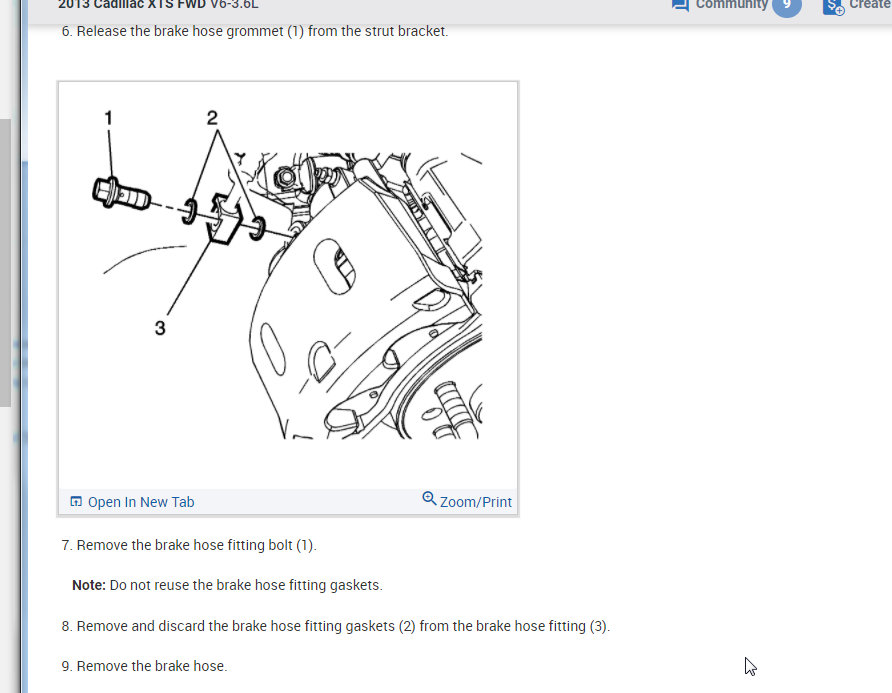

7. Remove the brake hose fitting bolt (1).
Note: Do not reuse the brake hose fitting gaskets.
8. Remove and discard the brake hose fitting gaskets (2) from the brake hose fitting (3).
9. Remove the brake hose.
