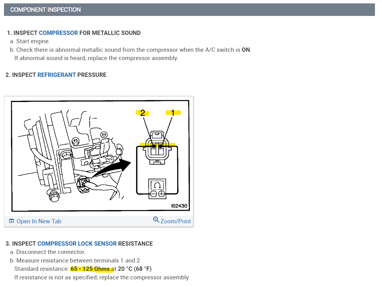

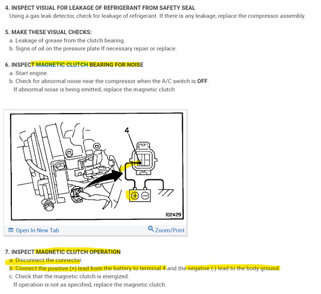

Okay it's possible the A/C clutch is going bad as well. But with the belt off check all the other pulleys first.

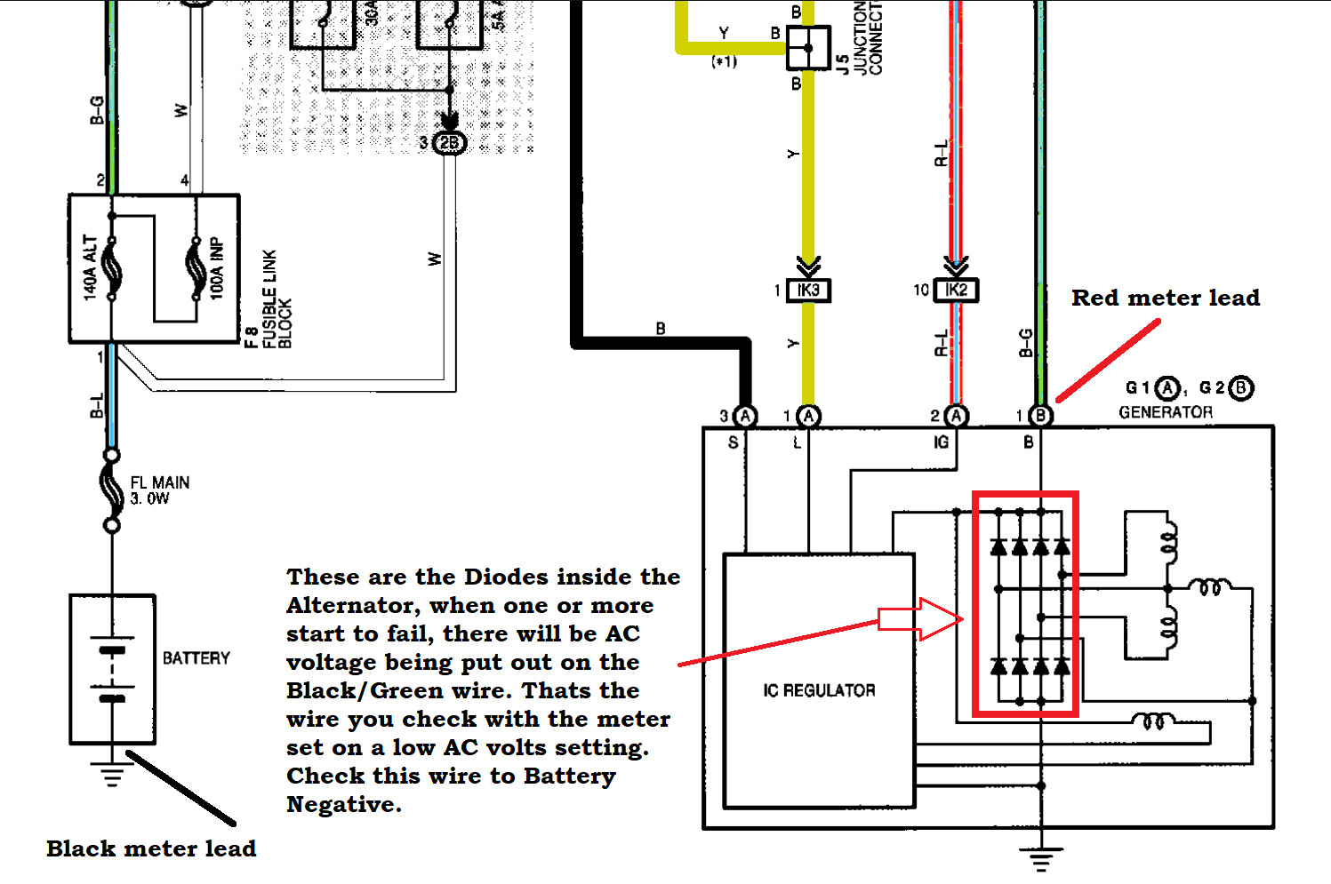

A couple tests you can do is see what the voltage reading is at the battery with all the lights on and A/C on high, as well as the rear defrost, that will put a large load on the Alternator and post what the highest voltage reading you get. It should stay between 13.5 to 14.2 roughly with that much load, another test is to see how low the battery gets while cranking the engine. You can disable the fuel pump or injectors for that test so you won't get any cylinder wash with fuel. The battery shouldn't drop below 8.5-9volts. If the battery drops too low here, it's either not charged up, or possibly has some shorted cells inside, that can happen if the battery hold down clamp is too tight and squishes the battery case.

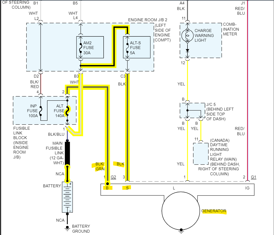

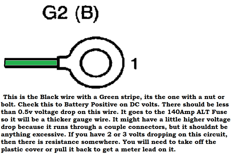

And since you found a nut that was loose you can also check from the Alternator S(positive post) to the Battery Positive post (voltage drop test) while you have the electrical system loaded and see if there is any voltage loss on that positive cable from the Alternator to the battery, ie bad connections or corroded wires. That should be less than .5volts roughly. You can do the voltage drop test on the negative side of the circuit as well, from the Alternator housing to Battery negative. With it fully loaded you will have some voltage drop, but still you don't want much. Below .5v

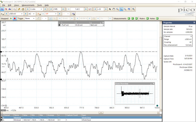

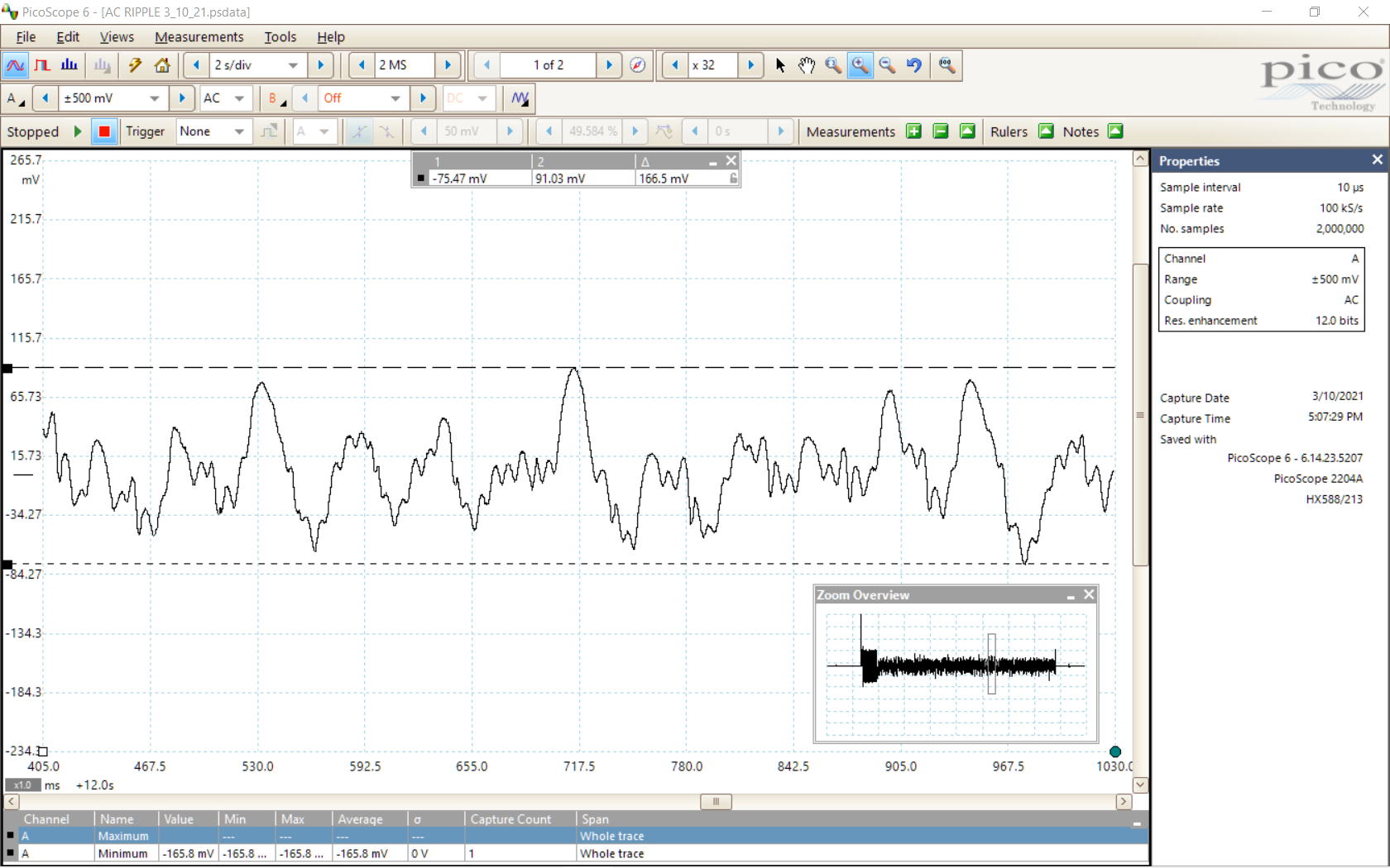

It wouldn't hurt to check the AC ripple as well, just set your meter on AC voltage on a low scale, below 1volt if you don't have an auto ranging meter. When it comes to AC voltage, you want less than 50mv (0.05v) There are a set of diodes inside the Alternator that rectify AC voltage to DC that the ECM can use. Once the diodes start to go bad AC ripple will increase, and banging on the Alternator is one thing that will cause them to be damaged.
Below is a scope waveform from my truck when I was testing, there you can see the swing into the negative voltage (-75.47mv) to (91.03mv) with a total of 166.5mv which is way too high. My Alternator was in bad shape, it has actually melted to positive post going to the battery. But in the waveform, you can see the diode, each hump, it's a terrible looking waveform, but this much AC voltage can damage the ECM.

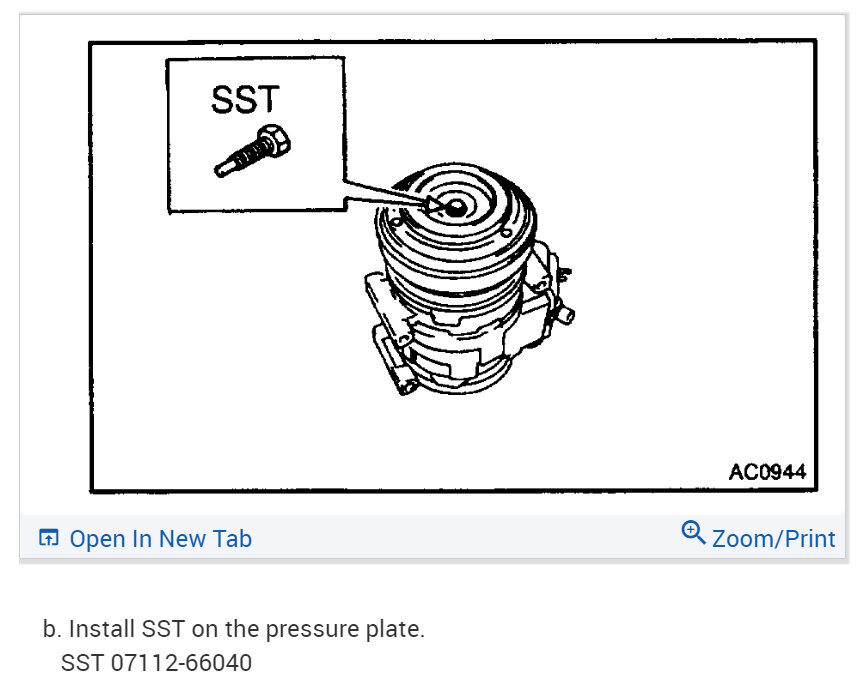

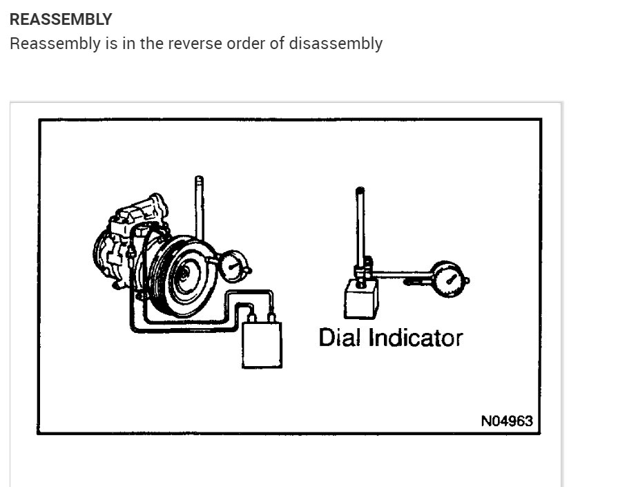

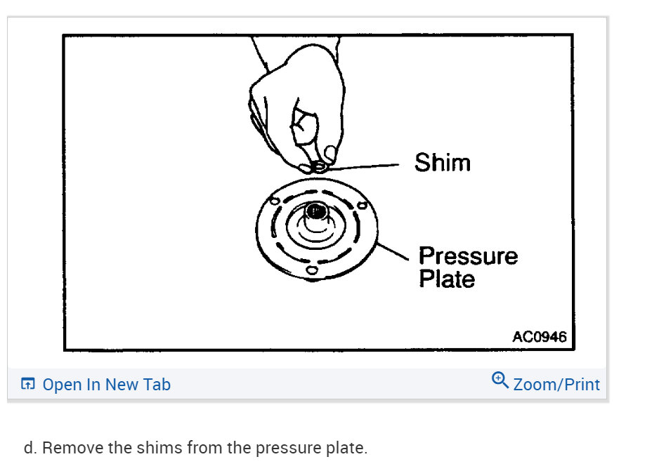

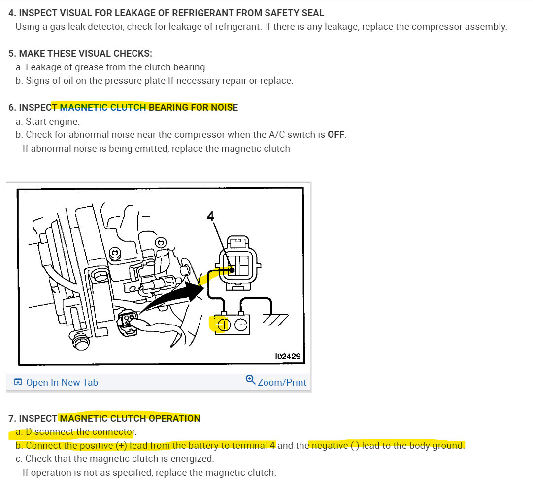

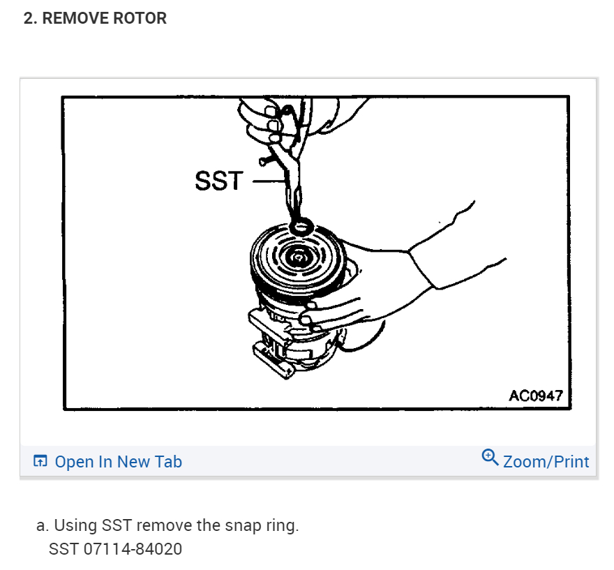

Your A/C compressor does have a clutch on it, it's a magnetic clutch. So, when it's energized the magnetic field pulls the clutch in. Thats how it cycles on and off. It should cycle about every 8 seconds or so, that's a general range, it can be different depending on wear, the amount of refrigerant, pressure sensors, temperature sensors, etc.

Okay, did you check the voltage drop when cranking the engine over at first start up when the battery had some charge? Also, the AC voltage check? A bad battery or issue with the main positive cable from the Alternator to the battery can cause strange charging issues as well.
Let the van run for a bit to charge up the battery and then do these tests.
First put the meter on the battery and see what the voltage drops to while cranking.
Next test,
With the van running, check from the Alternator post to the positive battery post set on DC volts and see what the voltage drop is on that cable.
Then set your meter on AC volts, and check from the Alternator post to the battery negative and see how much AC ripple the Alternator is putting out with the van running.

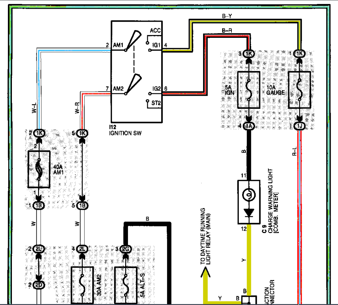

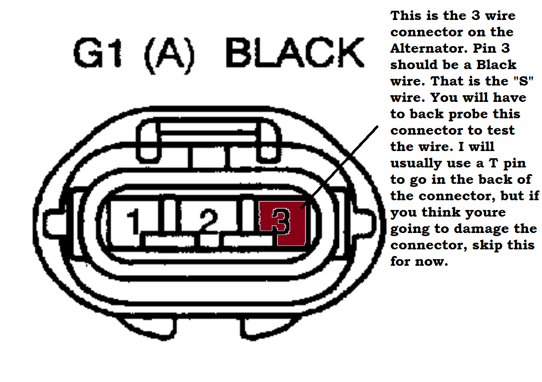

Yes, you're looking for the main power wire on the Alternator that runs to the Battery positive. The first diagram is an aftermarket diagram, and it looks to be somewhat incorrect on their labelling of the Alternator 3 wire connector. So, the second (bottom) and third (top) diagrams are the OEM and go together. The fourth is the main charging wire to the Battery. The fifth is the 3-wire connector.

So far, I got a voltage drop of 1.45 volts with engine Off 0.140 with engine on can't check amps I need to get a amp clamp. One thing for sure, with no load it charges between 13-14 as soon as I turn on the headlights it stops charging and starts dropping fast. By the way the 140-amp fusible link shows continuity and no issues.

Okay, so it's not isolated to just the A/C compressor. 140mv is not bad. Were you able to do the A/C voltage test? And how low does it drop to with the headlamps on? This isn't with the new Alternator on, correct? This is the original one.

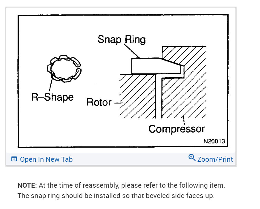

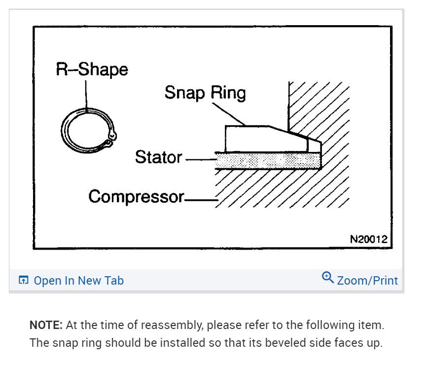

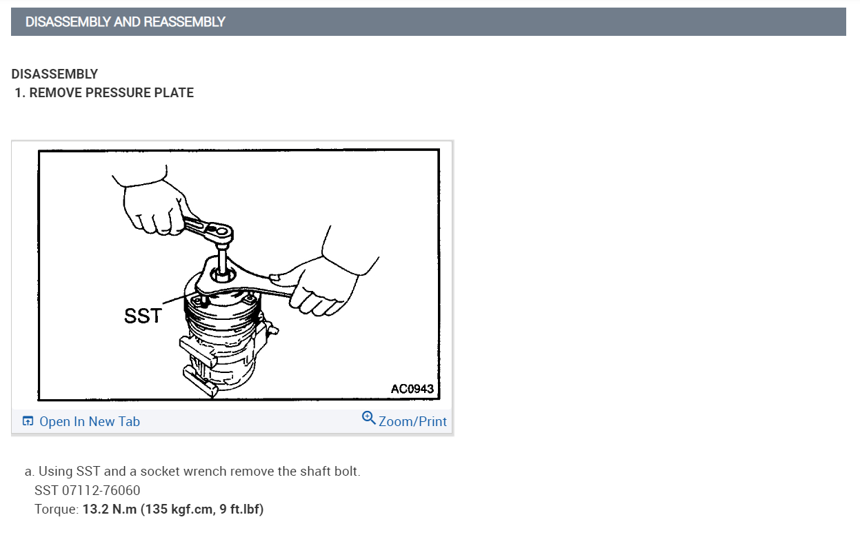

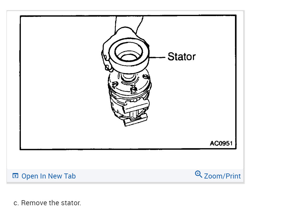

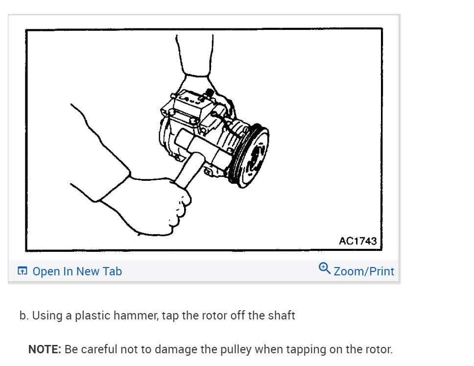

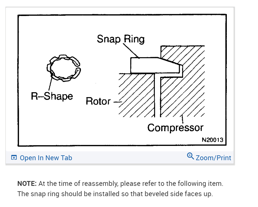

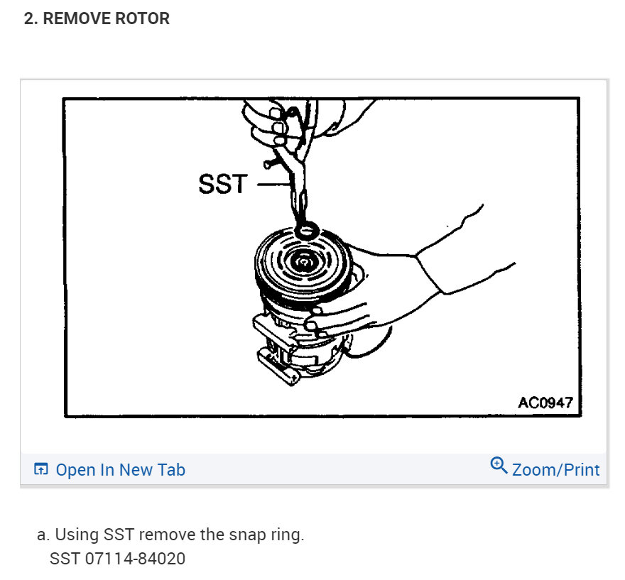

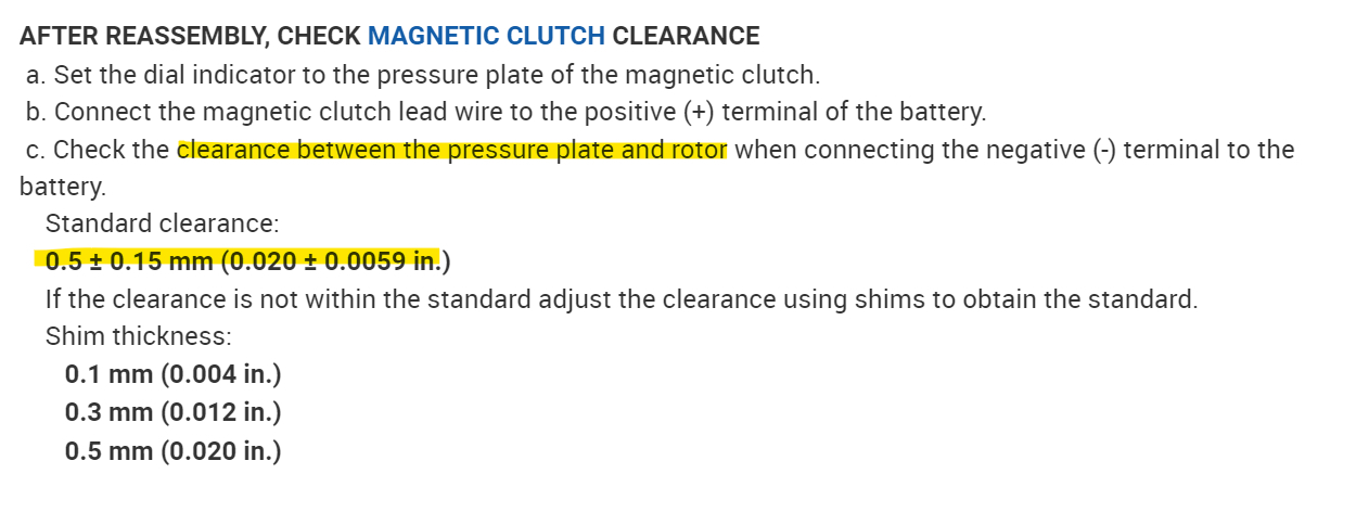

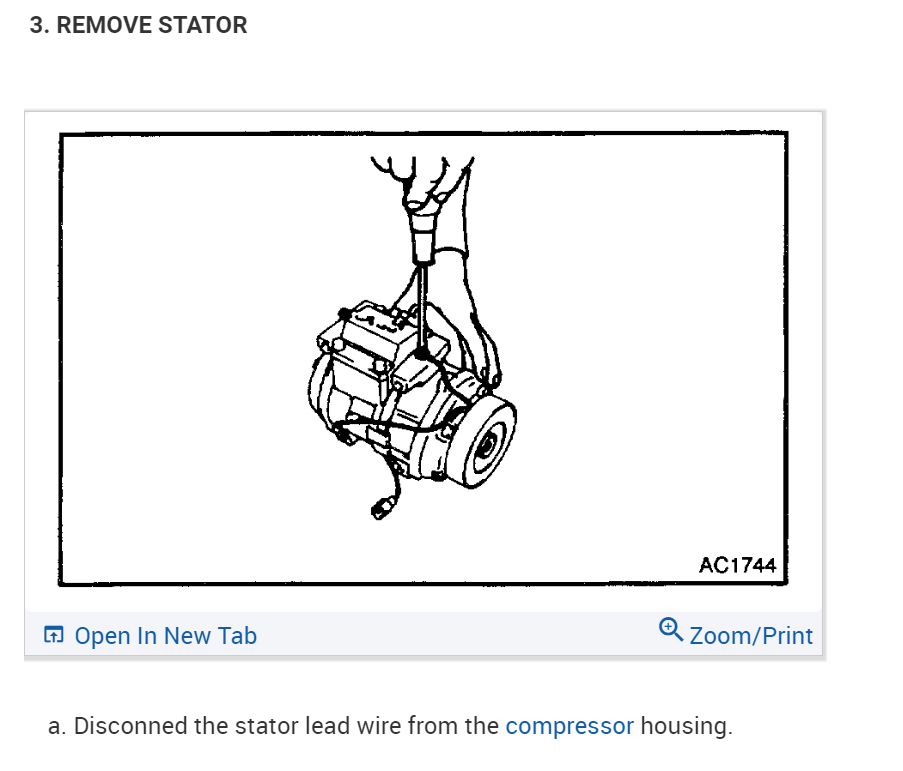

Hello, I haven't gotten around to changing the alternator yet, I took the belt off looks like it did when I put it on, as for the pulleys, the alternator spins freely, the compressor spins freely the clutch does not it moves by hand not frozen, so I guess that's normal and the balancer pulley as expected doesn't move by hand, as I know it takes a lot of force to move that one. So I'm thinking I will give the old alternator one last shot, put the belt back on, try to find that sweet spot tighten it and see if it works if not, I will replace it, will let you know the results.
