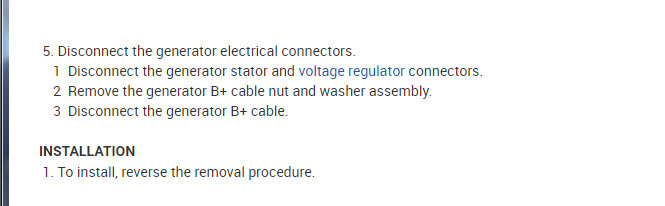

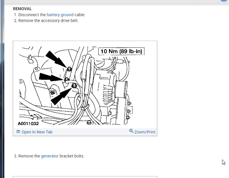

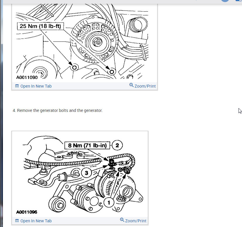

It is hard to know for sure how far a battery will last if the alternator has failed. Clearly it is not something you want to test but in a jam I would definitely put a charger on it for as long as you can and then turn as much off as possible while you are driving. Clearly the head lamps are a large draw on the battery so if you can wait until day time, that would help.
Here is a guide on how to replace the alternator:
https://www.2carpros.com/articles/how-to-replace-an-alternator
Also, I attached the process from the manual on how to replace it. Let us know what questions you have. Thanks
