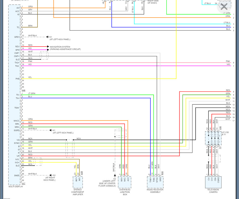

I had my backup cam working but I can't remember how I did it. I had to remove a faulty fuse box.
Now I am trying to rewire it to a phoenix px6 tablet screen.
need help finding the correct wires.
Thanks
Mar 2, 2022 at 12:47 AM

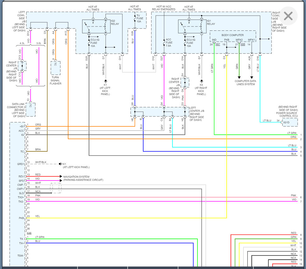

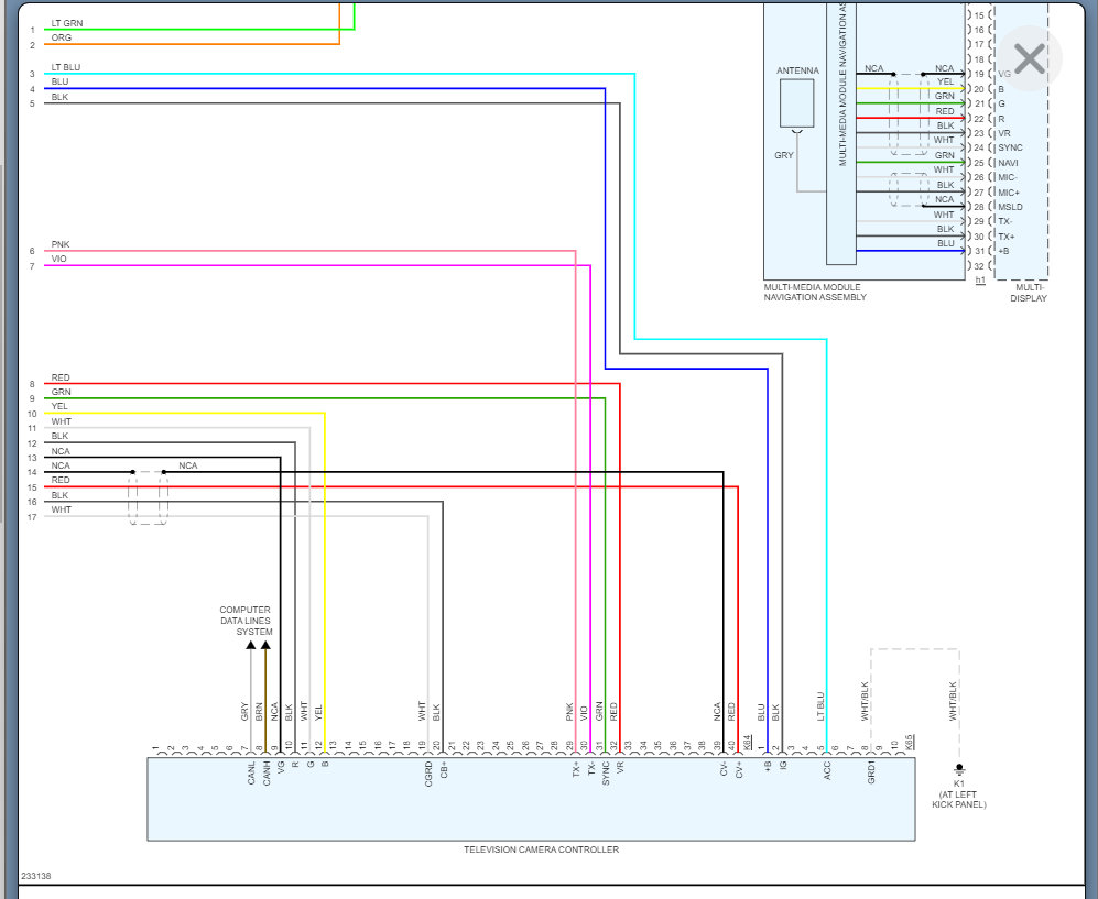

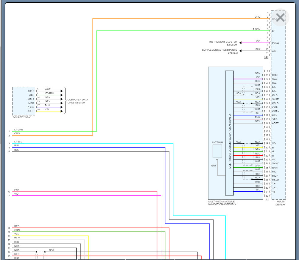

Sure. I provided the wiring diagram below for the entire navigation system as this is part of this system.
Here are a couple of guides that will help with this in case you need it:
Please see the attached info below and let us know if you need more info.
Thanks
