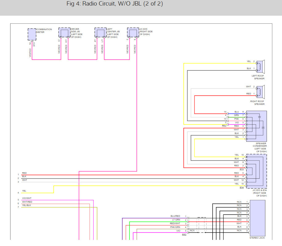

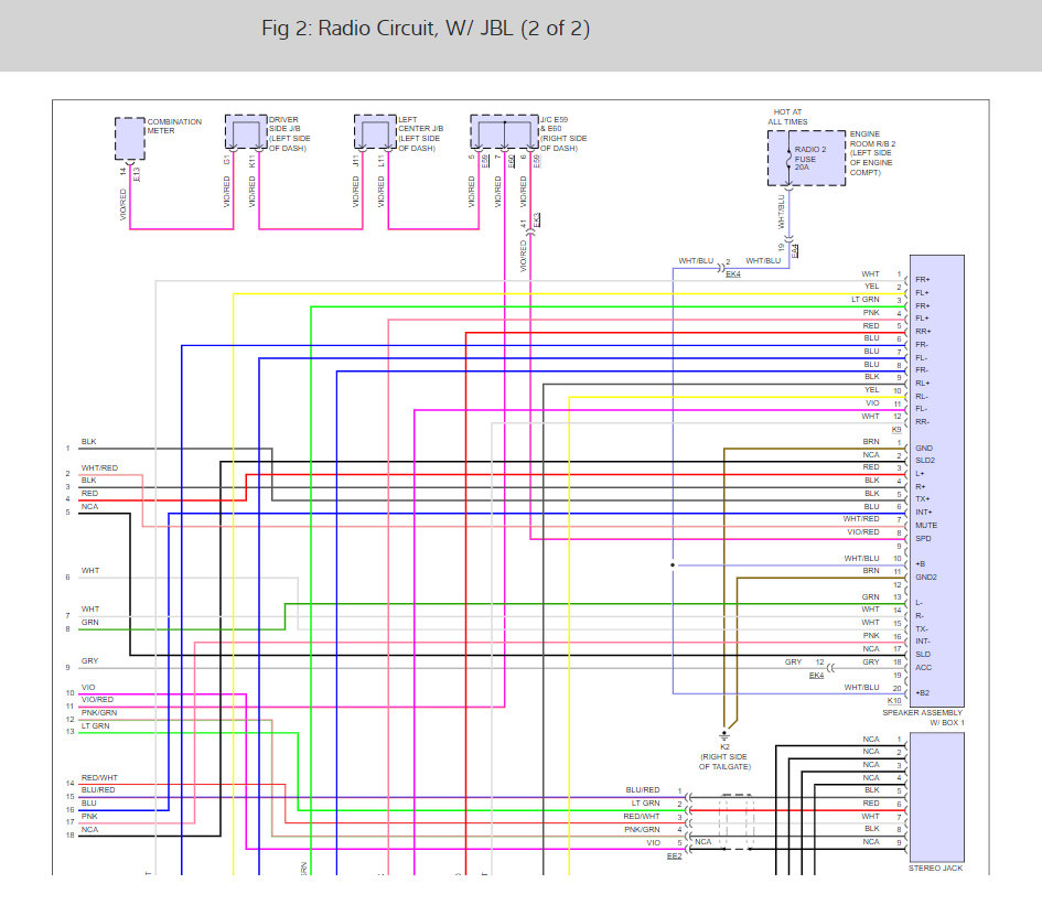

So I bought the Pioneer MVH- 4400NEX and I wanted to wire the factory backup camera to the aftermarket stereo. I cut three wires from the side panel where the airbag is and crimped them together. I then connected the RCA cable to the radio. When I put the car in reverse the radio changes to a black screen so it registers that the car is in reverse but the backup camera video does not show. It’s just a black screen. I did this on a 2014 FJ Cruiser.

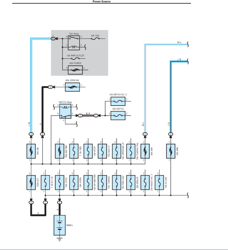

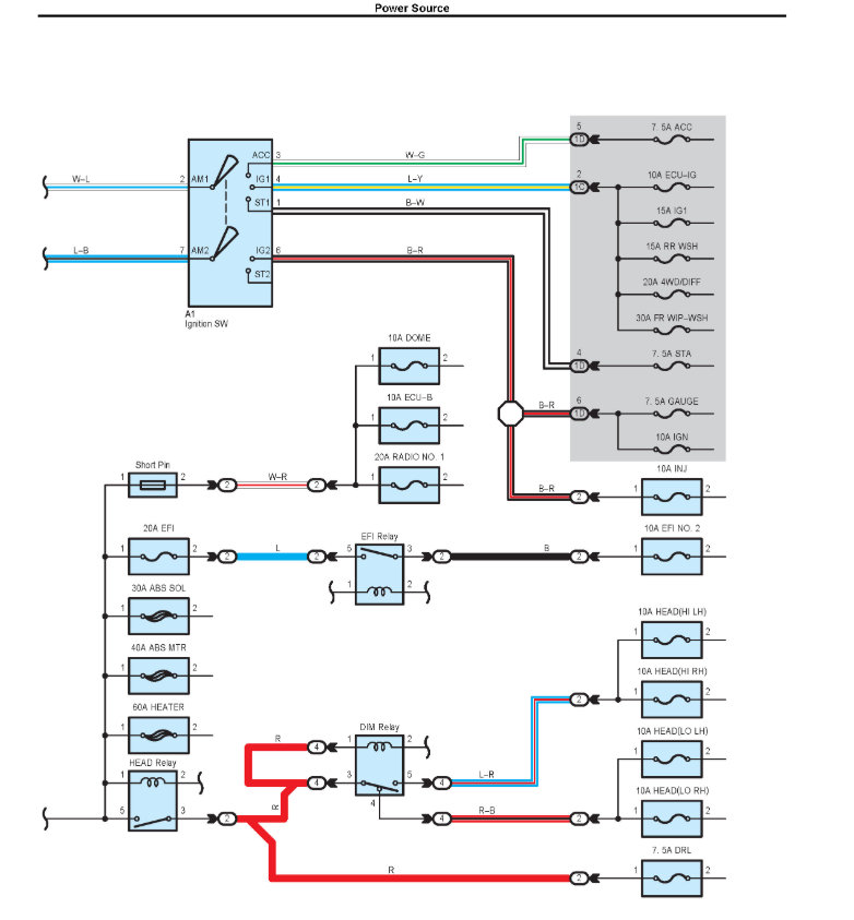

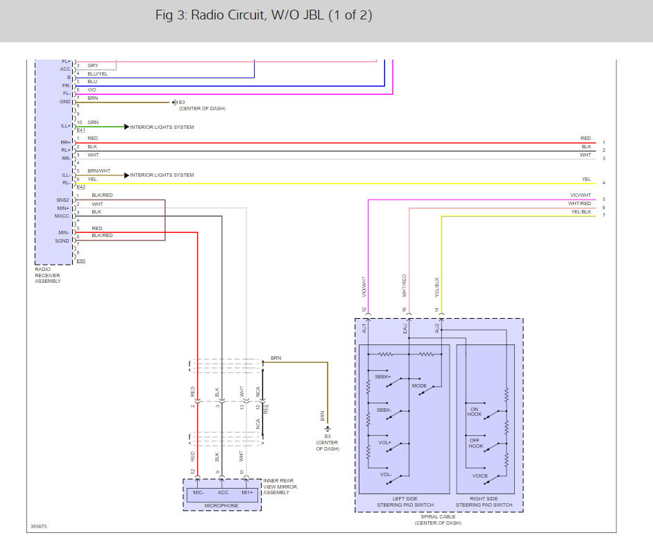

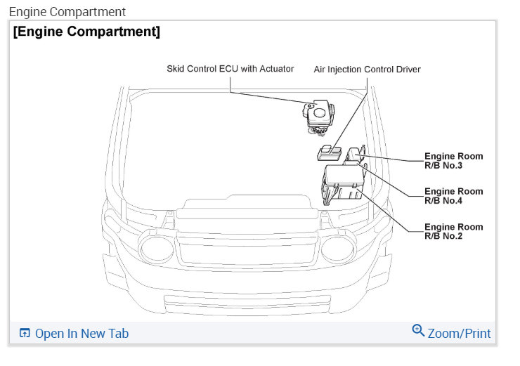

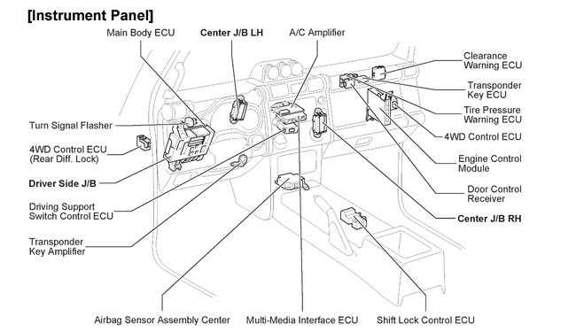

Can you check for power at the IG1 fuse at the drivers side fuse panel. Here is a guide to help and the backup camera wiring diagrams so you can see how the system works and the fuse location:

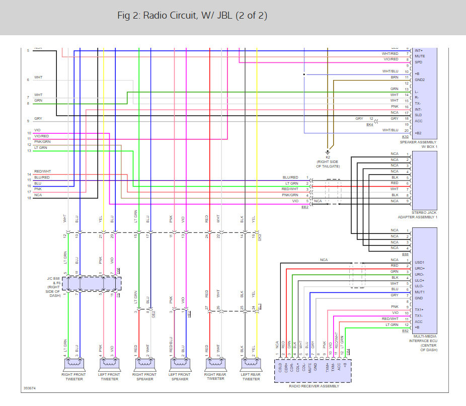

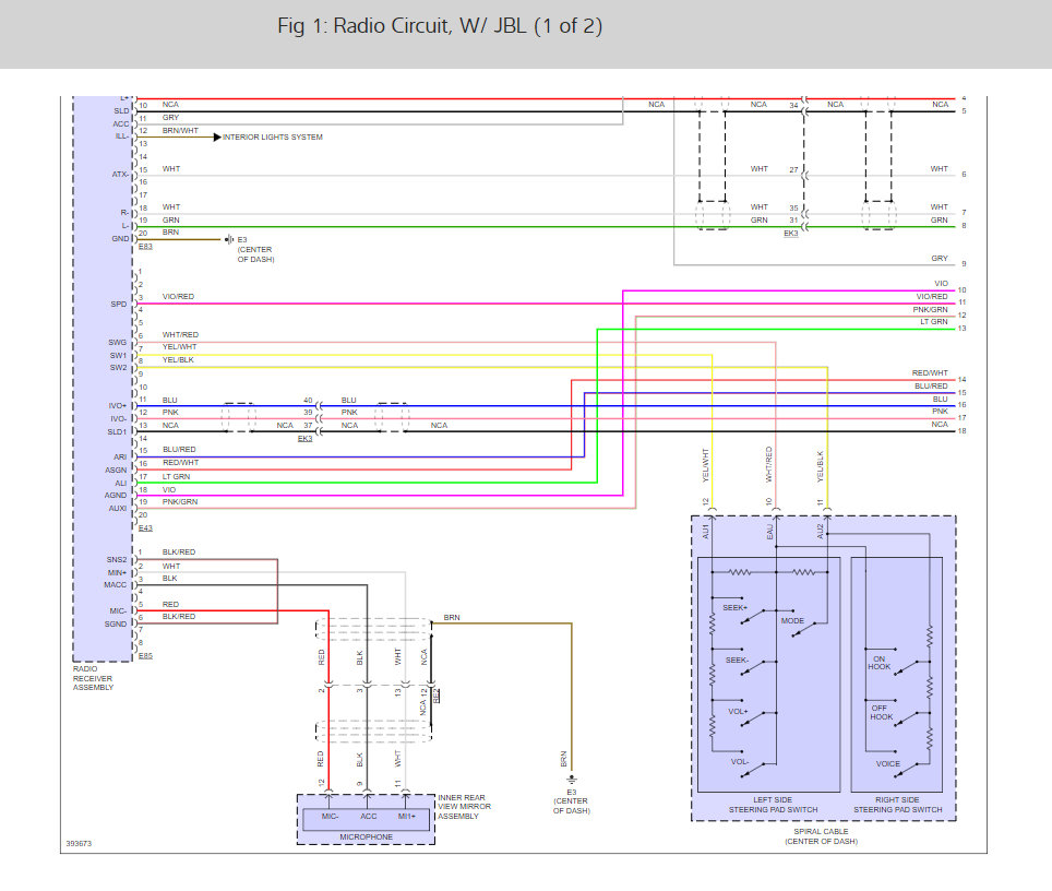

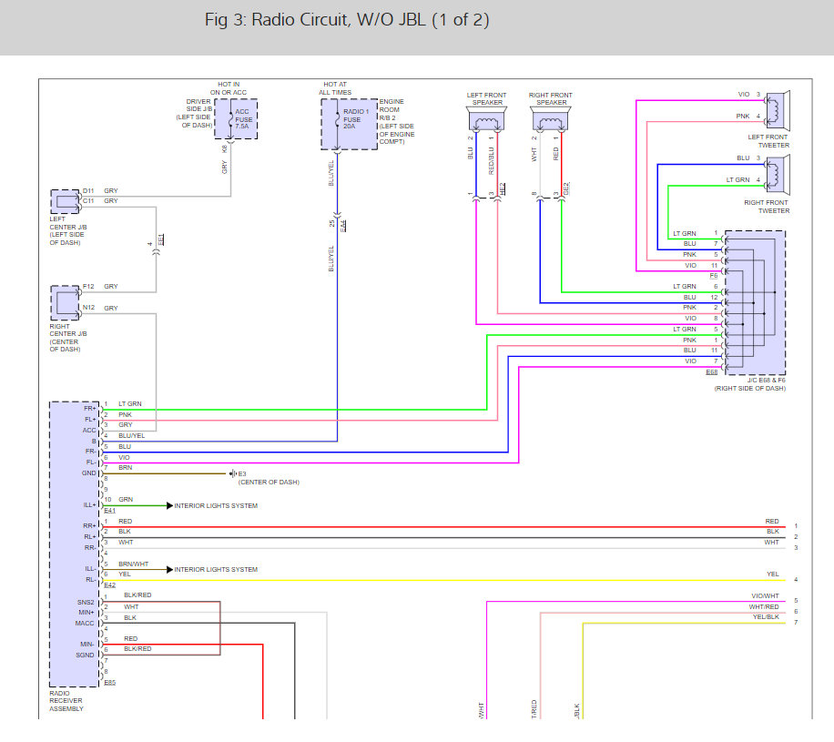

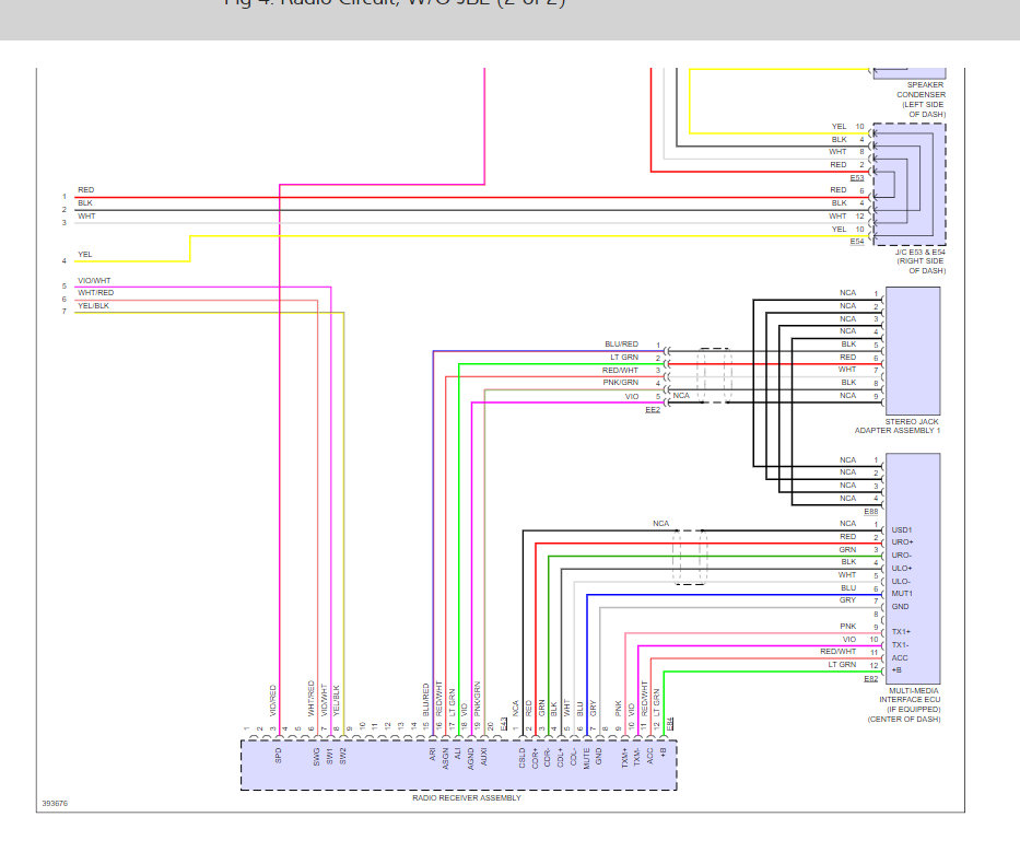

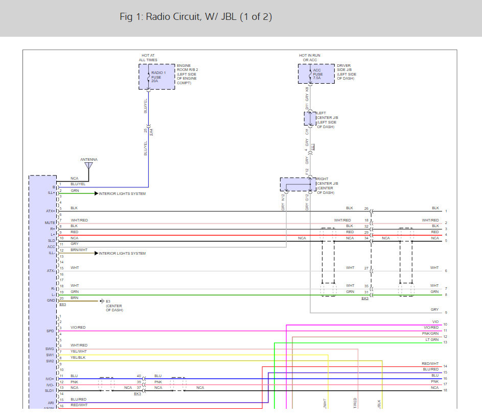

That's a good sign it means the camera is working. Did the previous radio have the capability of the rear camera or is this a new feature you are installing? Here are the radio wiring diagrams and a guide to help make sure you have the wiring done correctly:
Check out the diagrams (below). Please let us know what you find.

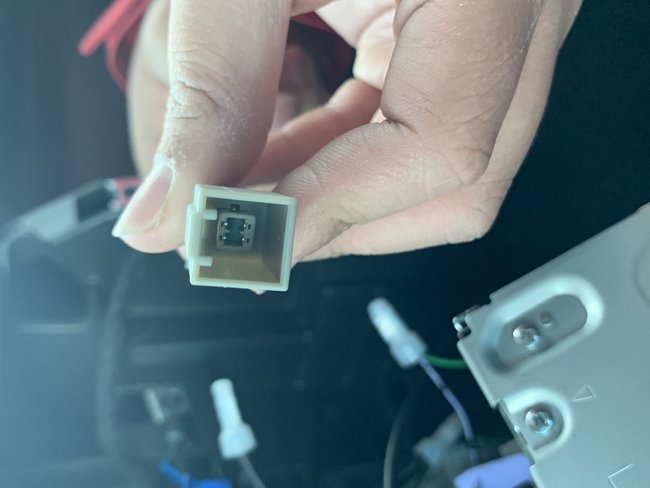

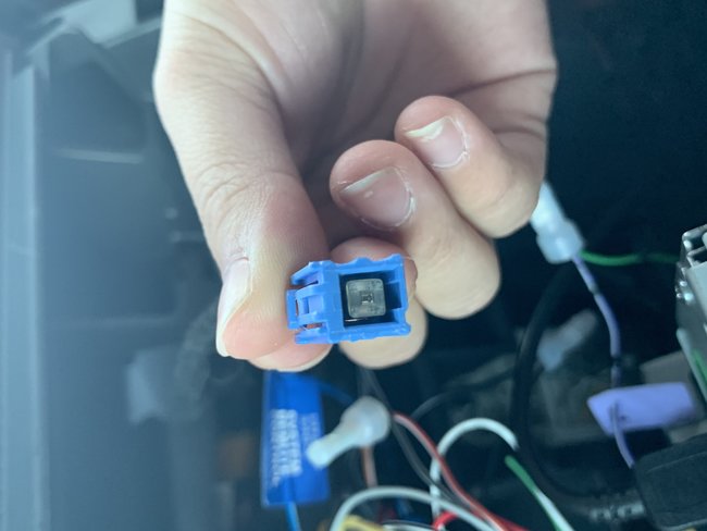

And does anyone know how to retain the factory USB port after installing the new aftermarket radio? I did buy a PAC USB-TY1 Toyota/Lexus OEM USB port Retentions cable and it doesn’t fit. Any ideas how to retain it?

Can you upload images of the connections in question?

The blue is the factory plug and the other picture is the aftermarket harness I bought that doesn’t fit.
Apr 1, 2019 at 11:22 AM

This the the aftermarket harness I bought to retain the factory’s USB port.

It looks like you got the wrong harness. do they offer an updated connector?
